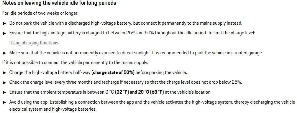

just had porsche assistance/aa power may taycan up from dead in the garage after just 4 days idle. it was plugged into the my home evse, but still the 12v battery died. not sure how to keep this thing alive. think i’ll start leaving the frunk open so i can at least easily reactivate the 12v battery.
I think you need to use a trickle charger designed for lithium batteries. CTEK makes one. The HV battery will recharge the 12 volt only a certain number of times, I think 6 times, and the HV battery must be at or above 50% SOC throughout. It sounds like there may be a problem with your 12 volt. My MY 21 4S regularly goes for 10 days/2 weeks without a problem, but I keep the HV above 50% SOC.

No AGM is a lead-acid chemistry. Absorbed Glass Matt. Leak free basically.
You need a lithium specific charger for medium to long term maintenance charging…
Like this CTEK below. Porsche also do a branded version which does both lead-acid and Lithium batteries.
After reading other posts also other users experience on reddit, I came to conclusion that a trickle charger can mess up the 12V monitoring of the Taycan.
for example: https://static.nhtsa.gov/odi/tsbs/2023/MC-10233963-0001.pdf
the 12V battery is supposed to be charged at every power-on cycle of the car and keeping the charge between 13.4 and 14.5. if this doesn't happen it need to be fixed by the Dealer with a correct diagnosis.
ALSO don't mess too much with those 2 finger manual reset, because it could be the car is doing some OTA of some car unit and you may brick or causing malfunctions. just power it off, leave it close, log off from the app. all the units will reset themself after 15-60min.
Porsche as far as I know is very bad on communicating those updates, but they happen more frequently then we think.
