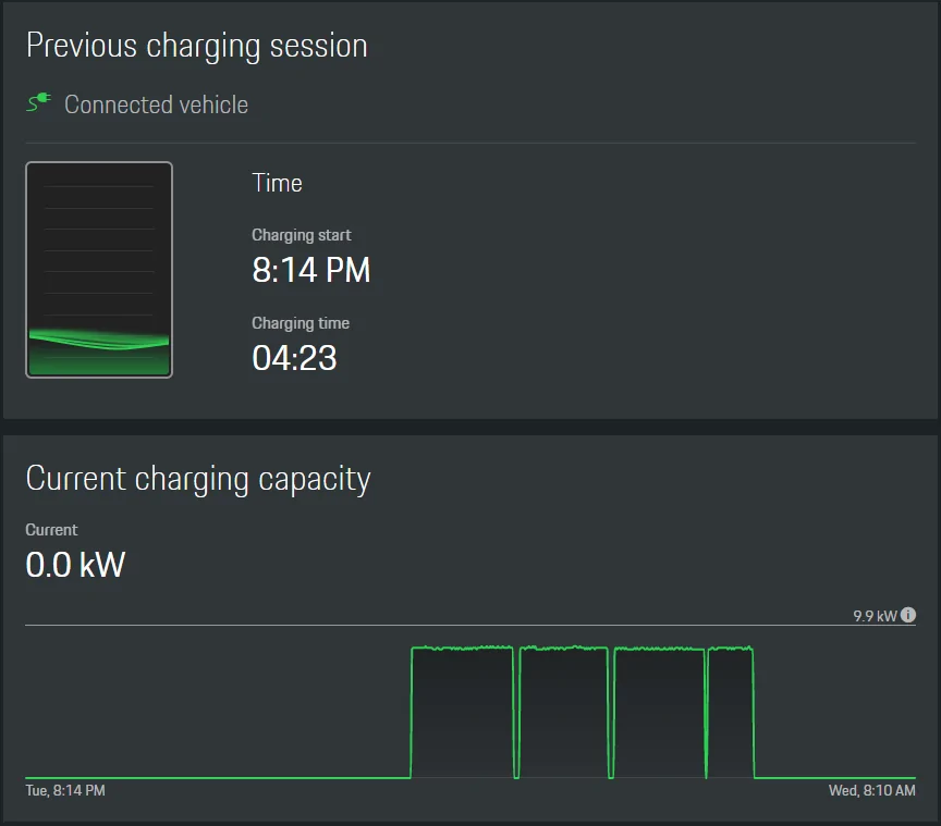

Finally charged my MY20 last night. I have a time-of-use rate plan so cheapest electricity from 9pm to 6am. I have a 40A 240V charger connection and PMCC set for 32A charging current - plenty to recharge in that 9 hour window. I have only the general charging profile, it is not enabled (not active). I have a timer set for 6am M-F and 8am Sat-Sun with target charge 85%.
Plugged in at 8:14 pm, car determined it needed to start at 1:25am and car and PMCC obediently waited until 1:25am. Car hit 85% target right on schedule at 5:59am and stopped charging at 6. As of 8:17 I have not unplugged the car and it is not charging past 85%.
