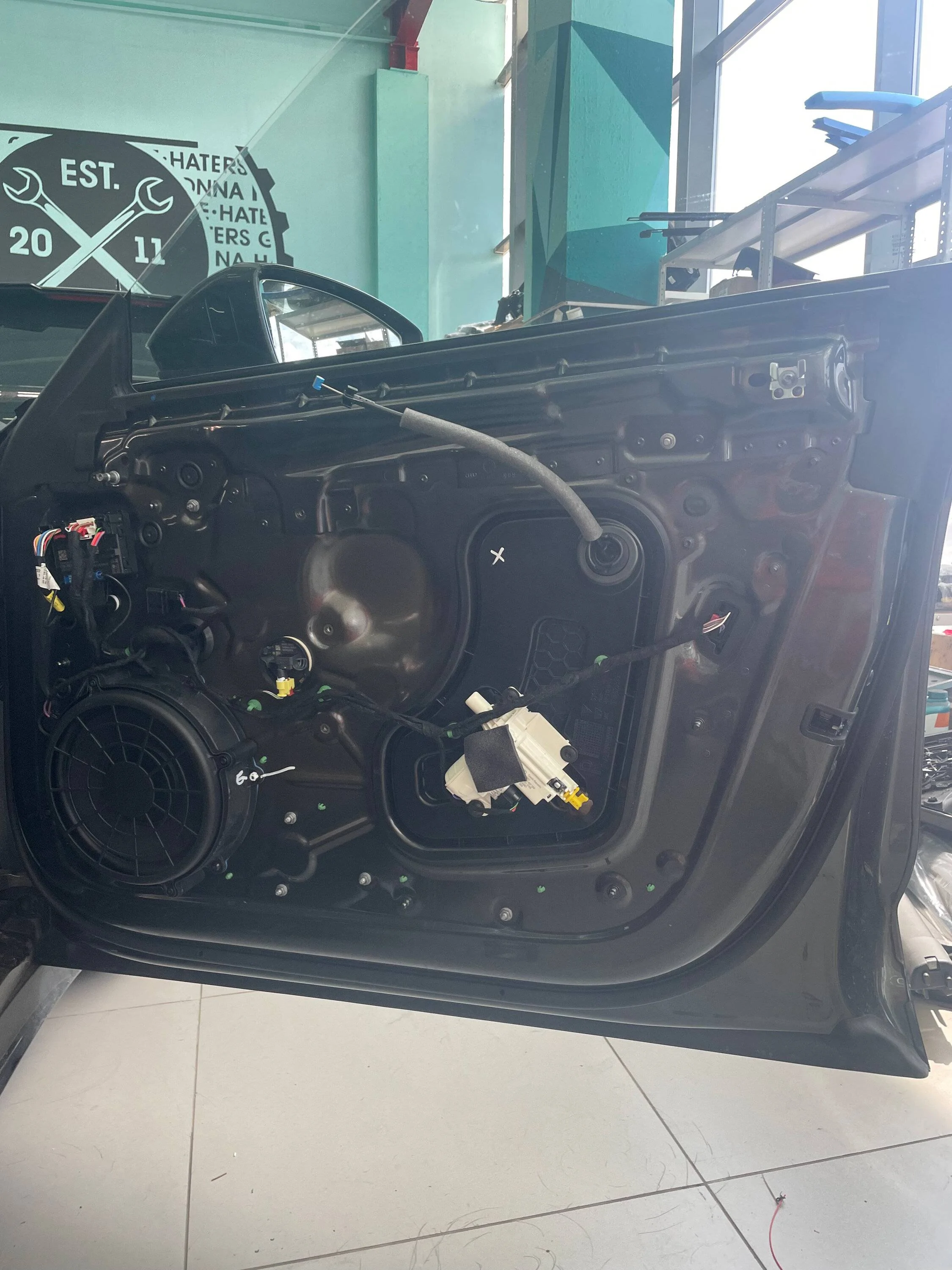

4 doors, made in 5 hours. 2000$ work and spare parts. I had to replace all the locks with new ones and add a soft closing mechanism.

4K1837016K 1 Pcs
4K0839016R 1 Pcs
4K1837015K 1 Pcs
4K0839015R 1 Pcs
4N0837059 2 Pcs
4N0837060 2 Pcs
4K0837315 2 Pcs
4H0973704 4 Pcs
4N0837315 2 Pcs
