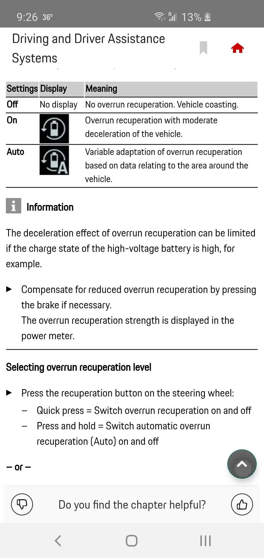

Looking at the Porsche Good to Know app, you can manually set the recuperation to "auto" through the menus, without needing to have ACC active.
Porsche Taycan Auto recuperation mode requires ACC? Screenshot_20200218-092619_Porsche_Good_to_know[1]
