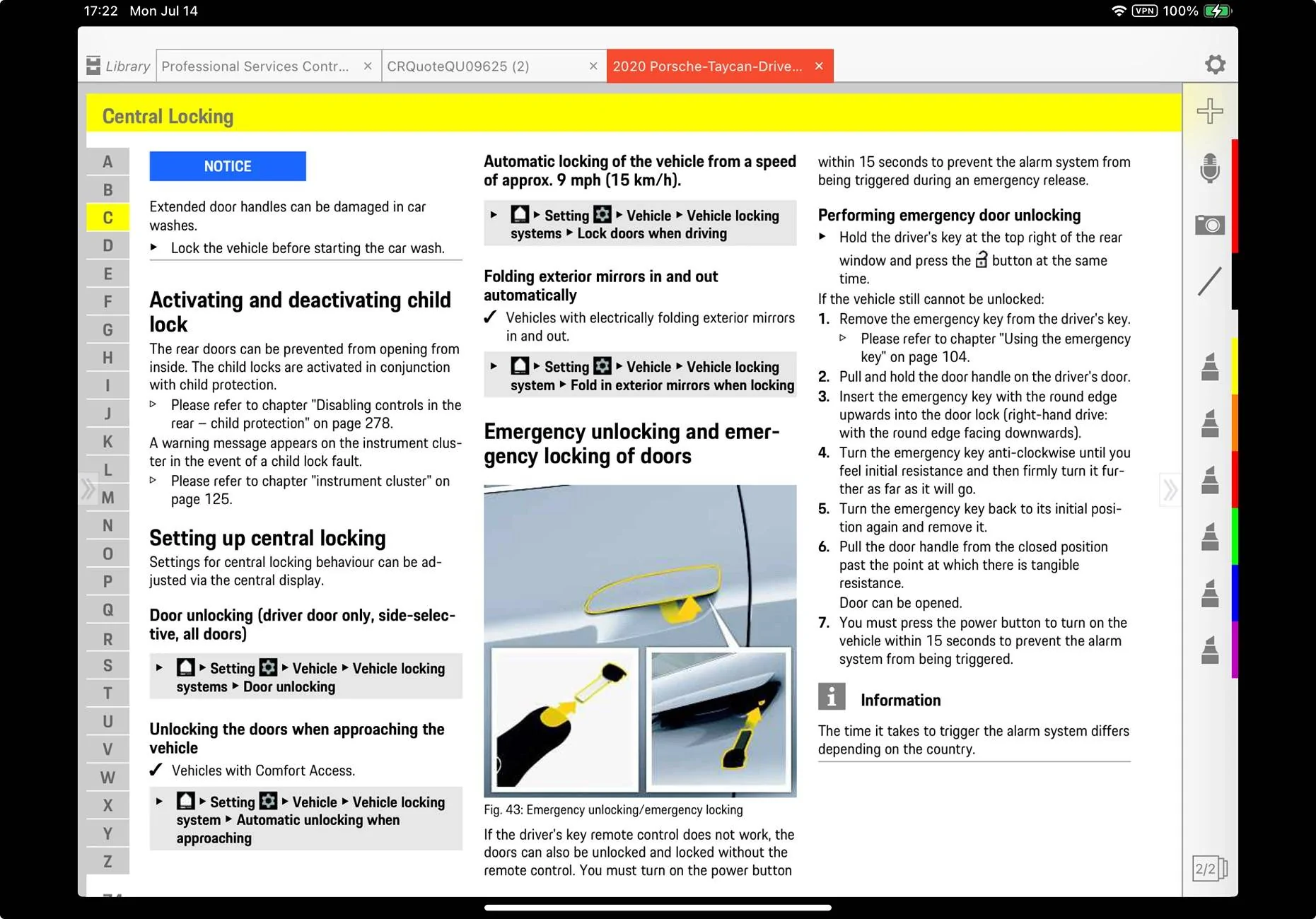

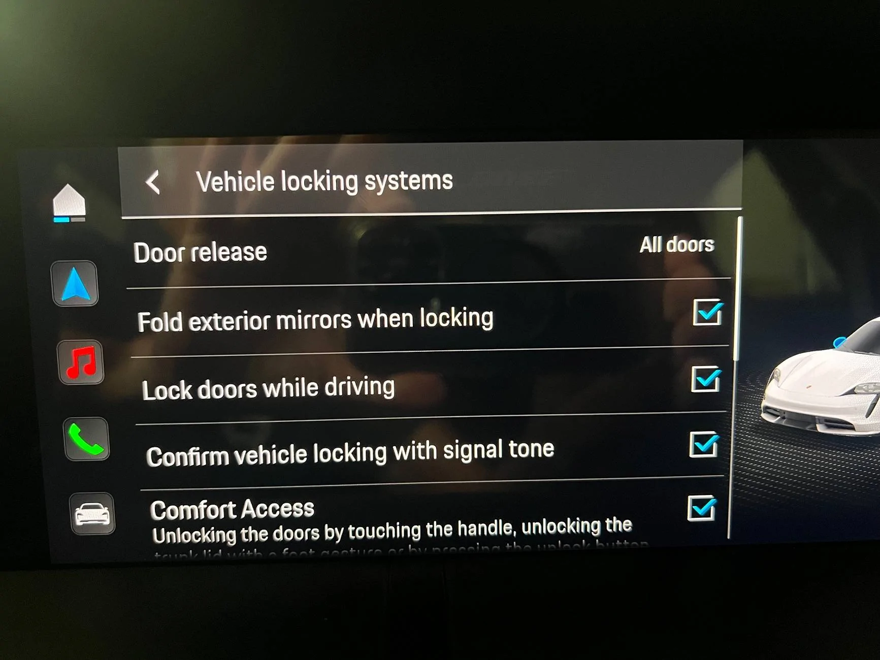

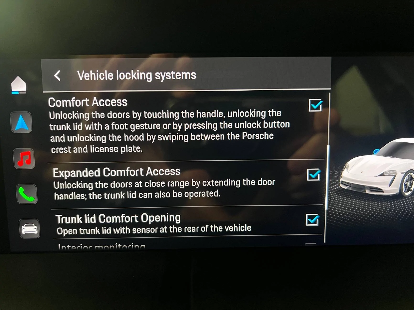

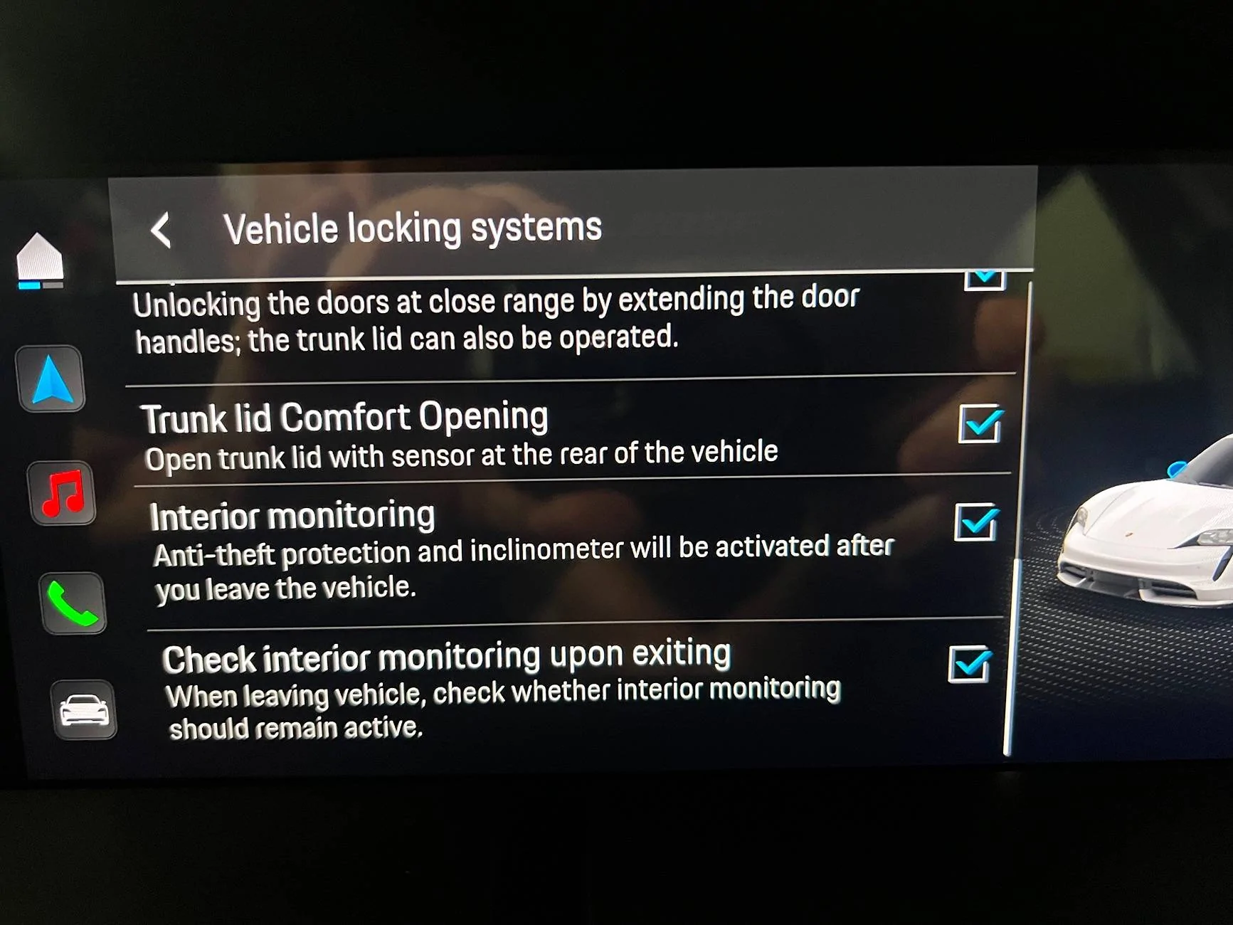

Not certain if this is what you are looking for. Page 76 owners manual MY 2020.
Setting up Central locking lower left of page.

Thanks for the references. However I still don’t see the option to turn off the unlock when car is put into park.
For safety reasons I prefer the car to remained locked when I put the car in park.

I agree that there does not appear to be the option to click to keep doors locked when placing the car in P and turning off.
My doors stay locked until I or a passenger pulls the door handle. So not certain why your doors unlock.
Maybe it is a function of one of the options being selected even though it does not refer specifically to P or Off. Maybe try a few combinations.
Best of luck.

@REIL - I was thinking that unselecting comfort access may do the trick but you have the option selected. Do you have all options under the vehicle locking menu selected?
@whitex - curious to know your vehicle locking menu options as well. Do you have all selected as well?
Thanks in advance for the help!!
