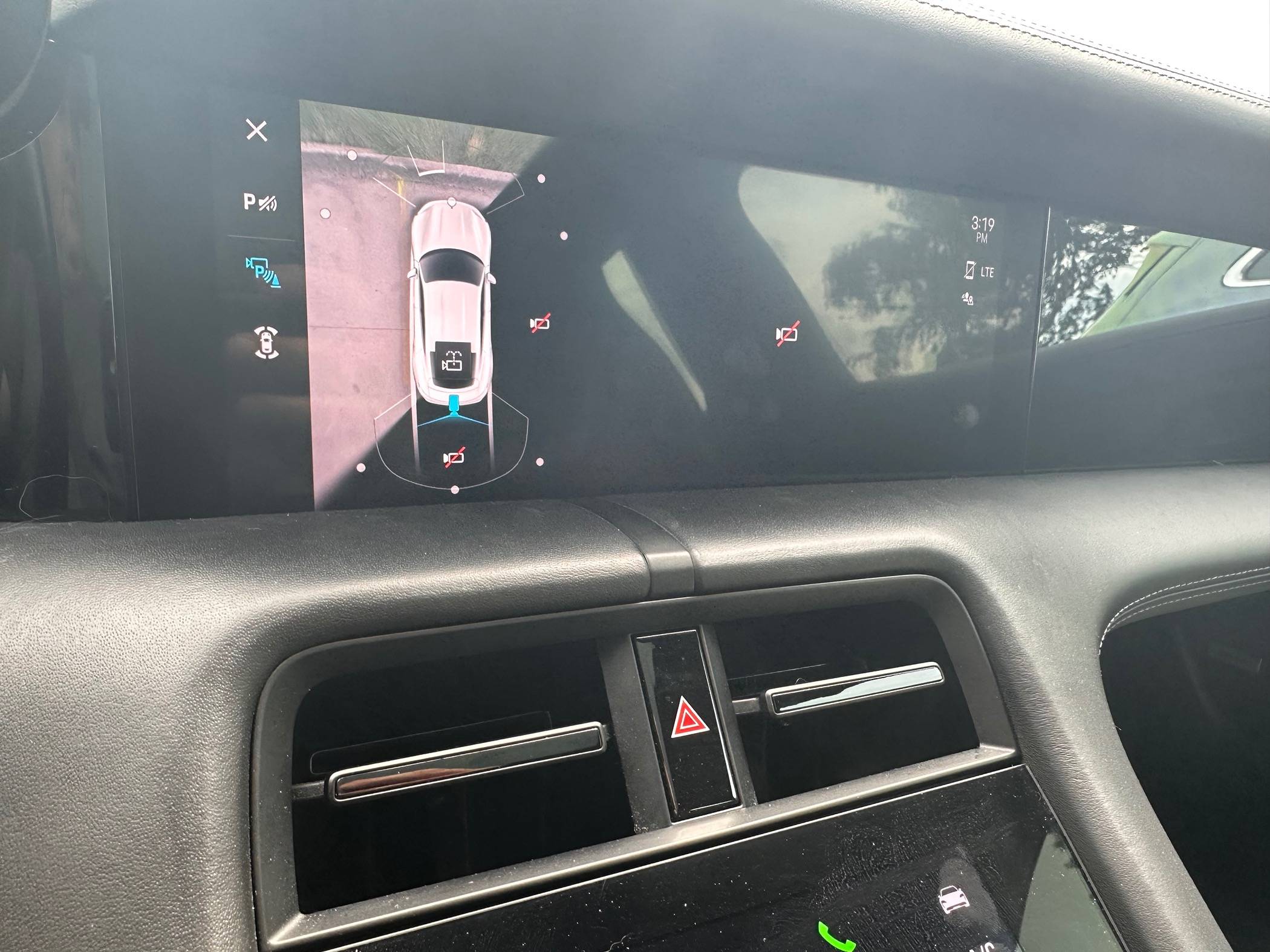

Got the Taycan back from dealer from re doing alignment of sensors. And found the 360 view isn’t working about 60% of the time.
Sounds like there is a bulletin for this :(.. first step is replacing all cameras and wire harnesses.
And that may not fix it, if that doesn’t it is control units, I am curious what changed as this was working fine and these cameras aren’t part of the windshield alignment/calibration as far as I know.

Mine is facing the same problem. Inspected by Porsche GB and returned unfixed waiting for an advice from Porsche Germany.
It’s been more than two weeks since then and still no solution!

I had the same issue and the entire wiring loom requires replacement. It’s a big job, my car was in service for 8 weeks.

I bring my 2021 Taycan in to Porsche service on Monday for the same issue.
Sometimes all, one or few of the cameras work & sometimes they don’t. I hope it’s not an 8 week repair and that time was mostly waiting for parts.
