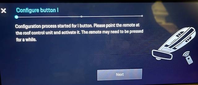

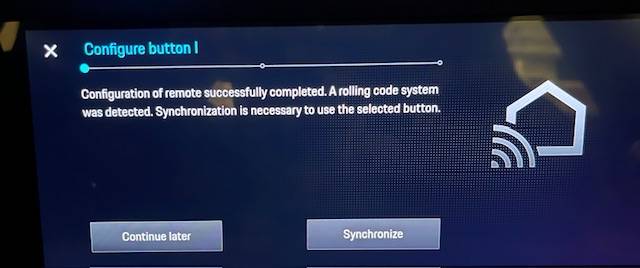

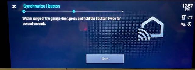

I thought the Taycan’s HomeLink implementation couldn’t handle rolling codes. Are you saying this is now possible after the software update or did you already have a workaround?
Asking as I want to keep using bi-secure (rolling codes) with my Hormann garage door rather than dumb it down to fixed code mode.
Can't handle proprietary rolling codes e.g. Hormann door openers and to resolve you need to install the Universal Receiver (UR) and train Homelink to that (works a treat).
