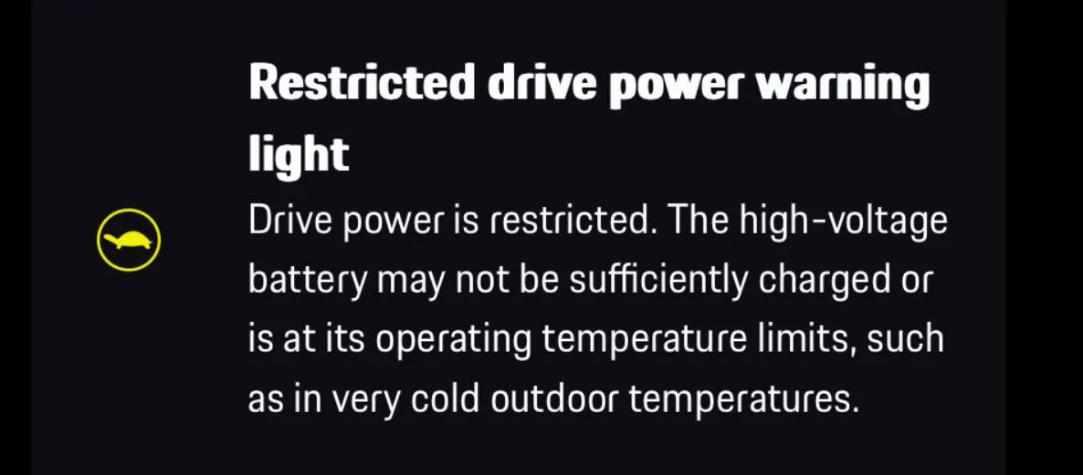

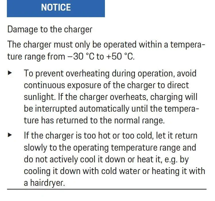

Mine also failed when it got colder. The actual error reported by the onboard charger was about being unable to read a temperature, so perhaps related to change in temperatures.
Sajan
Dec 5, 2024
Texas
2024 Taycan GTS
been charging fine for weeks...
a random cold front came through yest. temps dropped to 30-40s.
won't initiliaze charging.
i haven't had a chance to take it in to read the codes but I am pretty certain it's related to temperary.
