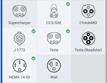

BTW: here is a picture of the "filter" settings for Plugshare for charging a Taycan - the Tesla plug type is only supported _IF_ you have purchased a JDAapter/TeslaTap - there are four plug types you can charge the Taycan with:
  • CCS/SAE (fast charging)
    • no equipment required in the frunk to use these chargers - just the car.
  • J-1772 - L2 - normally 6 kW (sometimes more/less)
    • no additional equipment in the frunk required to use this equipment - just the car
  • Tesla - L2 - normally at least 9.6 kW (sometimes more/less - more doesn't matter for Taycan)
    • requires JDApter/TeslaTap stored in your frunk to use one of these chargers.
  • NEMA 14-50 - 9.6 kW - can be found at hotels, workshops, campgrounds, and some businesses
    • requires you to have the Porsche Charger (EVSE) with 14-50 supply cable with you in the car - or another brand EVSE with 14-50 adapter - you can't use a "raw" 240 volt plug without your own EVSE - the Porsche charger that you purchase with the car _IS_ an EVSE - you can use Porsche's or any other EVSE that you bring with you.
other "50" amp circuits are easily converted to NEMA 14-50 with $20-$30 plug conversion adapters found on amazon - NEMA 6-50, SS2-50P, and 10-50 are possible 50 amp circuits you may find in the wild.
NOTE: the JDApter/TeslaTap will NOT allow a Taycan to utilize a TeslaSupercharger.
