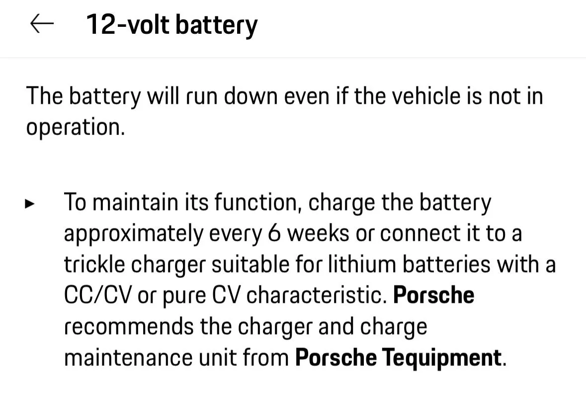

OP I assume your charger is compatible with lithium ion? My c-tek has a button to reset the battery electronics if a battery state gets to low.
Yes, it is unclear if simply plugging in is enough to charge 12 volt or if it must be driven.
I am 100% embarrassed to say it was not designed to be compatible with Li-Ion batteries. It was all I had in the garage and I wasn't really concerned when I was just using it to "wake up" the system and turn off relays. In hindsight I can see I may have created other issues if the charging profile was not designed for Lithium Ion batteries🫣

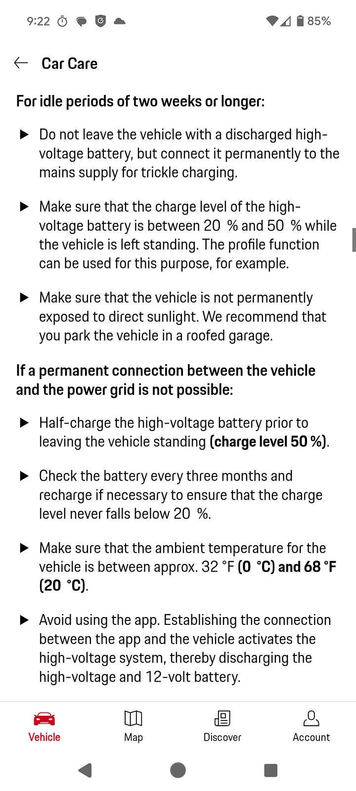

You are right to question depleting the 12V battery to zero. That is a killer for Li Ion batteries. I certainly would not do this by design.
You are totally wrong on saying the main battery should never get below 50%. The problem at low SoC is getting the battery cells into the lower voltage knee. This is below 20% or maybe 10-15% if there is a good buffer, which is what a number of posters have said. If you are in the voltage knee then you run into balance issues and one cell could get to zero before the others and wreck the cells. Hence dont take the 12V to zero but you can easily run the main battery down to 20%. Holding an Li Ion battery at 30% is a good way to store them.

I didn't mean to say never let the main battery go below 50%. I was told by Porsche to never store the vehicle for weeks or months with the battery below 50% since it will negatively impact the 12v battery. If your keys are close to the car or you wake the car electronics up by going to the My Porsche app this will also drain the 12v battery over weeks or months.
Hopefully the dealer will see if a reset/charge of the Li-ion has any impact before you have to spring for a new battery.
