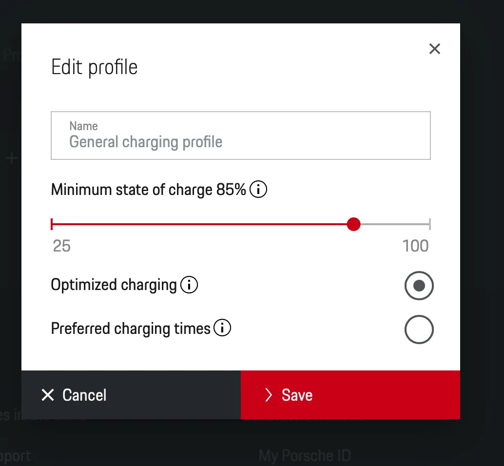

Can you share exactly how you set up your 85% profile?
I have a Wallbox Pulsar Pro as well installed with a program from 9pm -6am but I find when i have that program on it conflicts with the programmed timer and charging profiles set in my car.
Here's what the profile looks like on porsche.com

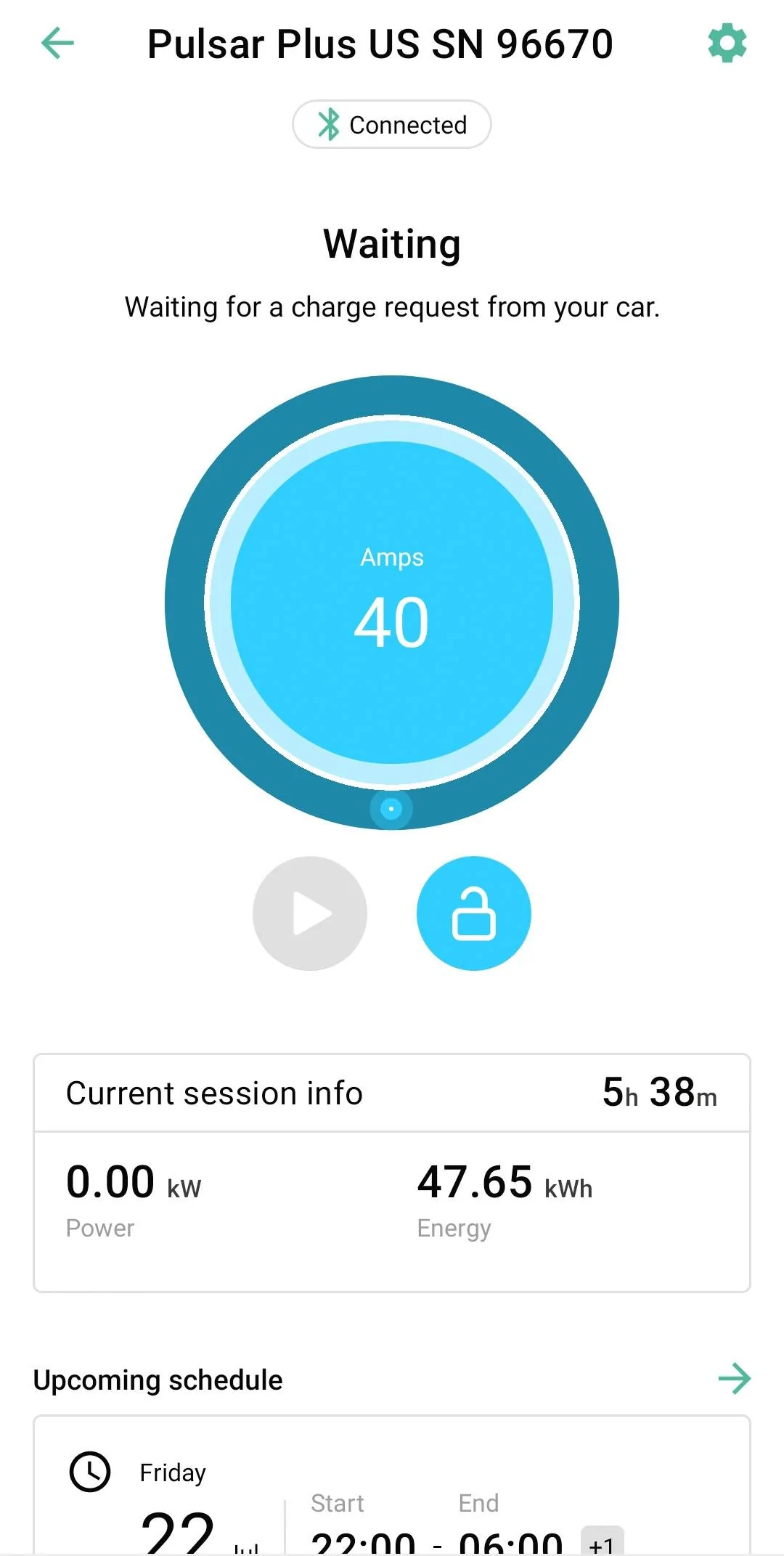

Nice will give that a go next time I charge my car at home
Pleased to report I tried out my timed program on the Wallbox + 85% charging profile on the car as instructed by others here and the combo worked perfectly. I'm now slightly less pissed off about the convoluted charge programming in the car.
Porsche Taycan Dumped Porsche Mobile Charger Plus for Wallbox Pulsar Plus PSX_20220723_072605
Porsche Taycan Dumped Porsche Mobile Charger Plus for Wallbox Pulsar Plus PSX_20220723_072631
