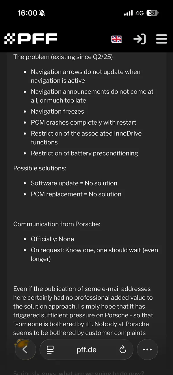

From the german forum
For people still thinking it's the hardware and not how the software manages cache:
Sadly, official communication from Porsche is being removed from there for privacy reasons.

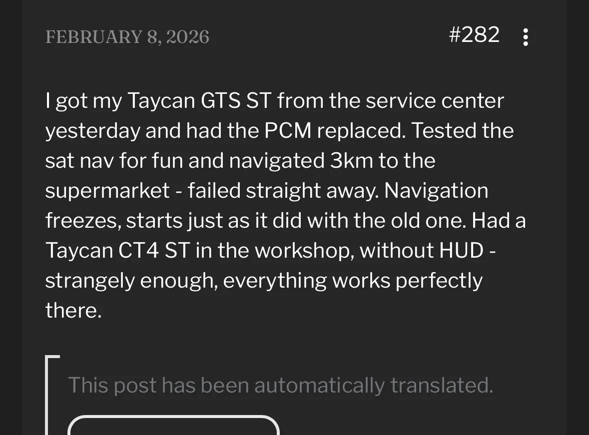

Porsche Taycan EU/UK: Ongoing navigation issues [Solved with PCM v3892] IMG_0280
Porsche Taycan EU/UK: Ongoing navigation issues [Solved with PCM v3892] IMG_0279
There was one other post here in this thread also mentioning he still has the issue even after replacement pcm.
So let’s stop the non-sense with “hardware” fixed the issue.
As I already stated, the devs in Cluj know the issue, budget is not yet allocated. No, I am not willing to leak the identity of someone just so a forum troll can agree that it is not a fake issue 😅
That being said, if you can get a newer pcm hardware, and are ok with services taking apart your car, then do it. Can’t be worse hardware than before, assuming they brake nothing else
The comment on the HUD is interesting... don't think I've seen that mentioned. Have people tried turning it off?
