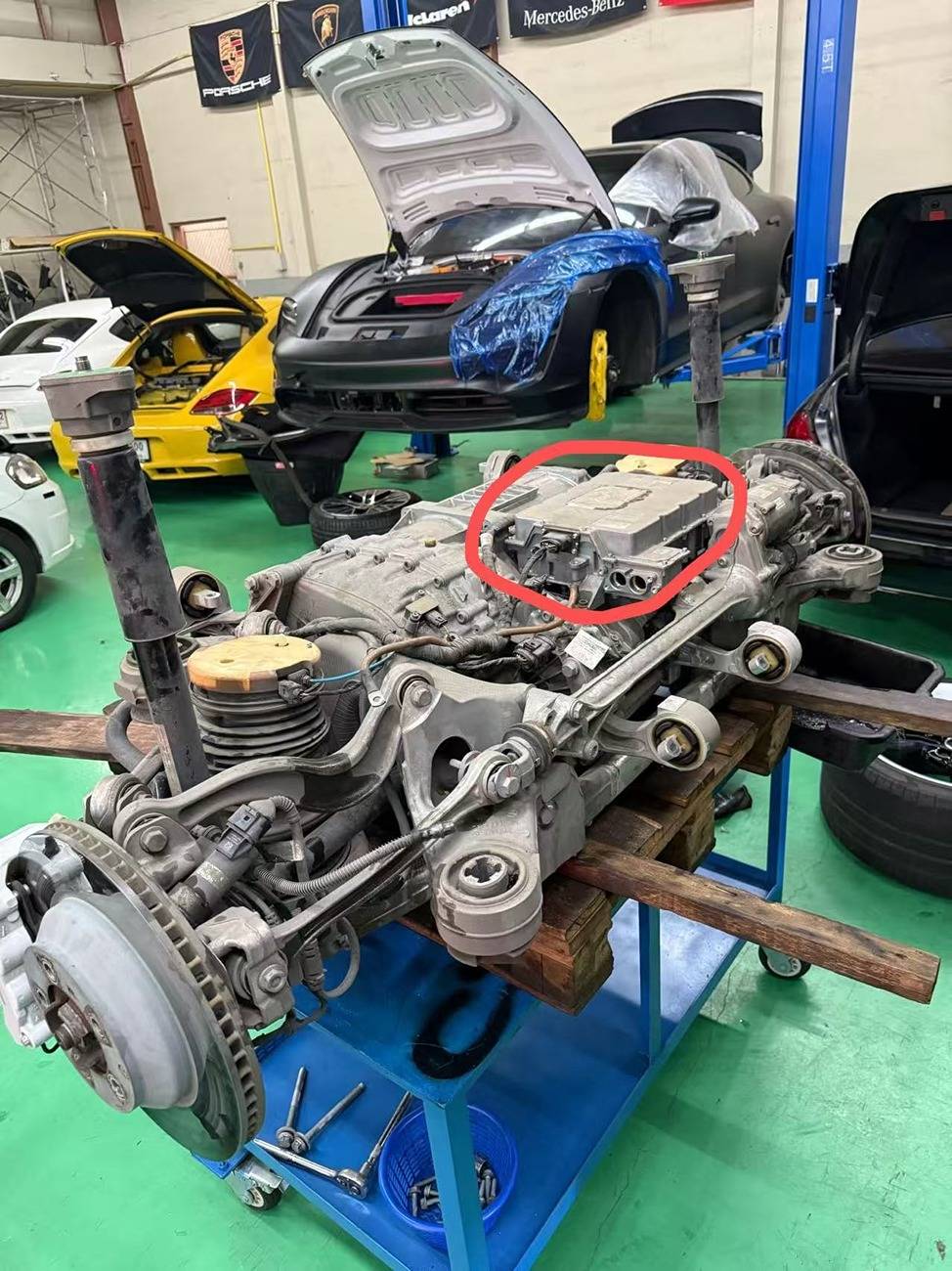

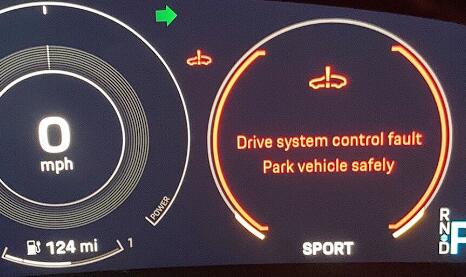

Another common Taycan problem, you floor the car (or a significant amount of throttle) and suddenly the car gives out with either of the warning messages above and you've gotta crawl to a stop. Restart the car, everything is fine (until you floor it again that is).
If you get this sysmptom very sporadically, then you need not worry. But if you get this almost everytime you floor the car, go on.
Porsche Taycan [EXPLAINED] WNA5 & DRIVE SYSTEM CONTROL FAULT 1745179386585-i
The failure is caused by no less than the part which Ive covered with a square. This is called POWER ELECTRONICS, MOTOR CONTROL UNIT, or informally INVERTER. This electronic unit converts the DC electricity from the battery into 3 phase AC power which the motors need, this unit is also responsible of feeding each of the 3 phases of the motor with the appropriate amount of current according to driver's throttle inputs.
Any AWD Taycan has two of these inverters. One at the front one at the rear

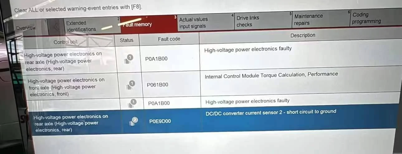

When this failure occurs almost everytime you floor the car you will see the following fault code:
Porsche Taycan [EXPLAINED] WNA5 & DRIVE SYSTEM CONTROL FAULT 376b1c66dec3484686a3b9ab8c31c62
P0E9D00 - Current sensor short circuit to ground. The moment you see this fault the inverter is DONE. Porsche techs will reprogramm it but it will make absolutely no difference.
The only solution is to replace the unit

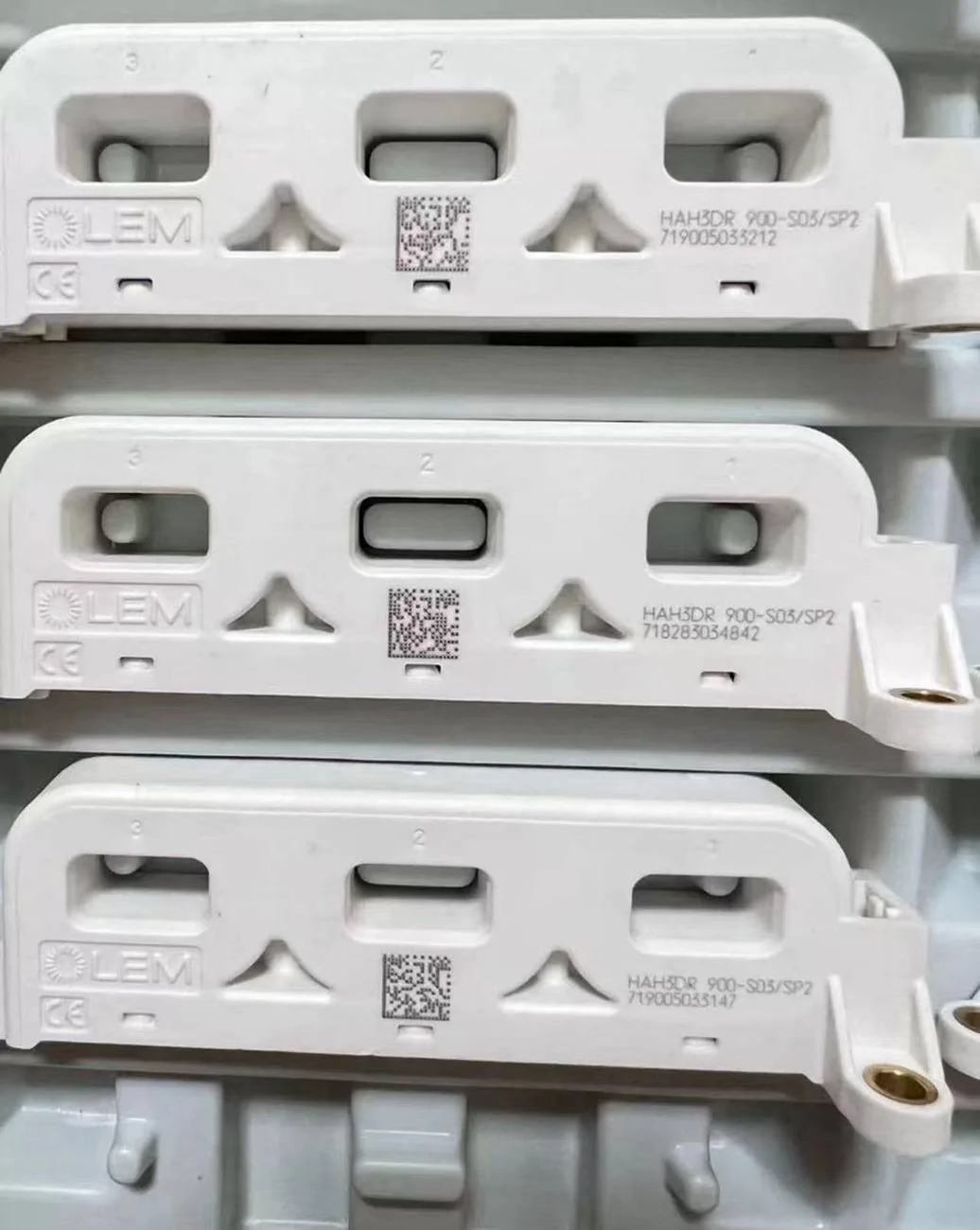

This unit is made by HITACHI in Japan and what goes wrong is the current sensor (and its circuitry) at the AC output. Which works esentially just like any of those clamp current meters you have at home.
Porsche Taycan [EXPLAINED] WNA5 & DRIVE SYSTEM CONTROL FAULT 1745179806318-d5

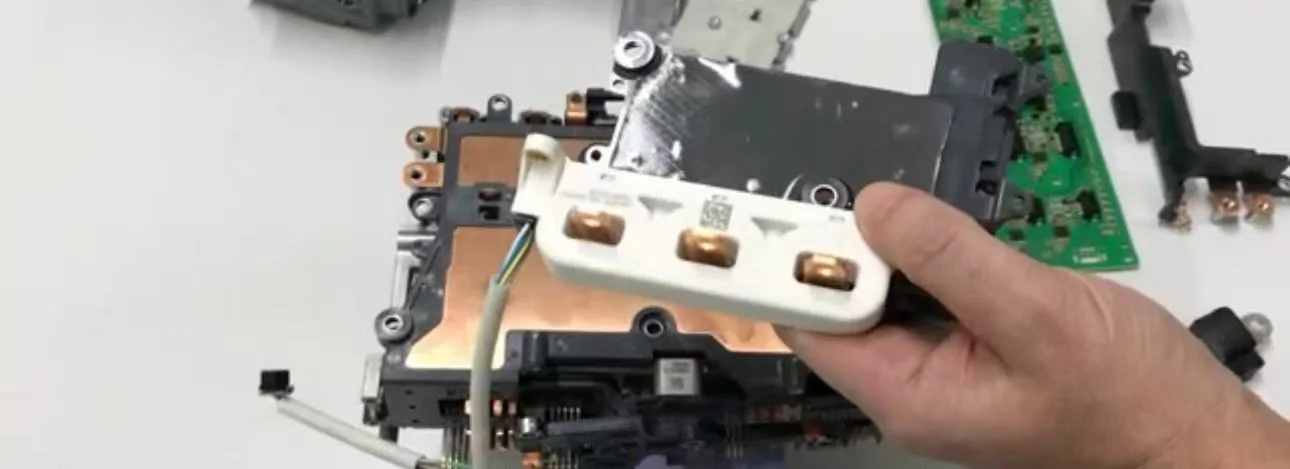

This is the current sensor. As you can see it sits on top of each of the 3 AC output phases and measures the current going through them. The part in question is HAH3DR current sensor
Porsche Taycan [EXPLAINED] WNA5 & DRIVE SYSTEM CONTROL FAULT ae4d0864ff1a1022af7618a04a770f5
Porsche Taycan [EXPLAINED] WNA5 & DRIVE SYSTEM CONTROL FAULT 6890dda72457c14a5f2a4f1d38a0781
I have ordered this exact sensor and replaced it in failed inverters, but haven't been able to successfully repair the unit. After replacing the sensor the issue persists which indicated that there's also damage to the circuitry that drives and controls the sensor but I am yet researching a way to fix this.

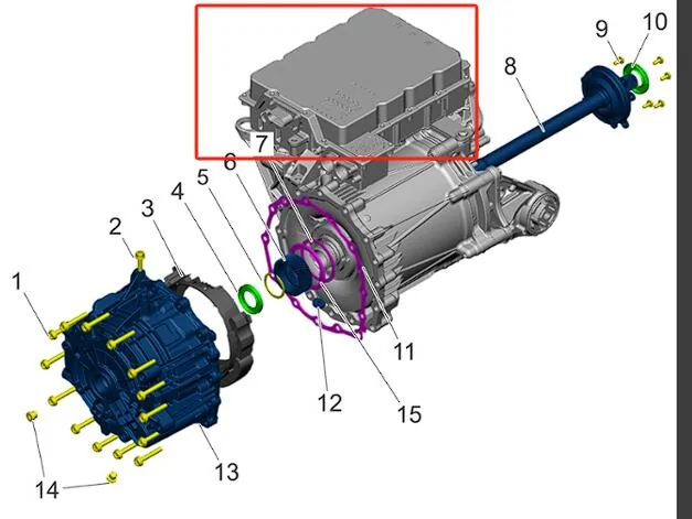

This is a relatively common issue in Taycans, although far less common than the battery issues.
If you are lucky and the failed one is the front inverter, replacing it is quite simple.

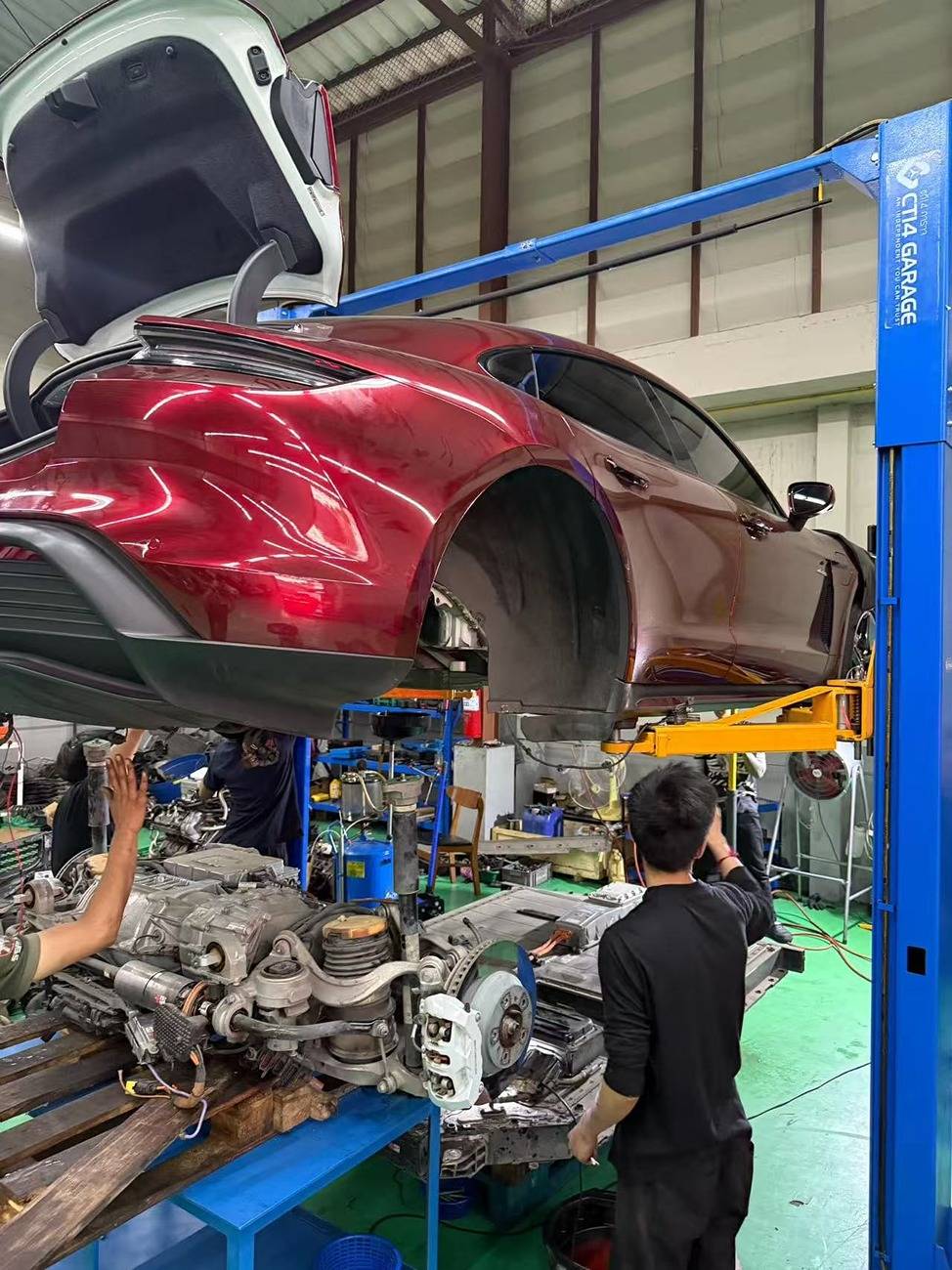

But replacing the rear inverter implies dropping the battery and the entire whole axle which is quite a lot of work!!
Porsche Taycan [EXPLAINED] WNA5 & DRIVE SYSTEM CONTROL FAULT ebca32ddb2e710c5703ecb37d7ed459
Porsche Taycan [EXPLAINED] WNA5 & DRIVE SYSTEM CONTROL FAULT 1745180087942-z
As you can see a lot of hours of work.

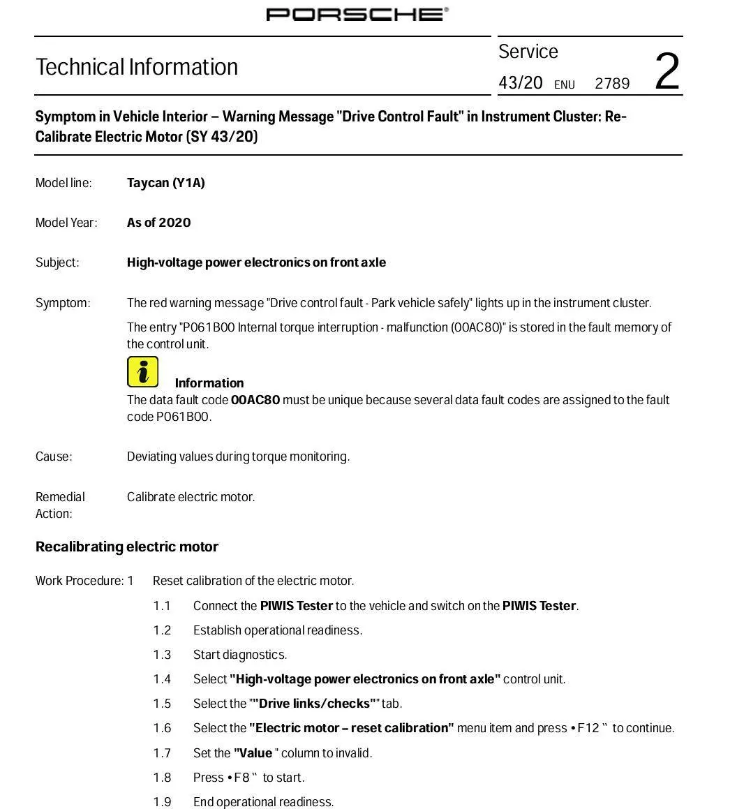

PS: The reason why Porsche dealer techs will try to recalibrate and reprogramm the inverter is because there is another campaign for cars with the same symptom which is indeed caused by a software bug and solved by a reprogramming...... However the fault codes aren't the same. What I am reporting above is a different issue and Porsche is well aware of it:
Porsche Taycan [EXPLAINED] WNA5 & DRIVE SYSTEM CONTROL FAULT 1745180268404-q
Keep in mind that this is different to what I reported above. This is for fault code P061B00 accompanied ALWAYS by 00AC80.
