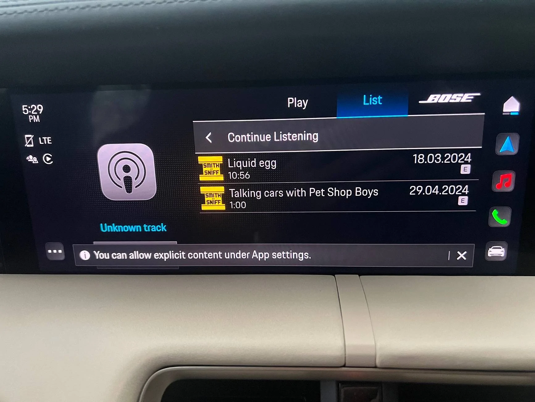

Anyone seen this before?!
I mean it's Smith and Sniff. Hardly smut.
Car refers to an app setting but I'm damned if I can find anything in the manual about filters on the car's audjo apps?!
Any ideas?

Of course not if your Apple Music app has this disallowed.

That's the thing. My Apple music app has no restrictions at all and it plays perfectly on my phone, PC and in the Tesla.
Of course I checked that Winge!!! This is a Porsche problem, hence my question.
The message says media settings sometimes and app others. Very bizarre.

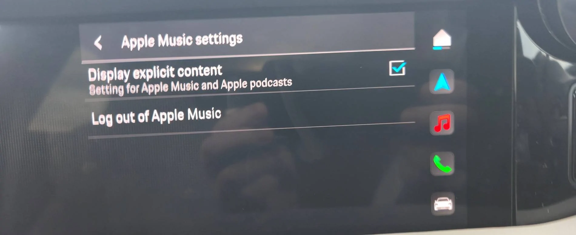

Ok wise guy I'm guessing you haven't set it on the PCM then?
"..." when Apple Music is selected.
Wise guy?! Hardly.
That's the thing. I don't have an Apple Music subscription so it's not logged in on PCM, I have Spotify.
Just Apple podcasts and the music library on my phone.
So I can't log into Apple music app on PCM so I 've not seen that option. ?‍♂
You can have podcasts without Apple Music. Porsche seem to have made incorrect assumptions here.
11,016
6,805
Wise guy?! Hardly.
Same option on Spotify I think.
Separate option for Apple Podcasts to control explicit content.
