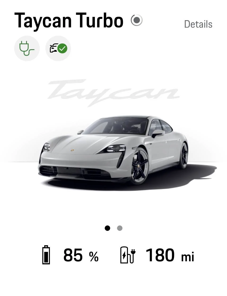

I also didn't get on well with regen on the over-run and quickly decided it was going to remain switched off permanently (coasting is much more efficient anyway). As has been said already, most of the braking when using the brake pedal is regen anyway (apart from during the first mile or so).
Through the depths of winter my Turbo has routinely given 220miles of range. I regularly travel approx' 150miles door to door and always arrive with 70+ miles range (and that's with cruising at ~85 on the motorway where possible). Taycan gets a bad press from some for its range, but i've found it very good and spot on the claims (if not better) and expect it will improve again when the weather is warmer. It also chargers very quickly which also helps.

200 / 215 is my max at the moment in my 4CT.
Mines covered 1600 miles
Hopefully it improves over the summer.
