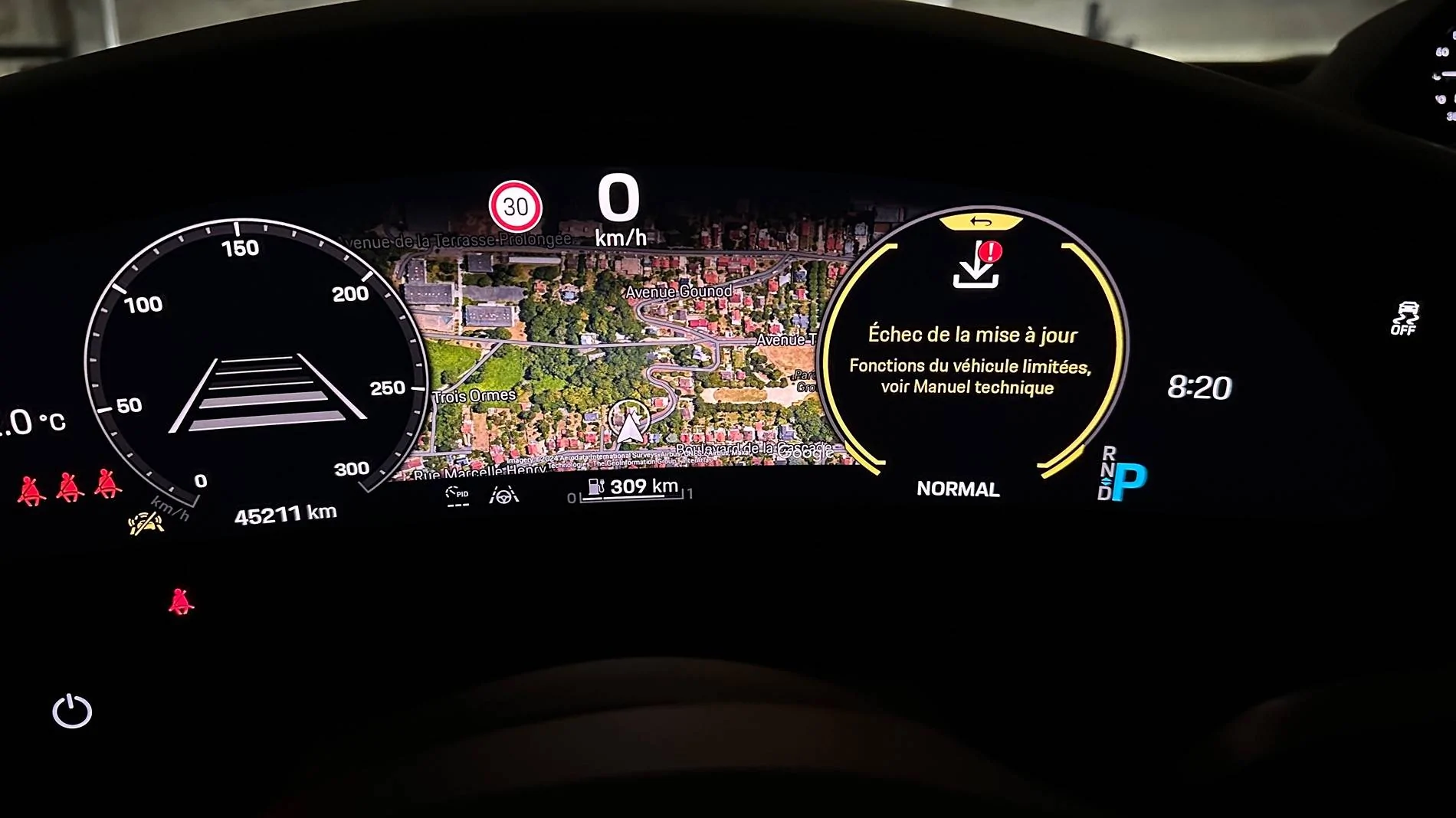

Ironically I’m currently stuck with the opposite loop, trying to test the innodrive feature for 3 months free. Warning message says Installation failed despite Innodrive is there and ok.
Dealer says he can’t take in the car because he won’t be able to give it back until the brake hoses are changed (and in back order)…Appointment on November 12 for 3 recalls (HV heater, PSM reprogram and brake hoses) and then this.
OMG

Indeed I did. No luck : the warning message comes back after just few seconds.
I did call the connect store assistance. The guy on the phone stated my car is seen as in privacy mode, which is not, the reason why the update won’t complete….
He had me activate and deactivate the privacy mode from the PCM with no result.

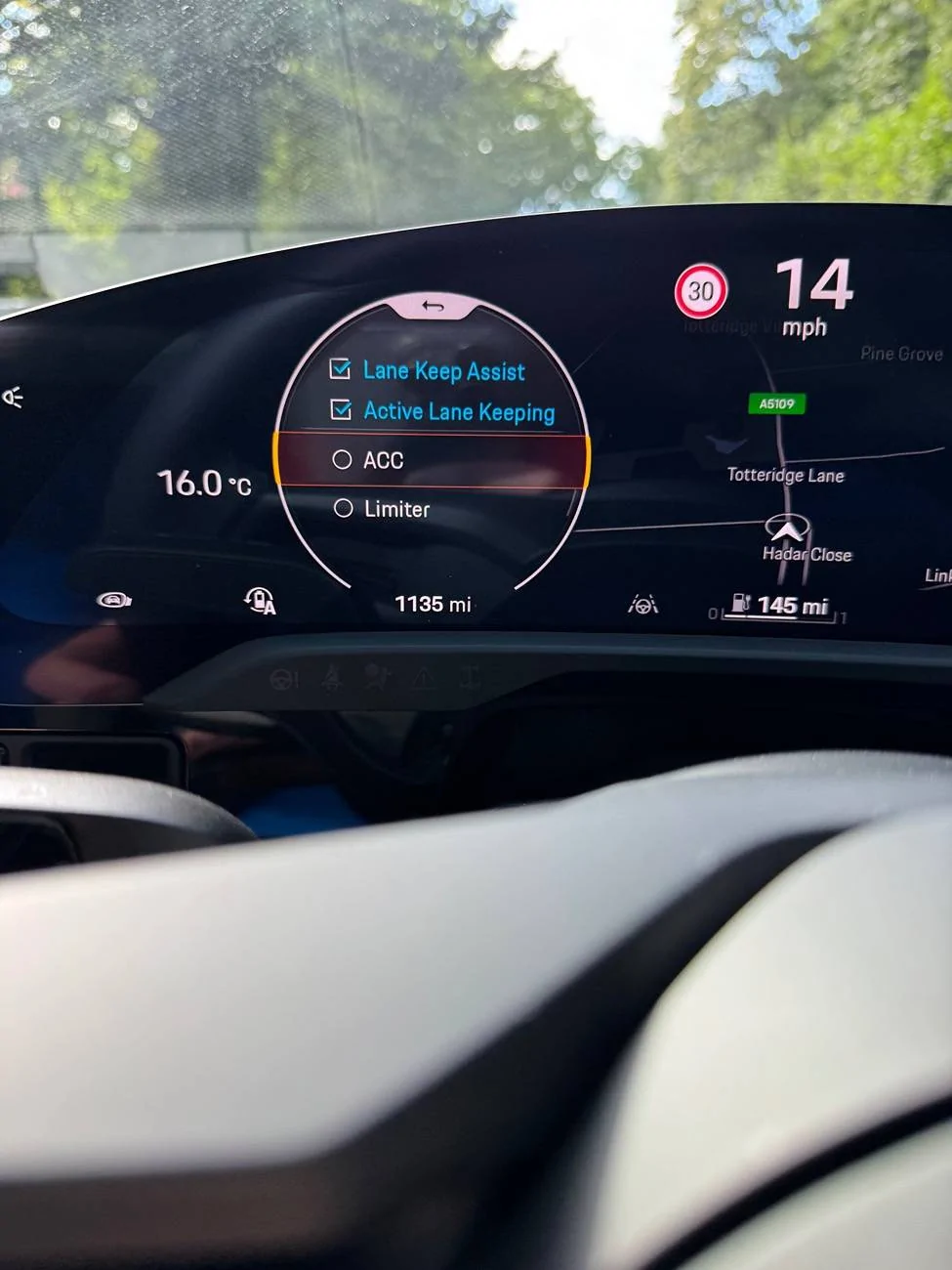

It seems to have worked for me...I have no innodrive option anymore!!
thanks
Porsche Taycan FoD - Innodrive - cancellation update stuck in a loop IMG_4161

Update and end of this story. I've been unable to get rid of this error and those popups messages kept coming up by myself... Innodrive has been finally fully activated at the Porsche workshop when in for 4 recalls.
