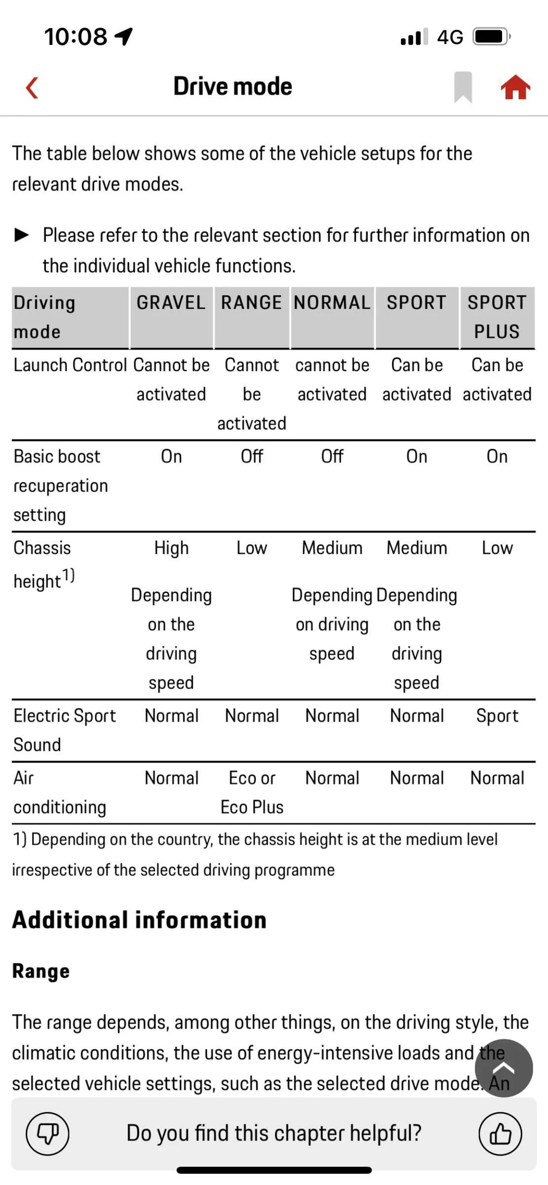

Thanks Roppe - just to clarify - you don't get Sport Plus though? What is the difference between Sport+ and Sport mode?
Roppe
Oct 15, 2021
148
125
Stockholm, Sweden
CT4S MY22
My pleasure. You still get them all, below is a pic of the difference between them. I recommend downloading the Porsche good to know app - really easy to navigate and find info in it! ?

I thought you needed Sport Chrono to get Sport Plus and Individual modes.

Hi, does anybody have more info on different driving modes? What exactly do they change? Throttle response, breaking, steering ?
11,016
6,805
If this is the case I do apologize. I was under the impression that this option did not add these. Perhaps someone without Sports chrono package can confirm?
Sports Chrono adds the following:
- GT multifunction sports steering wheel including mode switch for selecting driving modes Range, Normal, Sport, Sport Plus and Individual
- Analogue and digital stopwatch
- Sport Plus mode with performance-oriented tuning of chassis, Porsche Active Aerodynamics and temperature control of the performance battery
- Individual mode for individual configuration of the settings for driving mode, chassis, chassis-level and Porsche Electric Sport Sound (note: settings options depend on the equipment)
- PSM Sport mode
If you don't have Sports Chrono you can personalise the My Home screen on the PCM to add the various standard drive modes - Normal, Sport, Range. Additionally you can customise this screen to add other widgets - battery range, map, others. This makes selection quick and easy.
Launch Control comes with all cars - only pre-requisite is to engage Sport drive mode.
PASM selection from normal, sport & sport plus is standard with air suspension and Sport Chrono is not a pre-requisite for this.
Read the Porsche Good to Know App on this topic.
Essentially, 'yes' is the answer but add suspension height, damper stiffening, further tuning of PTV+, PDCC, Sport Sound and RAS where fitted.
In general you won't tend to deviate from Normal, Range and occasionally Sport
Different drive modes definitely change steering weight and throttle response, and suspension firmness, similar to Porsches ICE sports cars.

I have a CT4s without Sports Crono (I don’t like the hump either). I don’t have a sports+ car setting, but I have a sports+ chassis setting.
