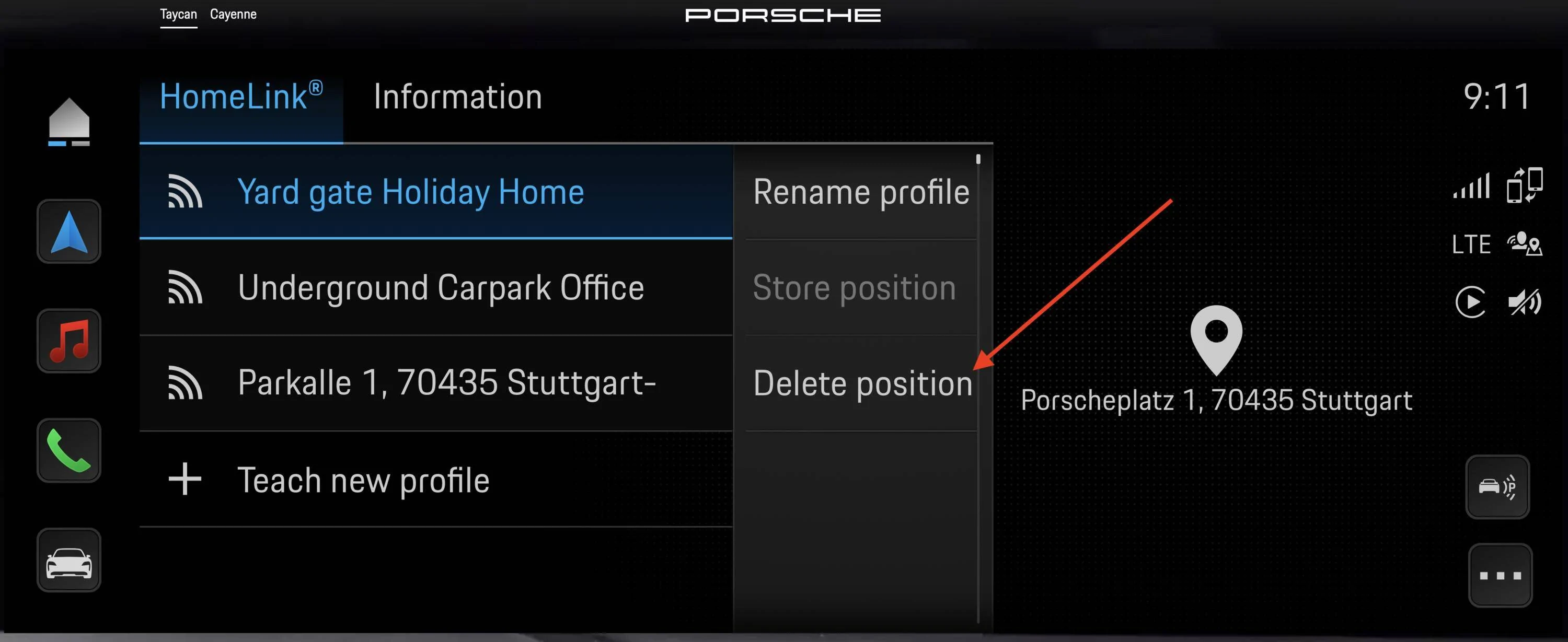

Is there a way to remove or change the GPS location associated with a Homelink profile without deleting the whole profile? I would prefer that the Homelink does not pop up when I pull up to my garage and want to remove the GPS location without having to reprogram the garage opening function. Thanks in advance.

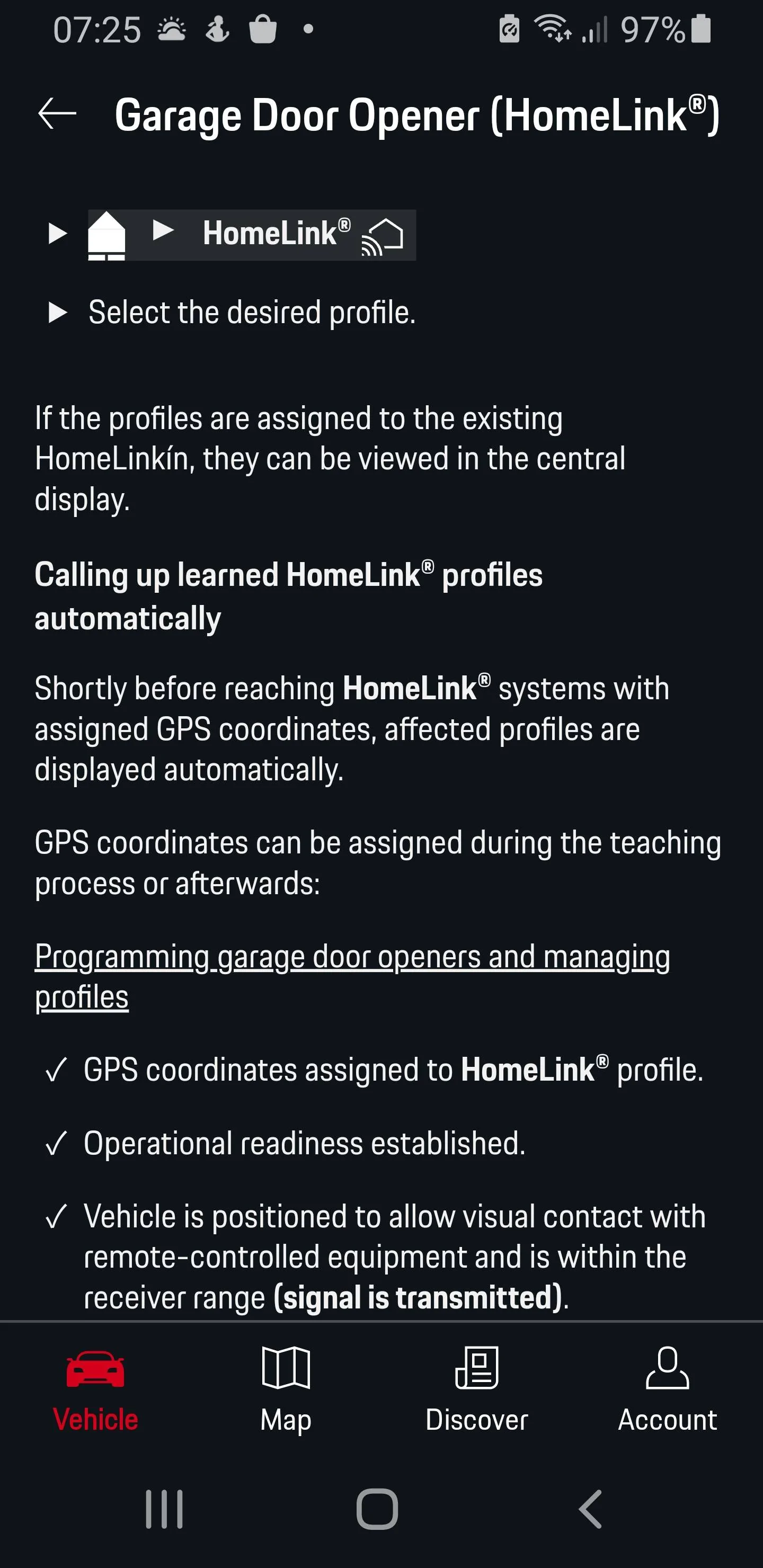

I believe you can. Try to edit and remove the GPS option. It's optional when you create it and therefore likely it can be removed separately.
Porsche Taycan Homelink and GPS location Screenshot_20231201-072553_My Porsch
