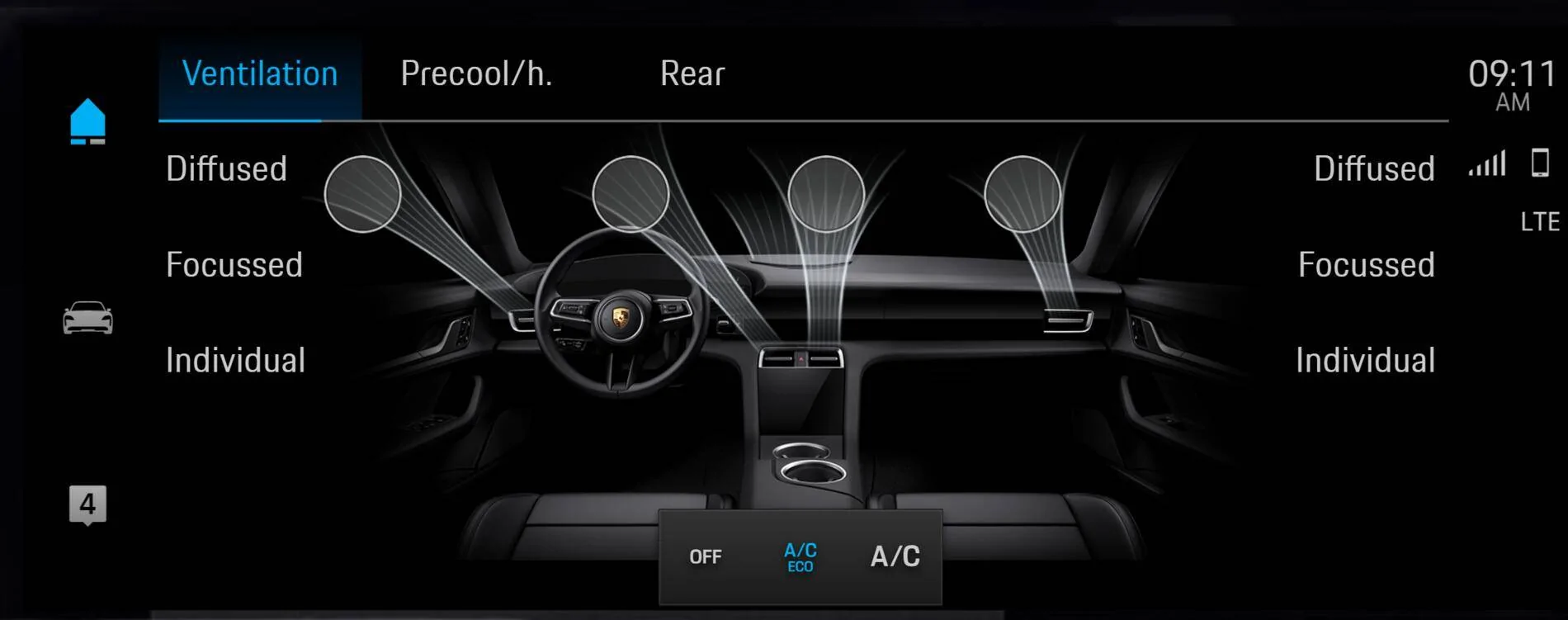

Can't you manually override within the Climate settings - 'plus' element not however as I think is reserved for Range?
Porsche Taycan How good is eco plus AC 1624274836479
