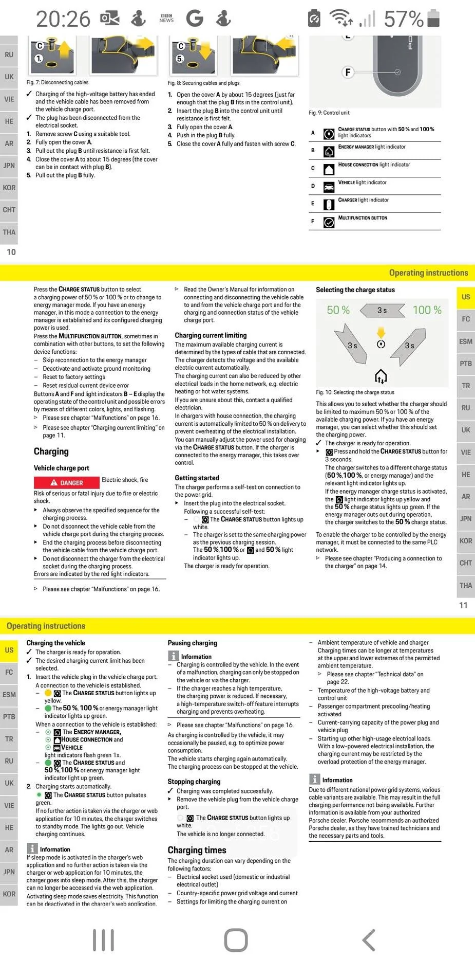

In the Uk the Taycan comes with a 'Mobile Charger Plus (MBP) with 4.5m vehicle side cable'. The MBP manual says it can be set to 50% or 100% charge. No mention of intermediate settings.
The recommended maximum continuous charging level is 80%; With 100% being used when a long trip is planned.
How do you set the system to stop at 80%? Is it a function in the car software? or the MBP control APP? Or do I need something more sophisticated like the Porsche Mobile Charger Connect?

I don’t have my Taycan yet (hopefully within 2 weeks), but I did do some research on charging. The basic charger has an option for 50% power or 100% power. The Taycan doesn’t have a way to limit current to 32 amps, for example, on a 40 amp circuit. That’s taken care of by your charger, not the Taycan. So the basic Porsche charger comes configured to draw just 50% of the possible current that your plug tells the charger it can draw. If you have a NEMA 14-20, for example, it can draw 16 amps continuously (maximum) at 120V. At 50% on the Porsche charger, it will only 8 amps, or .96kW - not much. The big brother, the PMCC, has a selectable limit beyond just the 50% and 100% choices.
Again, I’m just guessing based on your post. But the 50% and 100% numbers align with the documentation on the charger.

You can throttle it back (manual screen shot attached). Not as flexible as the PMCC but...
Porsche Taycan how to set a 80% Charging limit? Screenshot_20211011-202629_OneDriv

The key point to pick up post first answer is that the EVSE advertises to the car the maximum charging current but the car controls the actual charging current and charging process. Don't confuse [maximum] charging power (50% or 100% - controlled by the EVSE) with vehicle target charge (controlled by the vehicle).
At home, you probably don't need an EVSE where you can control the maximum charging power (you just want it to properly set this based on the type of pigtail - e.g. 14-30 vs. 14-50). However when you travel, you definitely want a more sophisticated EVSE where you can dial back the maximum charge power for where the grid is less reliable (think campground or an AirBnB cottage).
