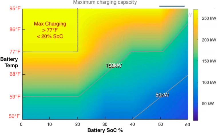

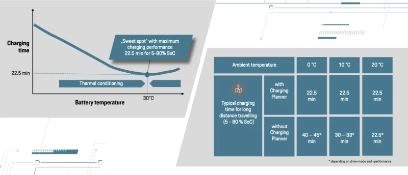

I don't know how cold it is in Silicon Valley, but the battery needs to be 90 degrees to get a good charge. I recommend you use the "battery saver" charge function. At 30 degrees OAT, I get 100KW all the way up to 90%. Using that function basically gets the same chrge spec in 25 min instead of 22.
EA can also be the problem, but I have not had any problem on the old chargers.

I set the location of the charger in nav and drove there. Travel time was about 18mins. When I plugged in, the battery was not heated up to 90. Any idea what may have prevented the preconditioning? I thought it would automatically do that if I tell the car I am going to charge by entering the charger destination in the nav.

Battery heating wont engage in range mode, but sometimes it takes more than 18 minutes. between 85-95 is the ideal range i think though.
