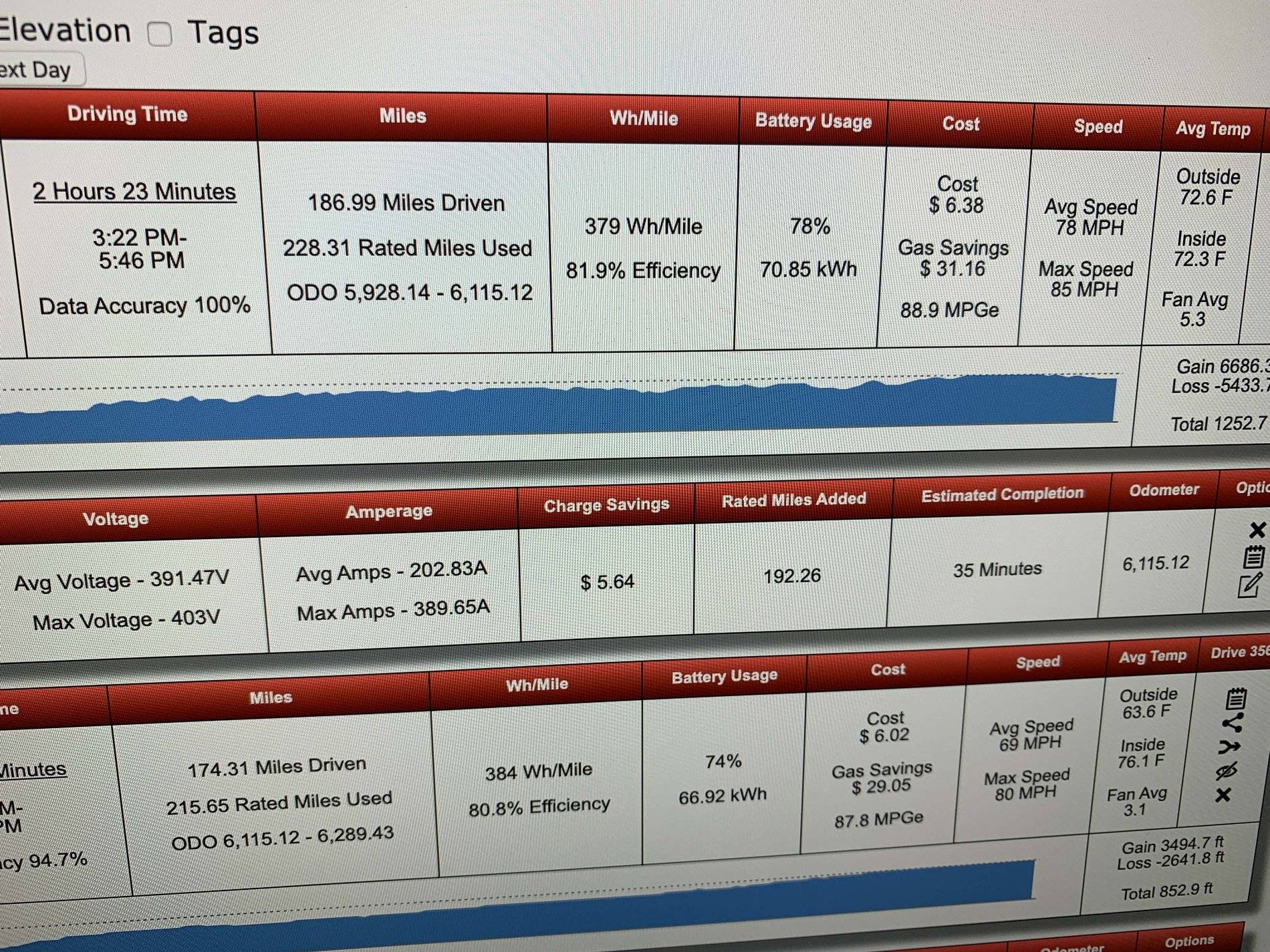

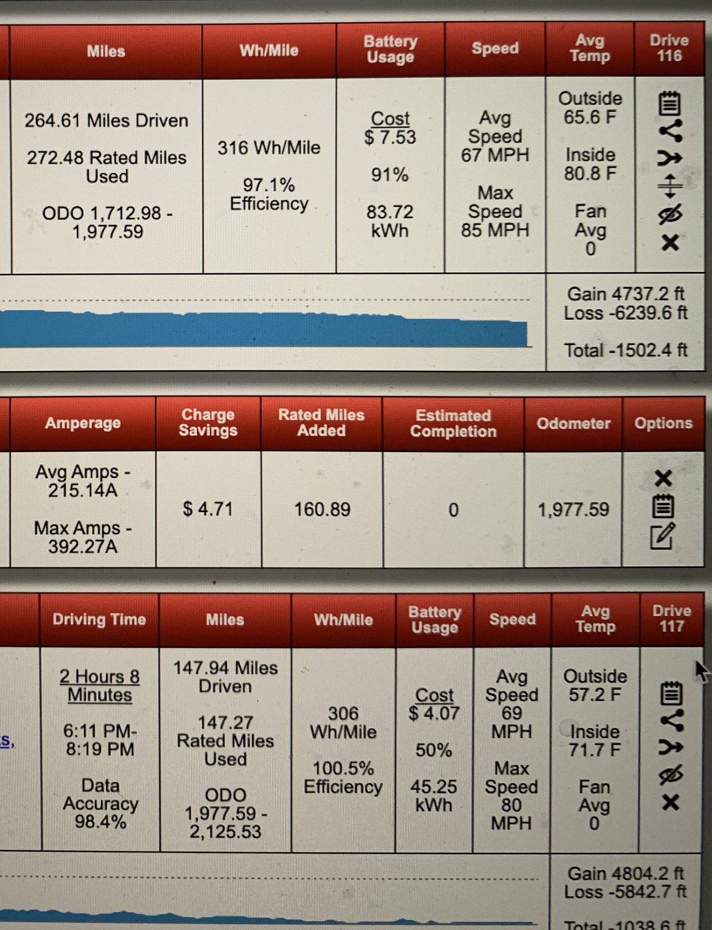

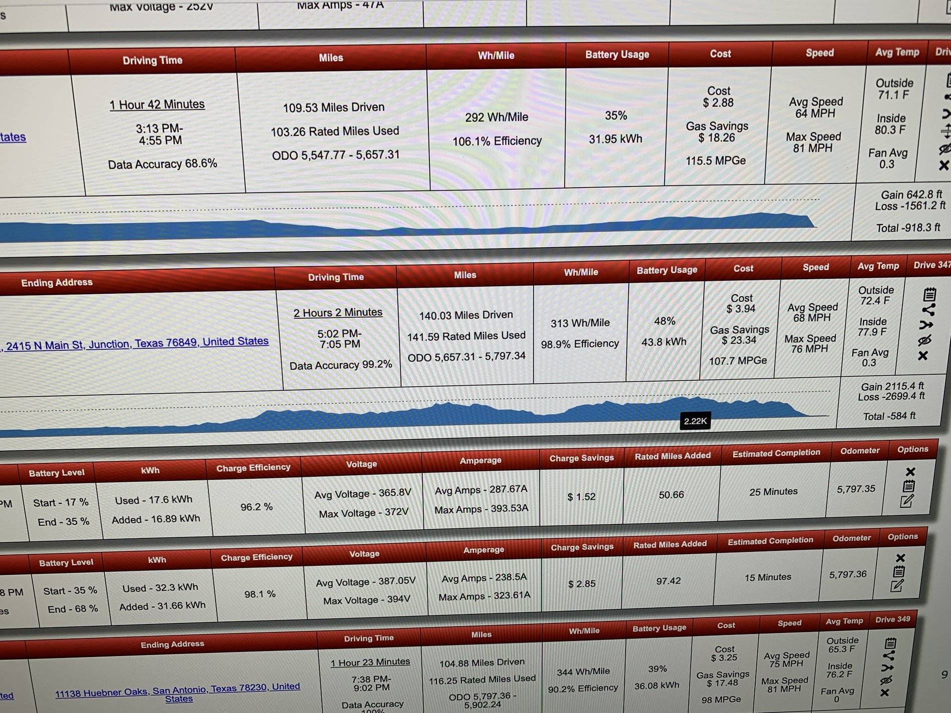

The EPA rating has never factored in real world driving for any car, ICE or Electric. The Porsche Taycan EPA rating does appear to be too conservative. I was shocked at how close to EPA rating I achieved in my 2020 Tesla Model X Performance edition in good weather conditions. Does it achieve EPA under cold weather high wind driving? No, of course not, and no other car does either. Hopefully Porsche will re-evaluate the EPA rating and adjust accordingly. There is no conspiracy to rate Tesla higher. That thought is foolish nonsense.

The charge rate would reflect my home charging in Texas. Not sure why Teslafi used it on this trip though, because I used supercharging and I have free supercharging. I'll have to look through the history to find a flat mileage trip. On this particular trip I didn't take the same route home as I did to get there. There are a lot of hills West of San Antonio on I10, and that is the reason for some of the elevation readings I'm sure. I documented this trip because I was honestly shocked at how efficient the Model X was. I just picked it up 3 weeks before this trip and was expecting it to be an energy hog. I previously owned a 2014 P85 and do not recall it being this efficient (although I haven't had it in almost 3 years so just going by memory on that note). I did make a recent trip in cold rainy weather with a headwind and the efficiency was pretty poor. I'll get a shot of it and post.

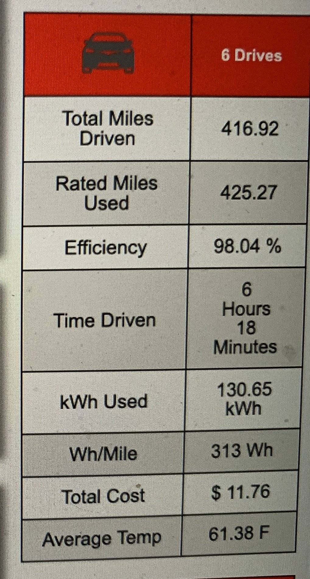

Here is a trip with some amazing efficiency. Remember, this is a heavy performance model SUV offering from Tesla. ¯\_(ツ)_/¯
