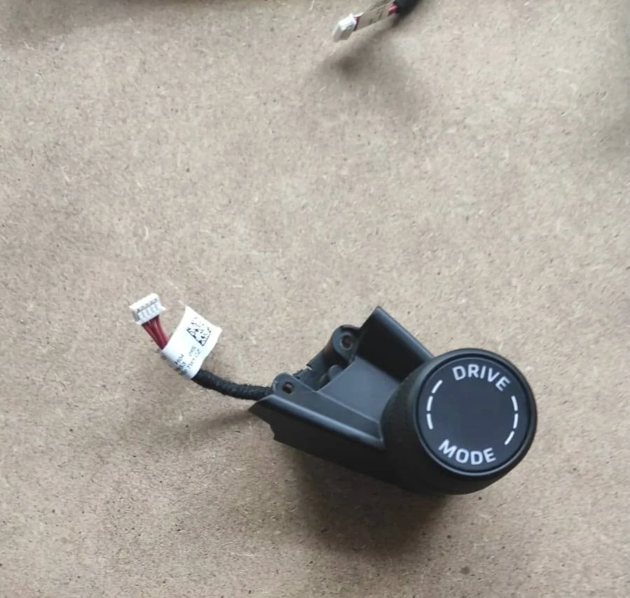

I bought 2021 Taycan 4S without the sport chrono package, I bought the mode switch from outside. I plugged this part into its socket in the steering wheel, the button lights turn on, but when I turn the button left and right, the driving modes do not change. how can i solve this problem.
I doubt this post. Not sure the switch knob has backlighting, correct me if I'm wrong.
Does anybody know whether it is actually possible to retrofit the switch AND connect the switch's cable on a car/steering wheel without sport chrono? For sure the plastic trim ring (just underneath the airbag) needs to be cut which is prolly easy.
I bought a switch (120 USD) off of eBay but my mechanic friend told me he couldn't mount it on the steering wheel nor connect the 5 cm cable anywhere?
Furthermore I also bought a sport chrono clock (250 USD excl shipping, VAT, customs, etc) from China. Identical to the OEM, but with backlight unfortunately. I only realized the lighting after installing the clock. Pretty stupid as it doesn't look OEM and also reflects in the windshield (just like head up display). Gonna to try to disconnect the backlight if possible.
Retrofitting the dash chrono isn't easy as the MIB3 in the Taycan is lying on the chassis underneath the dashboard so a lot of work to rip out half the interior before reaching it. Needed simple coding to work I believe (didn't do the job myself obv).
Looking for any advice or help to figure out:
  1. Is it possible to retrofit and connect a switch knob on a steering wheel without SC from factory?
  2. Should I rather order a new steering wheel harness to be able to connect the switch knob?
  3. If not, should I simply order a "new" steering wheel with the knob already mounted from a Taycan rwd/4s/gts/turbo? Would that then also be plug and play? (Except PIWIS conf ofc)

Still working on solving this. Someone told me that the control module in the steering wheel (170 USD) needs to be replaced but I doubt that, only found one product code for the module for all Taycan variations (4S/RWD/Turbo etc). The trim needs to be cut or replaced. Gonna try end of this week to see if it can be mounted on existing steereing wheel and plugged into existing module.

So seems as if the steering wheel controle module (also called control unit by some people) only has 1 product code. Removed the airbag today and the metal plate separating the control module and the airbag. However, it isn't possible to remove the plastic trim between the airbag and the wheel (airbag | trim | wheel). So currently seems as if steering wheel needs to be dismantled completely, then cutting the trim (or ordering new trim)..... Keeping you posted.
