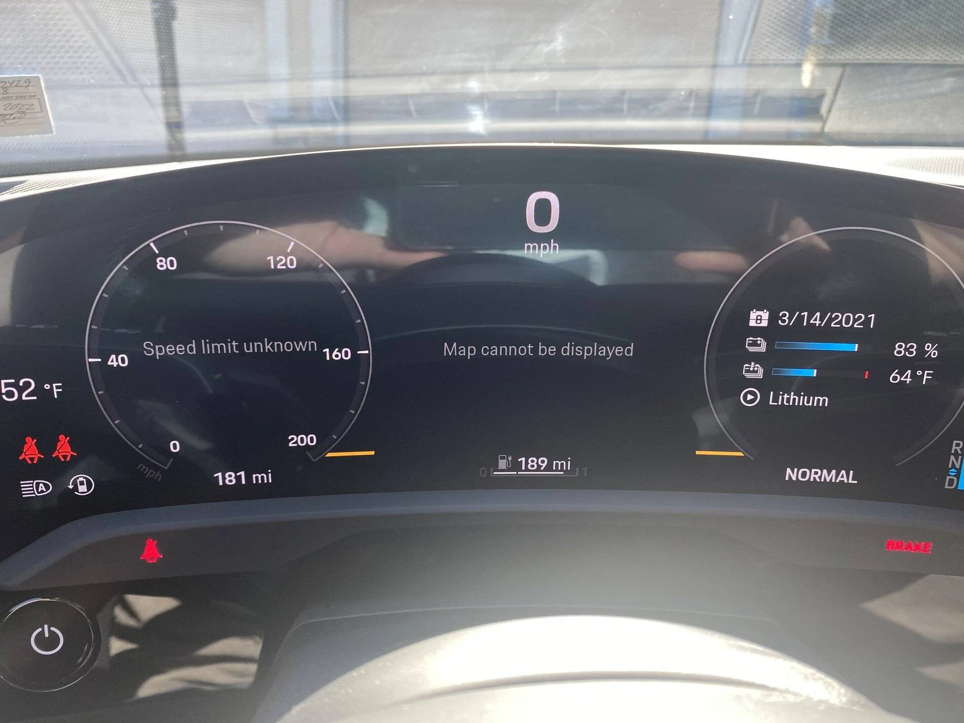

Took delivery of my 4S last week and the navigation works fine and the map siplays on the center display. When I try to engage the map on the center of the instrument cluster is says “map cannot be displayed”
Appears that folks may have experienced this before. Is there a way to do a reset?

I'm guessing this is a communications issue between the PCM and the instrument cluster. Turning the car off and locking it for 15 minutes may resolve this, though I'm guessing you have tried that already. 12V disconnect might also solve it, but might cause other issues (minimize the risk by doing the 12V disconnect 15 minutes after the car has been shut off).
