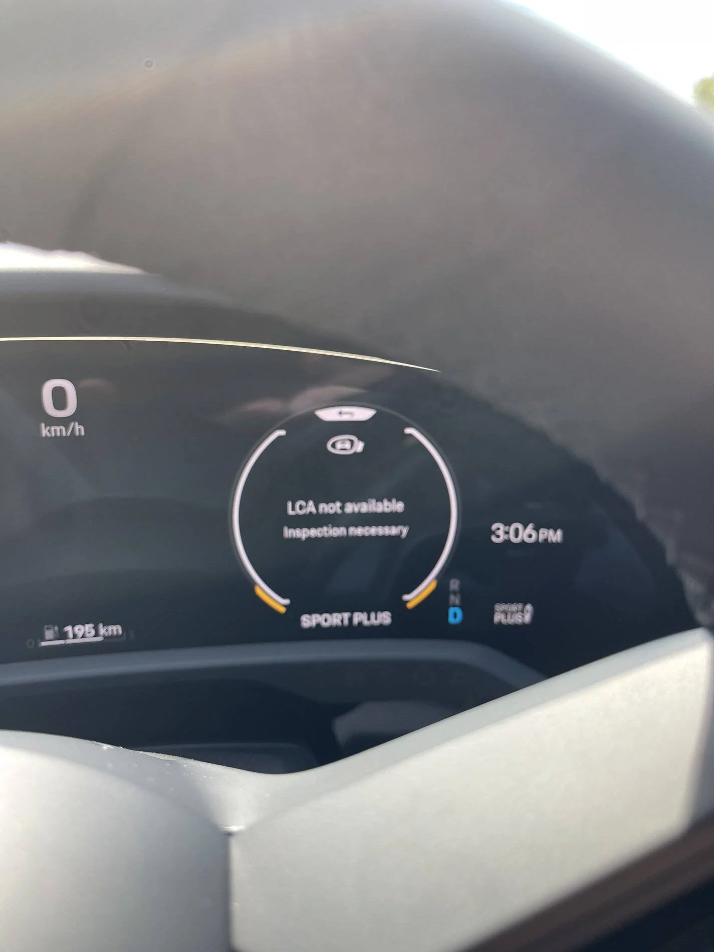

Hi, I just received my Taycan 4s in Melbourne Australia on Saturday and now all screens are no longer working. Is there a way to turn the central screen and the haptic screen back on? The car still drives fine however but with no digital screens and also “LCA not available” is appearing as a fault code. Also I can’t control the features of the car due to the screens not working. Would appreciate some help please and has anyone had a similar experience?

Thankyou very much. This has completely fixed my problem. I really appreciate your help. I’m just trying to work out how to set and use the auto lift function over speed bumps and driveway and also to setup Porache connect with my mobile phone.
