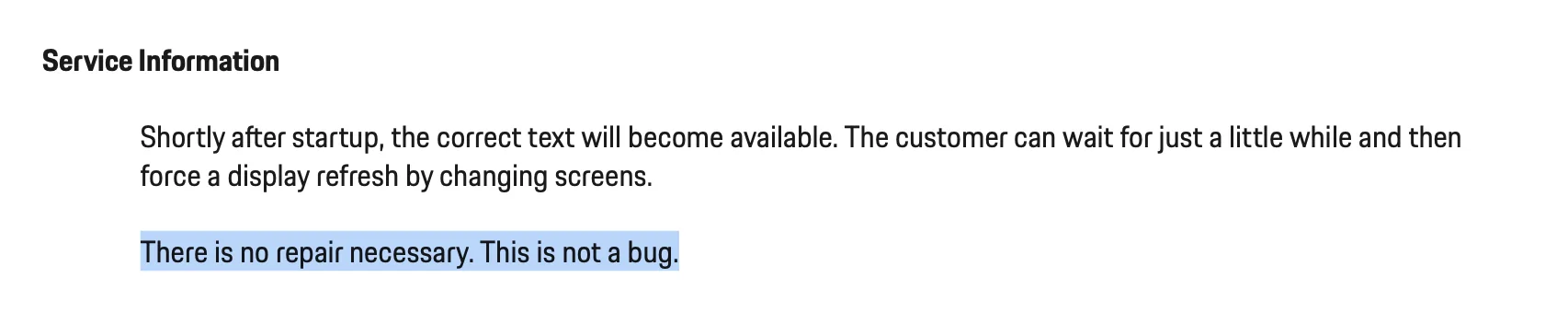

Whenever I saw that I thought to myself "your developers Zeil Sucken."
The best was when they decided it wasn't a bug because it was too hard to fix ?
that german phrase in the search bar is only a very basic symptom of how many of these PCM bugs root caused:
the car want's to sync something with the back end and fails.
This can be either car being in no LTE reception area like underground garage or Porsches Backend is struggling, both is very likely.
And there is no healthy cache strategy how to deal with this situation, retry, reconnect, use cached data etc.
I really pray they will have that improved with VR19.1 as I am not really looking for Spotify or colors but for stability.
