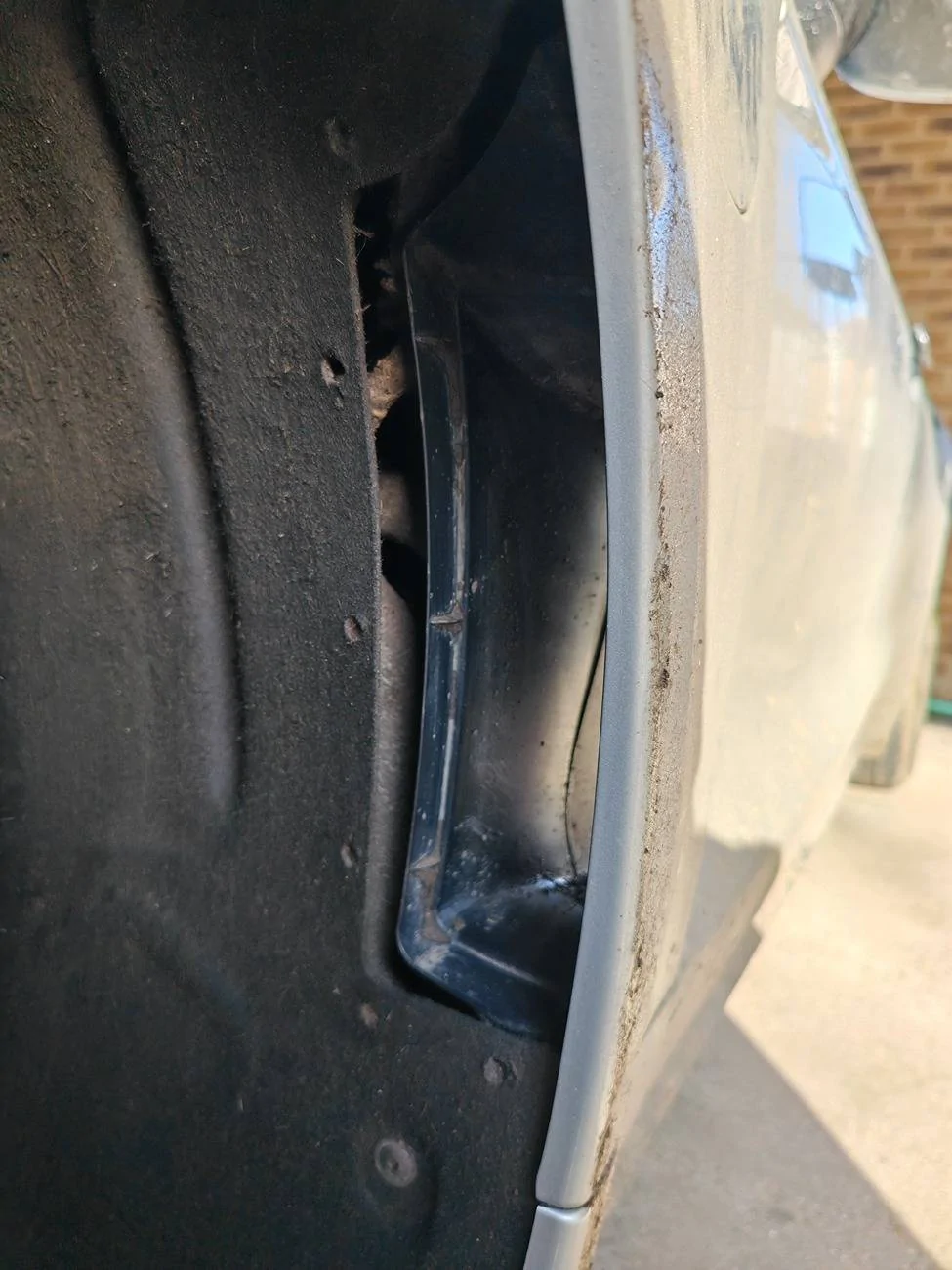

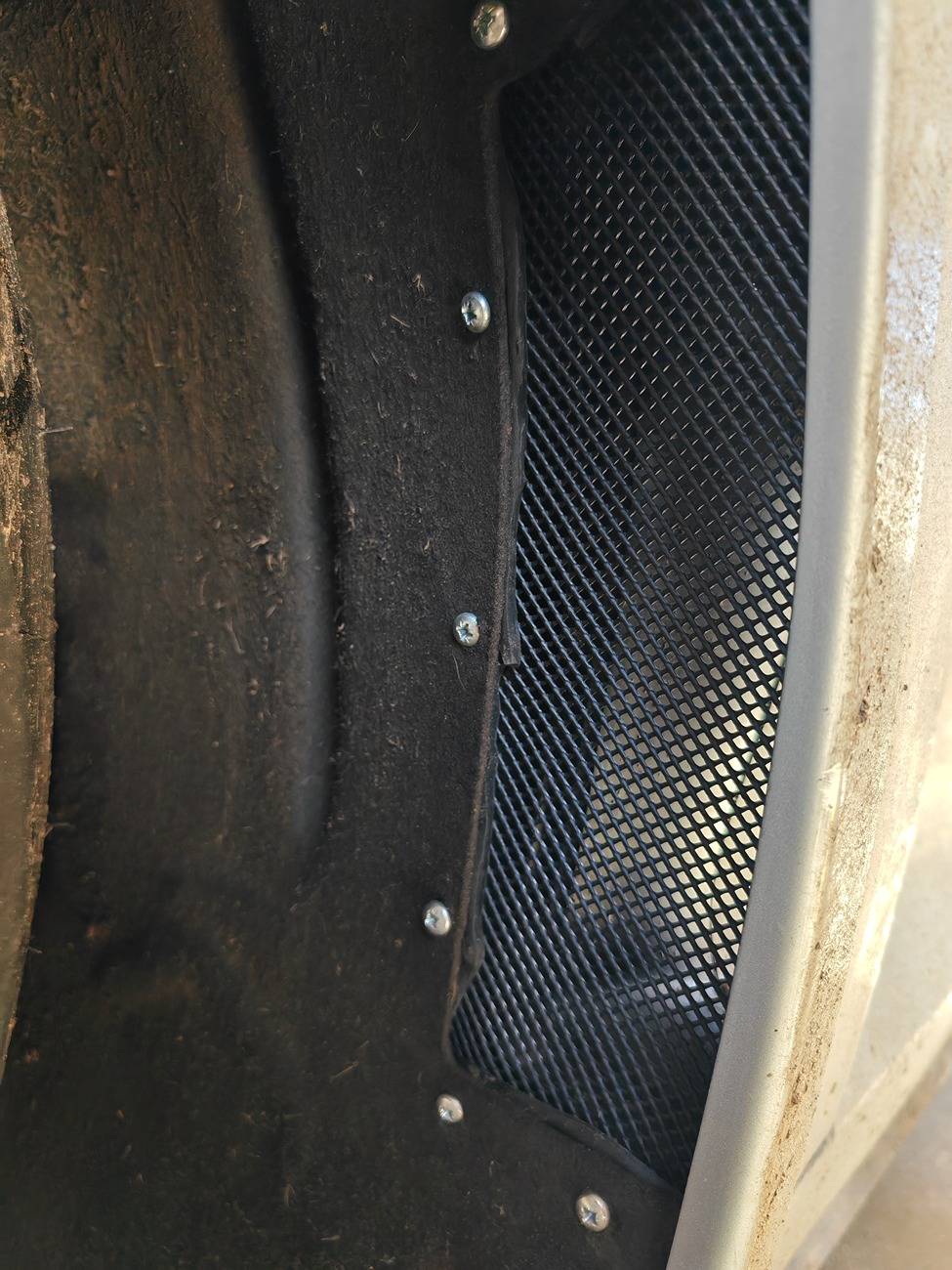

This thingy has fallen off my Taycan and for the life of me I can't find the damn part number (nicked it off another post)
Anyone know what the plastic arch liner vent is called? Mines the unblocked one. Manual power socket thingy, so mines just open plastic

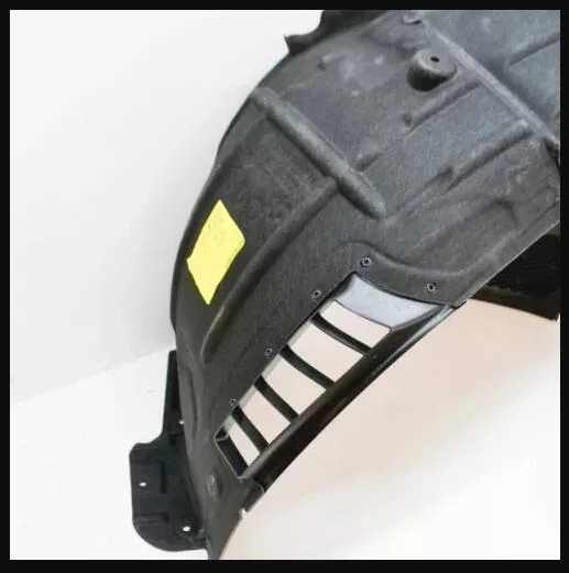

On my 22 4S without powered charge ports the "vent" is part of the wheel housing liner (9J1 810 908D and 9J1 810 907D (left). The vent has only the horizontal ribs, no screen like what you have pictured.

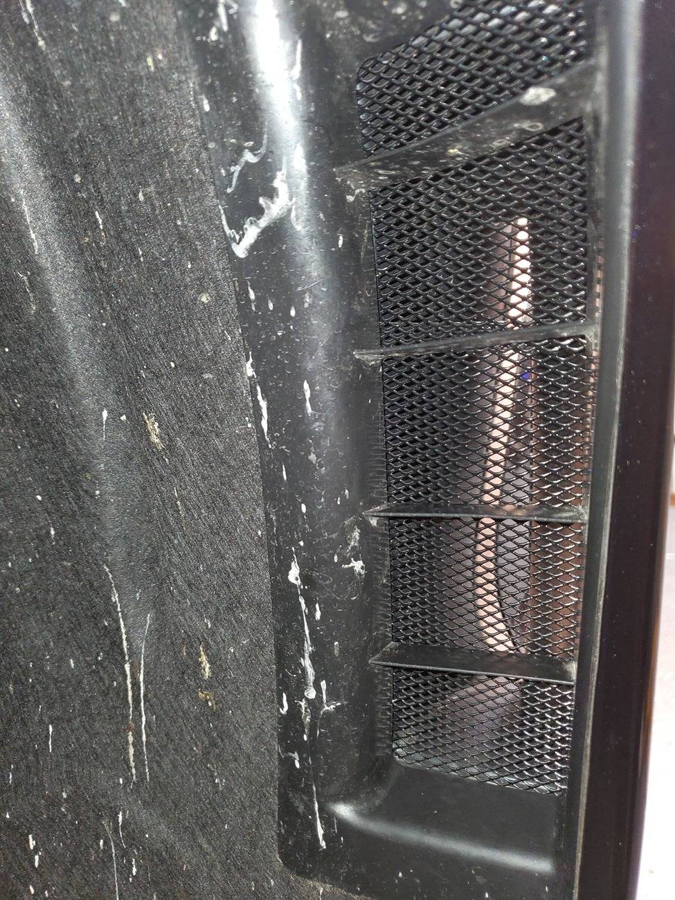

I suspect the screened vent in your photo is either 3rd party add-on, or Porsche redesigned the vent/wheel liner in later models (unlikely).
Looks like your photo came from some DIY forum posts where owners purchased screen and manually inserted it. Is your car missing the screen or the ribbed vents?
If you search for the part number online, you will find this photo on ebay which shows what is on my car. I cannot find the 'vent' as a separate item (from the wheel housing liner) on Porsche parts diagrams. Wheel liners are about $250 USD. Installation cost unknown. Good luck.
Nah it's just that vent. Damn full arch. Might just make something myself then. Thanks

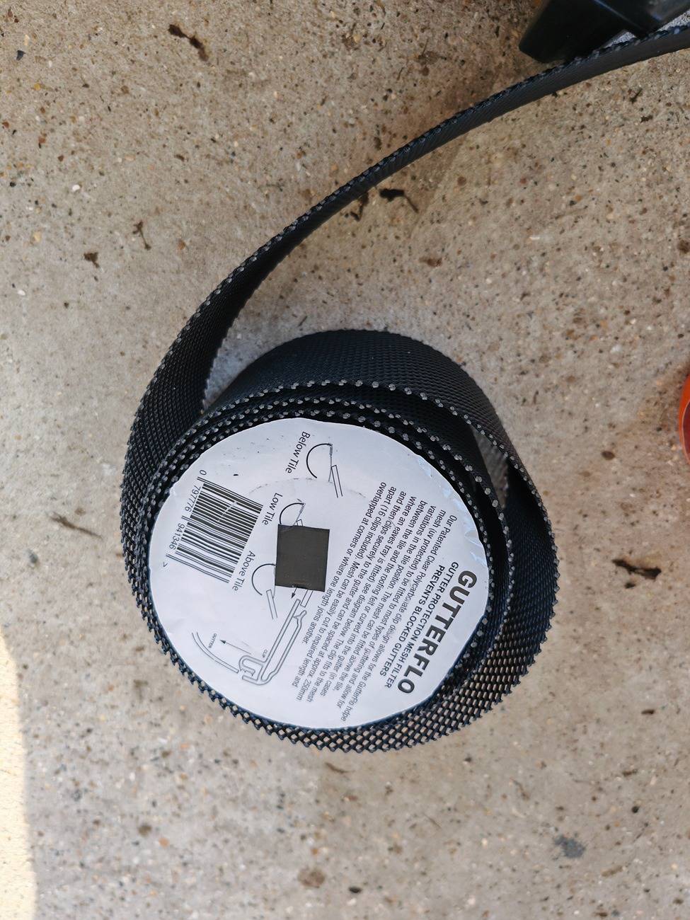

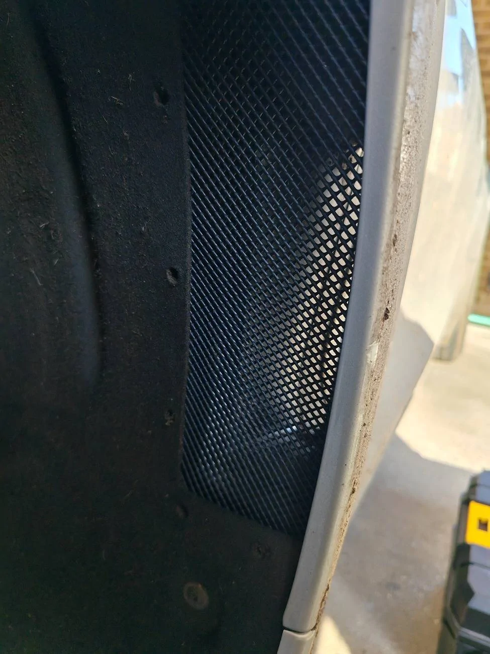

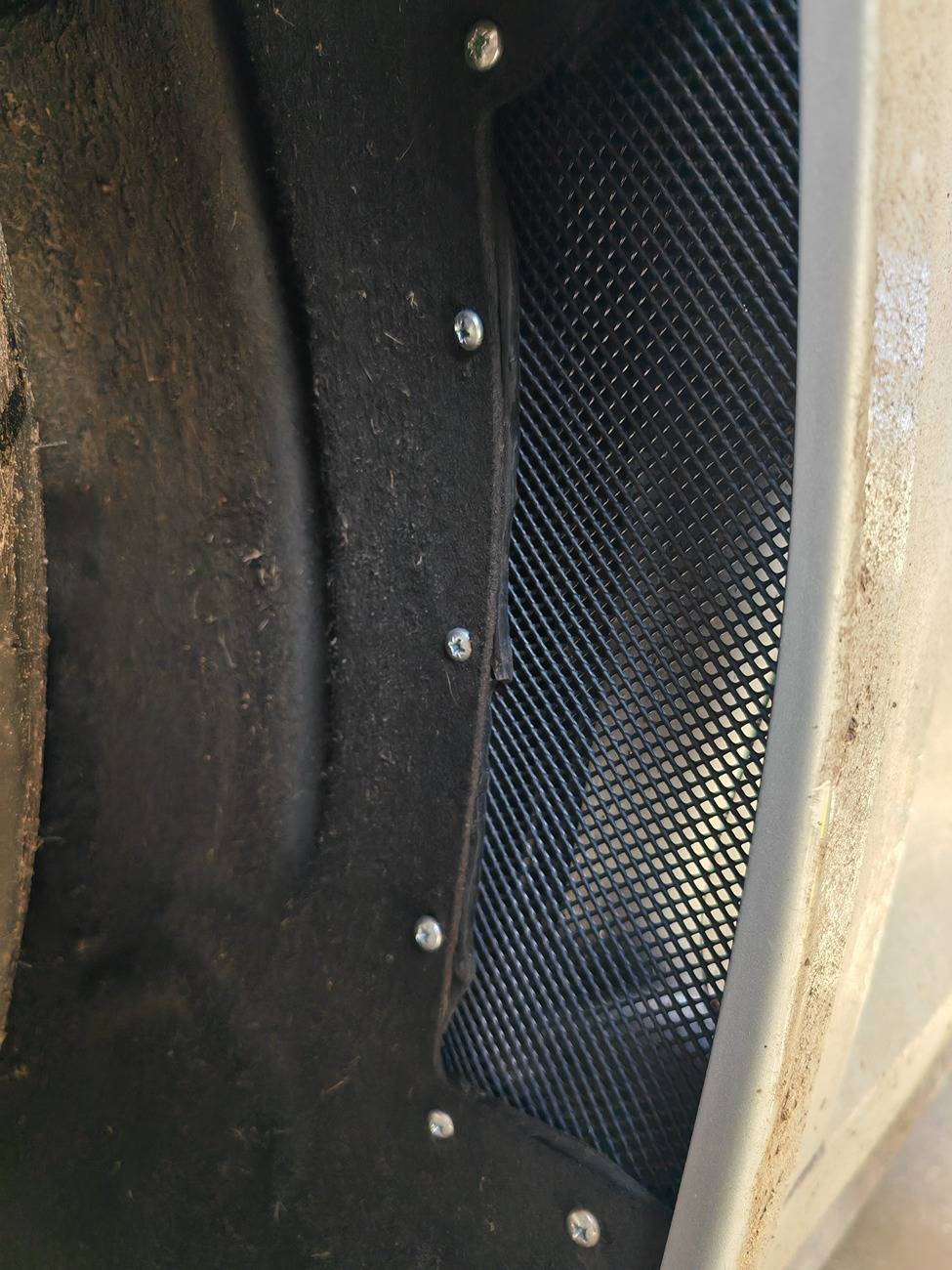

I used a gutter mesh, self tapping screws and some self adhesive tape as packing and sealing. Gonna see how it lasts and might just do the other side.
