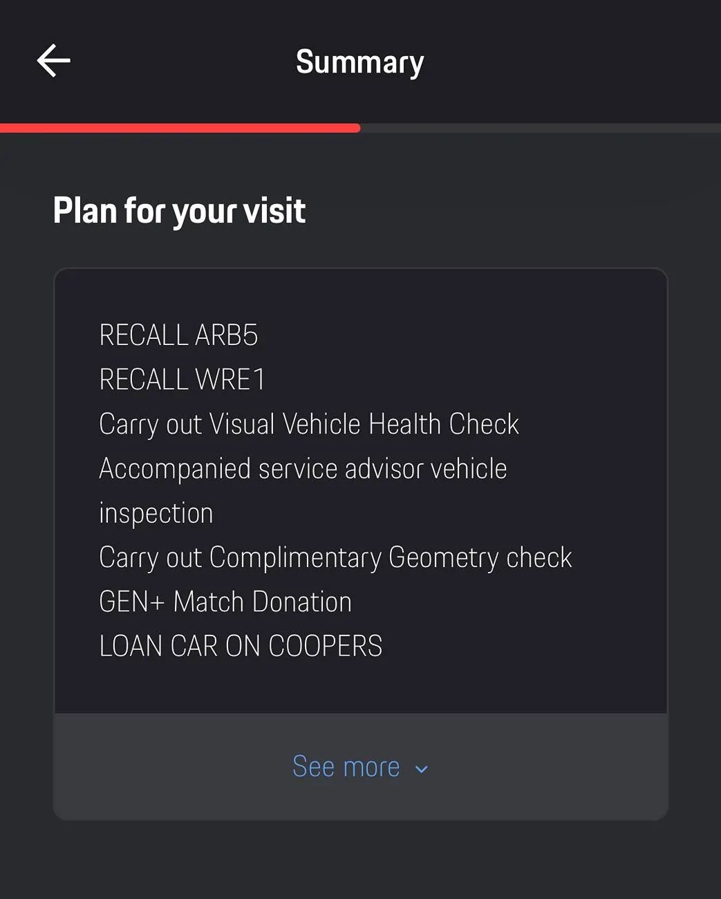

Got the link to check in online as the car goes in tomorrow for the ARB5 recall. Noticed that it also mentions WRE1 which wasn’t mentioned in the letters. Anyone know what this one relates to? Presume battery modules also.

Car returned after 3 weeks with recall work completed:
WRW1 - Reprogram external communication control unit (OTA-FC)
WRE1 - Replacing cell block module on high-voltage battery (33)
Trying to get any info out of the service tech regarding what was done, how many modules affected etc. was like trying to get blood from a stone, so no idea what has been carried out. Also no mention of ARB5 which was the one it was in for (presume this is covered with WRE1).
I can now charge to 100% though and seems like three weeks was a pretty good outcome.
I checked the battery SoH before it went in and after I got it back, just out of interest to see if anything was different following module replacement. No change.

ARB5 is the recall campaign, and WRE1 is the action item of the recall campaign.
Aka, under ARB5, they took the action WRE1 for 1 battery module, the one with the number 33, and replaced it.
That involves opening up the battery enclosure, replacing the module/s, resealing the enclosure, doing pressure test, and load balancing of the modules and reinstalling the battery to the car chasis.
