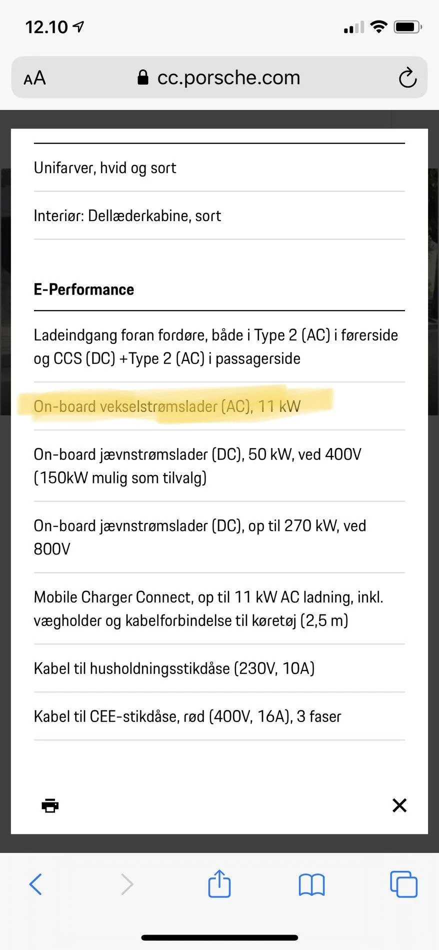

I've read numerous articles and technical specs, however, I'm still confused: Is the current version of the Taycan limited to 9.6 kW charging in case AC is delivered to the car or does it charge at 11 kW? Some articles state, that the current onboard charger can do 9.6 kW at maximum, which would mean, that even with 3 phase AC current, the Taycan would only charge at 9.6 kW. Is this correct?

I’ve been told the car can accept 11kw.
I suspect it might be the charge cable/controller that is maybe limited to 9.6?
If you have installed 3 phase 400V 16A circuit, it gives you 11 kW, which Taycan is capable of. The limitation is which type of circuit you have or install.
