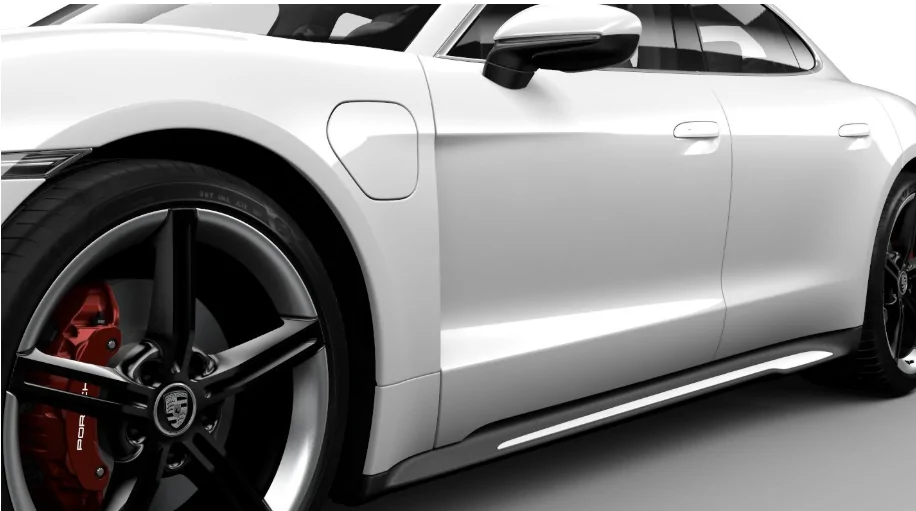

If you look on the configuration tool under the sports design side skirts.. it shows the following...
Using the occasion - does anyone know or has on his / her car such black&silver caps on his / her mission-e wheels? I still neet to purchase them and it'd much easier to have the part number or at least some VIN number of a particular Taycan that does have such caps.

Are they not the standard ones? The coloured ones are optional I think?

Possible. I ordered them as a second set of wheels and they come without caps... I need the part number or a VIN of a car that has them to order them.

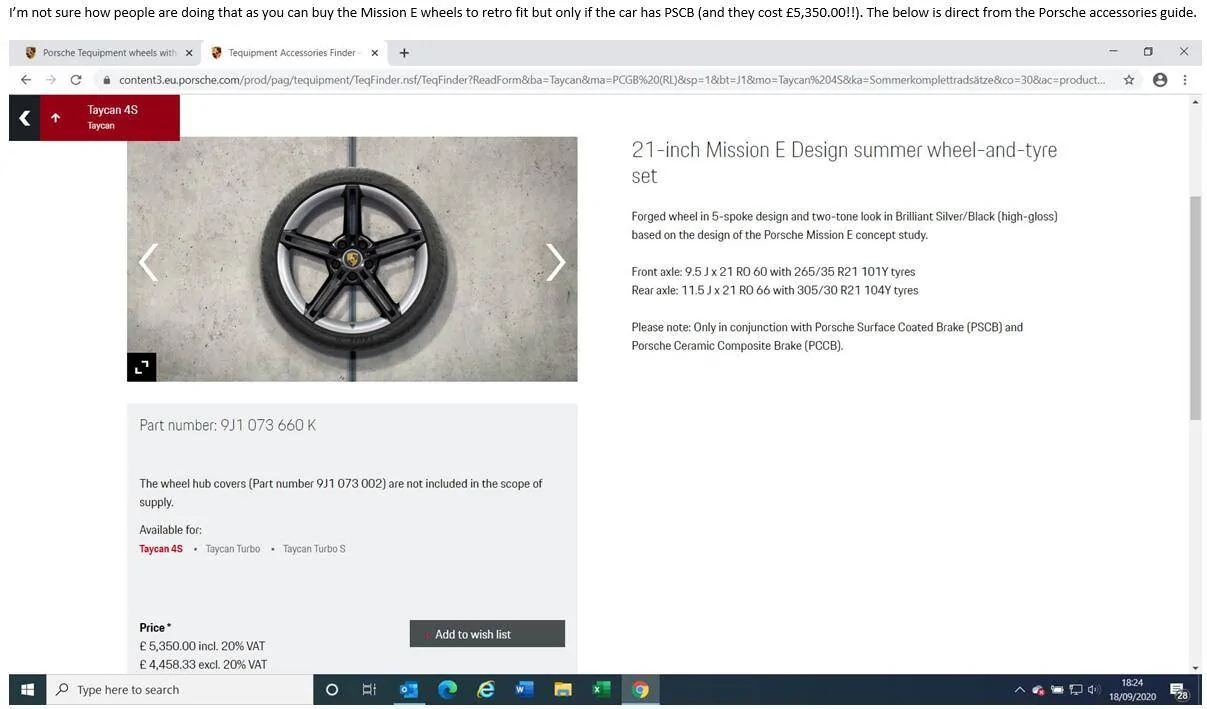

Damn, this has put a spanner in my works. I LOVE those wheels, but am reluctant to pay the £5,100 difference for the wheels and mandatory brakes as seen on the configurator.
Will email my dealer now to see if it's possible and feedback here

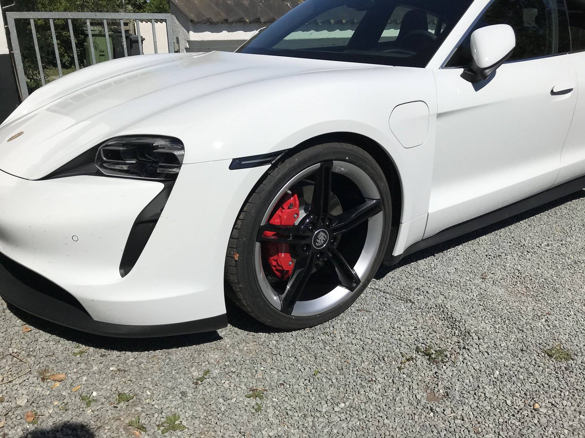

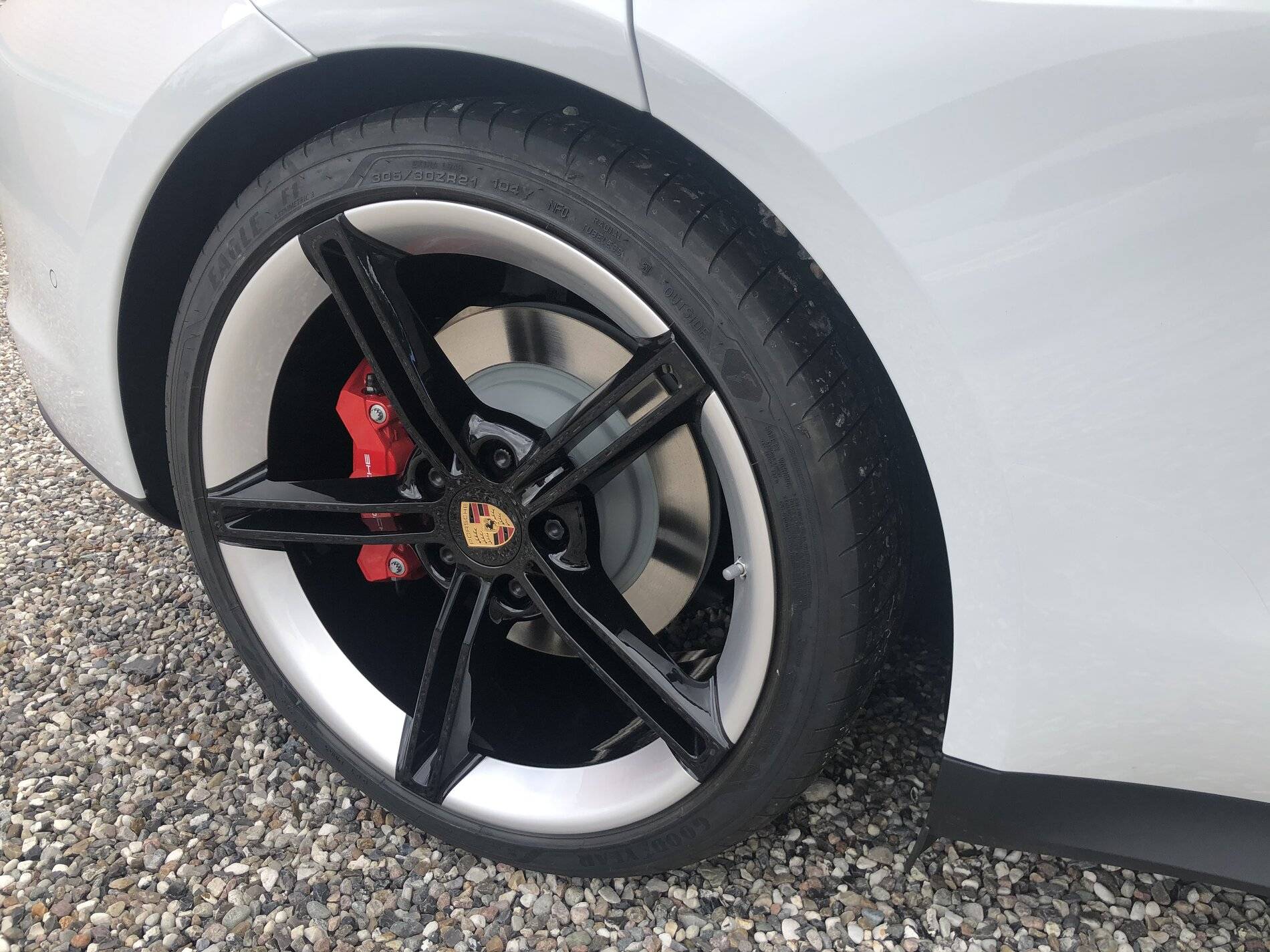

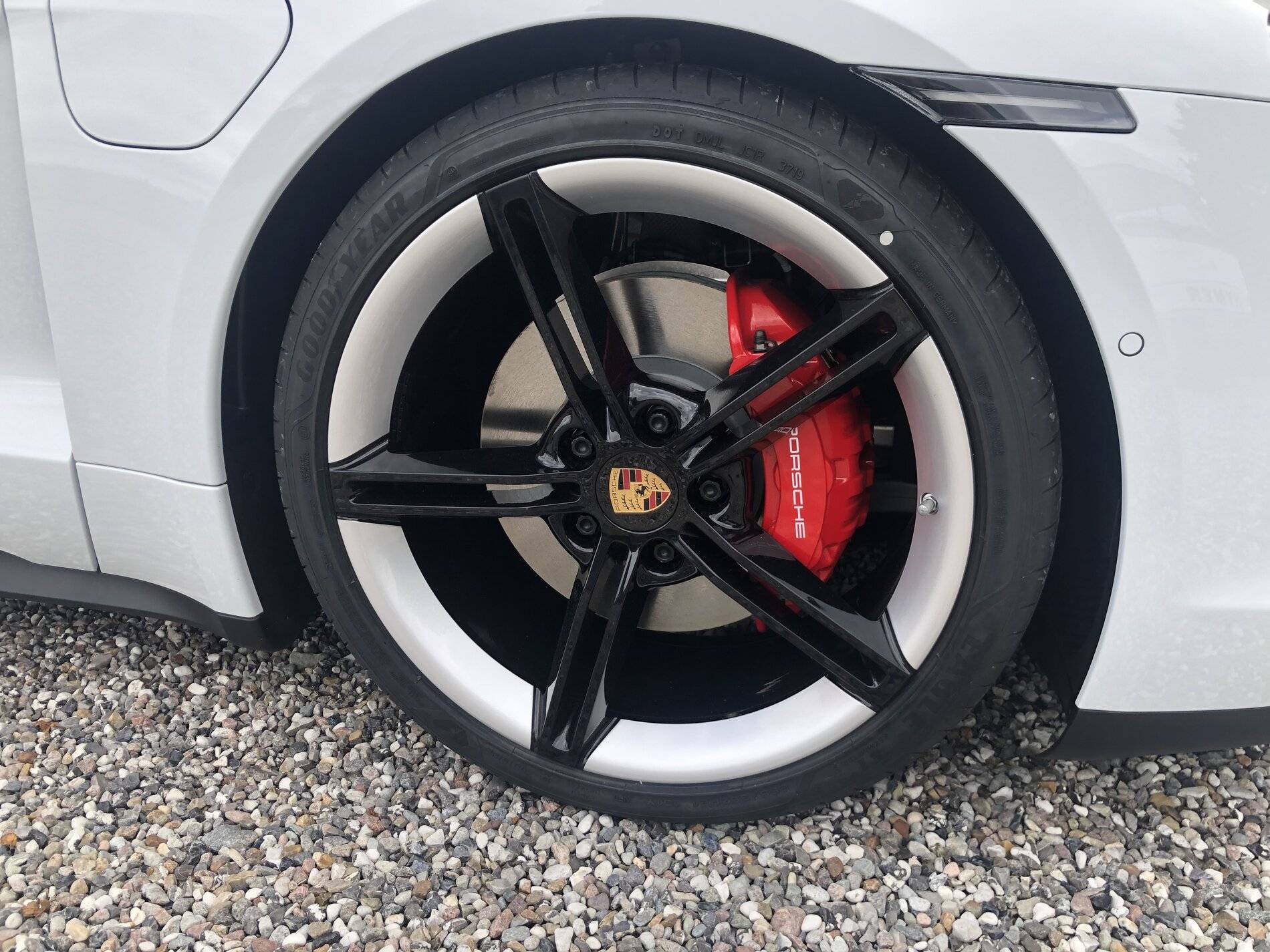

I have no problem at all, no noise or other issues!
How much was the wheels on their own, if you don't mind me asking?
And did you get them directly from Porsche?
Would like them to fit them upon collection really.
Porsche Taycan Mission-E wheels fit Taycan 4S with the standard brakes? f0e3bca1c3e6d16f2ca49d442a2e7e14
His response. Seems like the wheels alone are more expensive than the brakes and the wheels from the config?!
