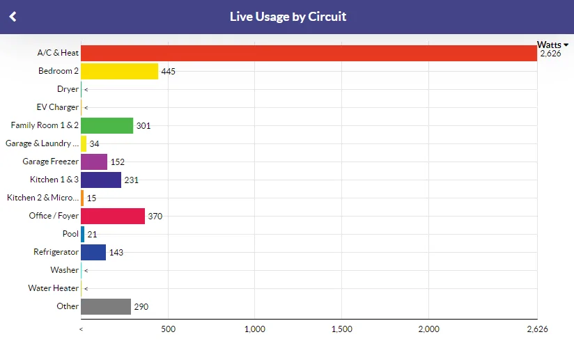

Yes. Unlike the Sense system, Curb has multiple clamps which you put on the circuits you want to monitor. Here's what my home is doing right now.
Porsche Taycan Monitoring charging power consumption 1585441682932
When I'm charging the "EV Charger" spikes up to 9-10kW.
