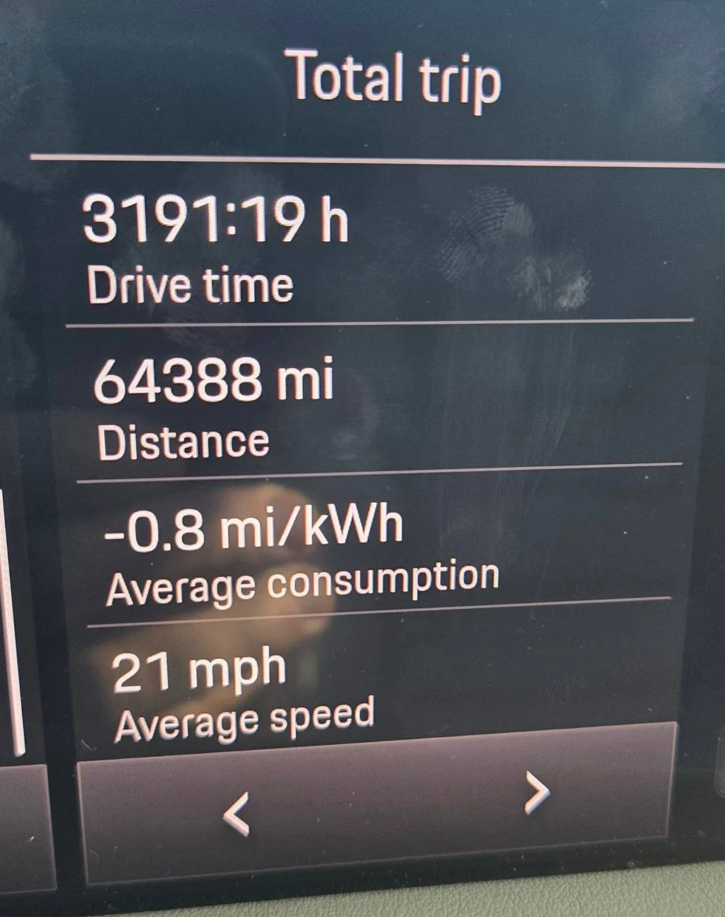

According to my car, the total average consumption is -0.8 mi/kWh!!!! Amazing, how braindead the software is, put out by Porsche.

Interesting puzzle.
Looks like it might be representing the trip odometer distance internally as 1/32768ths of a km, stored in a 32 bit signed integer. That would allow a range of -2**16 km to +2**16 km.
64388 mi -> 103644 km
103644 - 2*(2**16) -> -27428 km
-27428 km -> -17042 miles
-17042 miles / (-0.8 miles/kWh) -> 21032 kWh
64388 mi / 21032 kWh -> 3.06 kWh/mi
Is your efficiency around 3.1 kWh/mi?

The actual efficiency is somewhere between 2.5 and 3, I think
