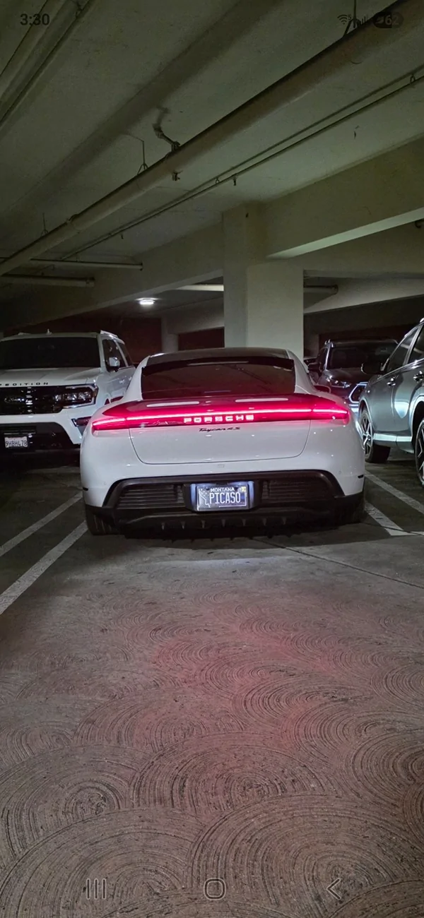

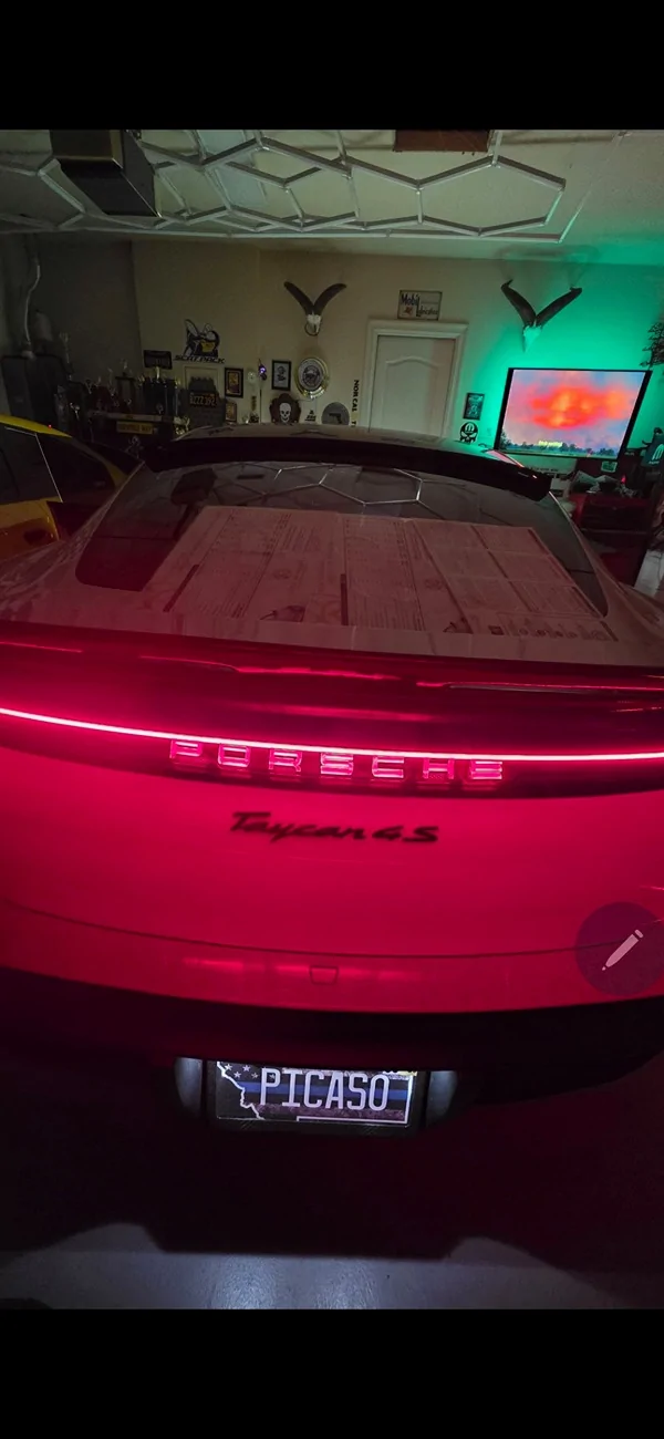

My Taycan 4S is a 2020. I found a company on ebay out of Lithuania. Im not sure if they are still selling g on there or not??
It was a simple plug and play on my car. You can't even get these in the States that I know of???
So yours come with that middle light and it started malfunctioning??
Shouldn't that be covered under the Factory Warranty???

Oh that Sucks...
He told me this was a Factory Taillight off of a European vehicle.
It looked 100% Factory too me. I didn't see that the cracked it open or anything??
That's a real Bummer because pulling that Rear Spoiler is not a simple easy task. Putting it together is a real pain in the Ass...

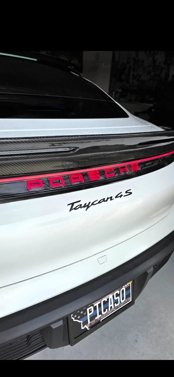

I checked my taillight out tonight and I don't have the welcome/leaving mod on it. Is there a way too make that happen??
