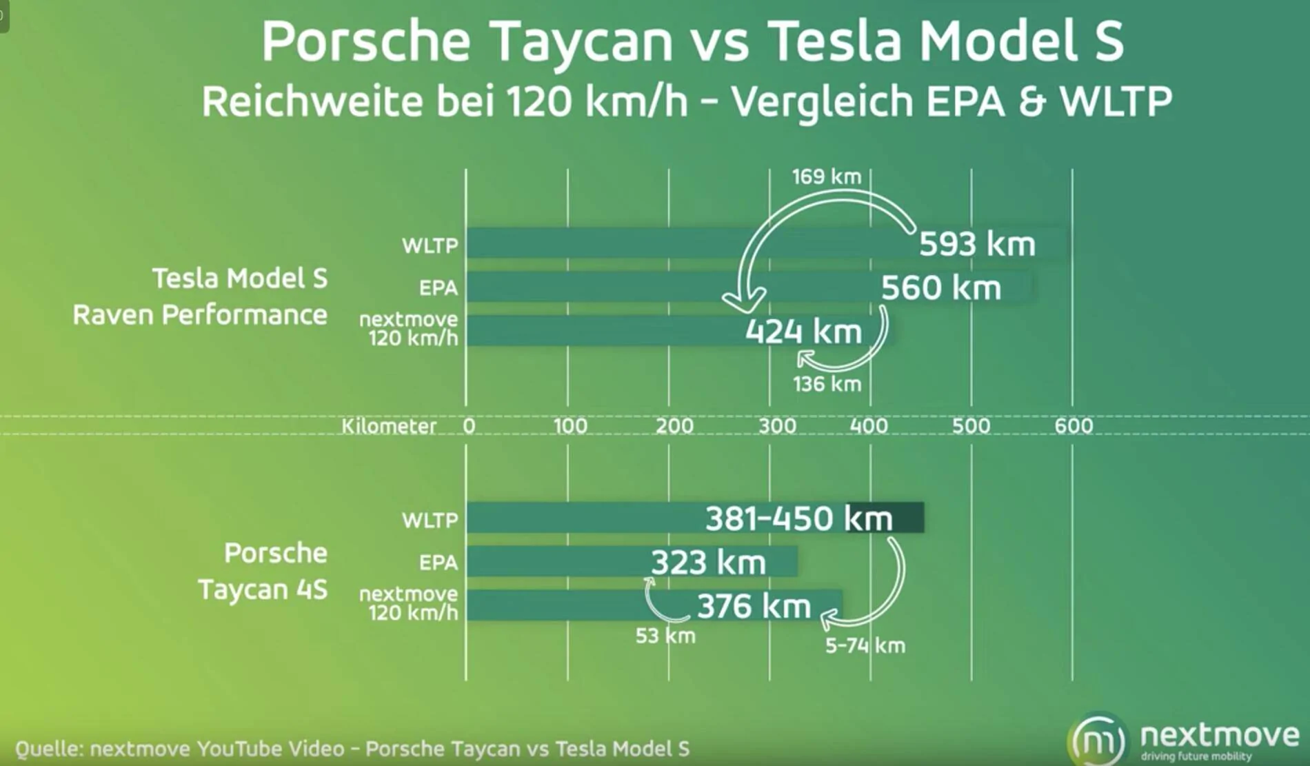

Here is a nice summary chart from 21:55:

Ron, for a non-engineer like me, can you analyze and interpret this chart? From my layman's perpsective, it looks like the Tesla, as expected, kicked the Taycan's butt. However, it didn't do as well as the EPA said it would and the Taycan did better than the EPA rating (consistent with many reports on TacyanForum). I don't know what WLTP means.
Anyway, your thoughts and expertise is appreciated.

Note that the analysis in the graphic reports the EPA range as 323 km or 201 miles. That is the EPA estimate for the Turbo, we do not have an EPA rating for the 4S. So, they are calculating how much the 4S exceeds the EPA rating, but they are not using the appropriate reference. Hopefully the EPA rating for the 4S will be 10-20% higher than the Turbo, but only time will tell.
They noted that the Tesla S Raven Performance was about 10% more efficient on the reported kWh/100km (per the cars computers, they did not actually measure these independently):
Taycan: 23.6kWh/100km = 380Wh/mi
Model S: 21.4kWh/100km = 345Wh/mi
They also noted that the Tesla battery has about 10% more available energy.
They then tried to reconcile why the Tesla's range was only 13% greater than the 4S despite the 10% greater efficiency and 10% greater energy available. They made estimates of the actual energy delivered from the battery, but again, this was not measured and relied on the car computer.
My conclusion from this and other range reports is that the Taycan at high speeds (150 km/hr in a prior NextMove video for the Turbo, 120 km/hr in this video for the 4S, 75 mph in the Car and Driver test, etc.) delivers close to the EPA range estimate and the Teslas (Model 3 Long Range/Model S Raven Performance) deliver less than their EPA stated range, and that the range difference between the Taycan and Teslas is much less than suggested from the EPA numbers. NextMove and Car and Driver also found that the Taycan charges the fastest when using the maximum charging station for each brand (350 Kw for Taycan and version 3 of the Tesla supercharger). So, other than the better built out Teslas charging infrastructure, any range anxiety for long distance travel should be about equal for the two cars.
I will take a shot:
First, there are, broadly speaking, two international test standards for estimating energy consumption of cars:
  • Worldwide Harmonised Light Vehicle Test Procedure ("WLTP"). This is a European test metric.
  • Environmental Protection Agency Rating ("EPA"). This is the US test metric.
Both tests attempt to simulate the driving experience and are different from one another. Even within each test procedure, there are opportunities for variation based on the battery of tests performed. So the chart is showing the expected efficiency of each car under each of the two rating regimes (EPA vs. WLTP) with the top two bars for each car. As you can see, under both regimes, the expected efficiency of the Tesla is greater than the Taycan. What many have anguished about is the significant gap between the EPA and WLTP numbers for the Taycan compared to that of the Tesla. You can see that in the two bars as well.
Second, the video essentially is yet ANOTHER version of a standardized test that attempts to be more "real world" than that performed under either the WLTP or EPA. At a minimum, this is a more relatable test, since you actually get to watch some portion of the test. The result is shown in the bottom (or third) bar for each car.
Finally, the result, which is somewhat surprising, is that the Tesla could not achieve the range predicted by either the EPA or the WLTP ratings, but the Taycan actually beat its EPA predicted range quite handily in the same run.
All of this proves not much of anything, other than:
  • For those of us prospective Taycan owners, perhaps our range experience will be much closer to the Tesla than we expected.
  • The Taycan did not get its "butt kicked" in quite the way that you may have expected. This is more like a two touchdown underdog (-14 points) losing by a mere field goal (-3 points).
Well, that was my attempt.

This is actually quite helpful. Thanks!!!

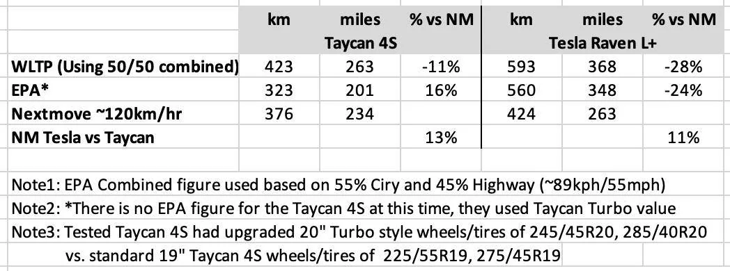

Sorry for the delay in my analysis @BayAreaKen. Lots of other good feedback too. But here is my take.
Porsche Taycan [Nextmove] Taycan 4S vs Model S Raven range comparison at 75 mph 1582587119261
Here you can see what I think is the point of the story. That the Taycan WLTP figures are much closer to reality and also that the Taycan EPA figures seem busted as it betters EPA by 16% on this test and by range figures on other reviews like: Motor Trend, Dan Edmunds at Autoblog, Next Move and Tom Moloughney at insideEVs. All showing Taycan fires more like 250 mile range, nothing incredible but nothing despicable either. It is a performance car, not a lean machine for distance.
From the Nextmove test you can say either
  • the Tesla Model S Raven L+ had 13% more range than the Taycan
  • or the Taycan had 11% less range than the Tesla Model S Raven L+
    (depending on your choice of denominator)
I would not label that as Tesla kicking any butt. ;) Just state that Tesla does exhibit measurably more range in these conditions.
You can also say that the Nextmove higher speed test showed the Taycan was only 11% off of WLTP where as the Tesla was 28% off???
EPA figures Reference: https://www.edmunds.com/fuel-economy/heres-why-real-world-mpg-doesnt-match-epa-ratings.html
WLTP Range Figures from: https://www.porsche.com/uk/models/taycan/taycan-models/
