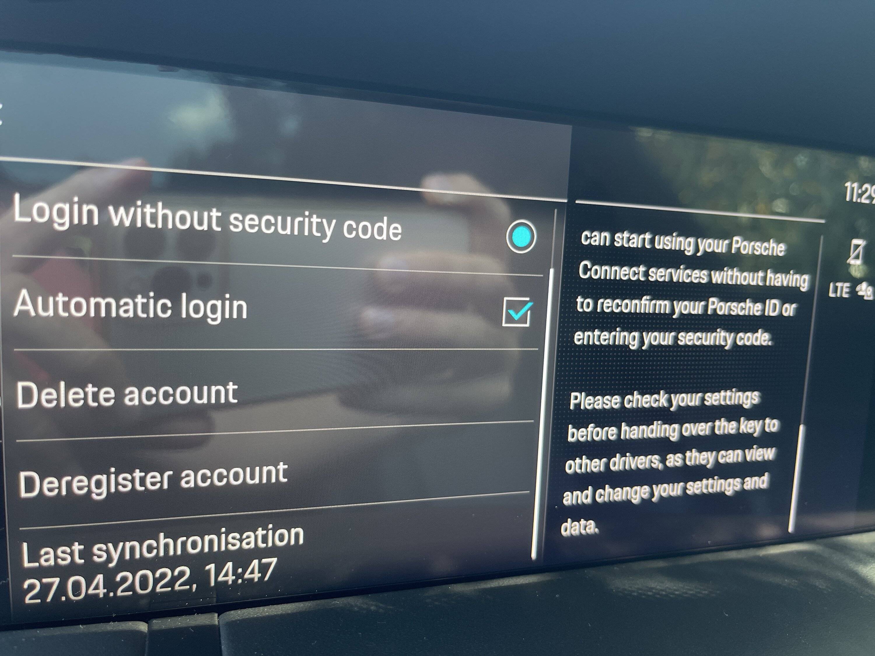

Hello guys!
I want to log completely out of my account in the car, to then log back in, do I choose ‘Delete Account’ or ‘Deregister Account’. I guess the 2nd one is the correct choice, but asking just in case.

Don’t do it! I did the same and now I can’t get back in except as a guest.
I’m not sure, and I can’t check now I’m locked out, but that last synchronisation date looks familiar. I think my last sync date was the same. But as I say not sure.

Oh, what a shame, I did that and then saw email notification from your post ?. Haven’t tried relogging back yet, but I suppose I will have the same issue as you. It’s likely that the reason for you problem are the servers, just like it being the reason for the recent connectivity issues discussed in other threads.

It got fixed at 9th of July for me. 2-3 hours before it got fixed, I had tried the 12v battery reset fix. I don’t really know if the battery reset was the reason that it got fixed or it was just a timing coincidence and it just happened that at that moment the servers were fixed.

I agree. Server side bs. Mine was "offline" from July 5 to 12, then back from 12 to 15, now offline again. Went for service in the meantime but they could not fix it (and it's one of the main Porsche dealer in my country, I counted 19 Taycan on premises that day whatever they were there for).
All they said - sadly - is to "delete" the account not deregister, as it might require the re-activation on Porsche side, and stubbornly keep trying to log in at intervals. Many times it won't work and you will have to use the car in guest mode, but eventually it should . it did for me and stayed online for a few days.
ps. if you don't delete the account from PCM, you will not have remote access to the car anyway (only the local PCM settings are preserved)
