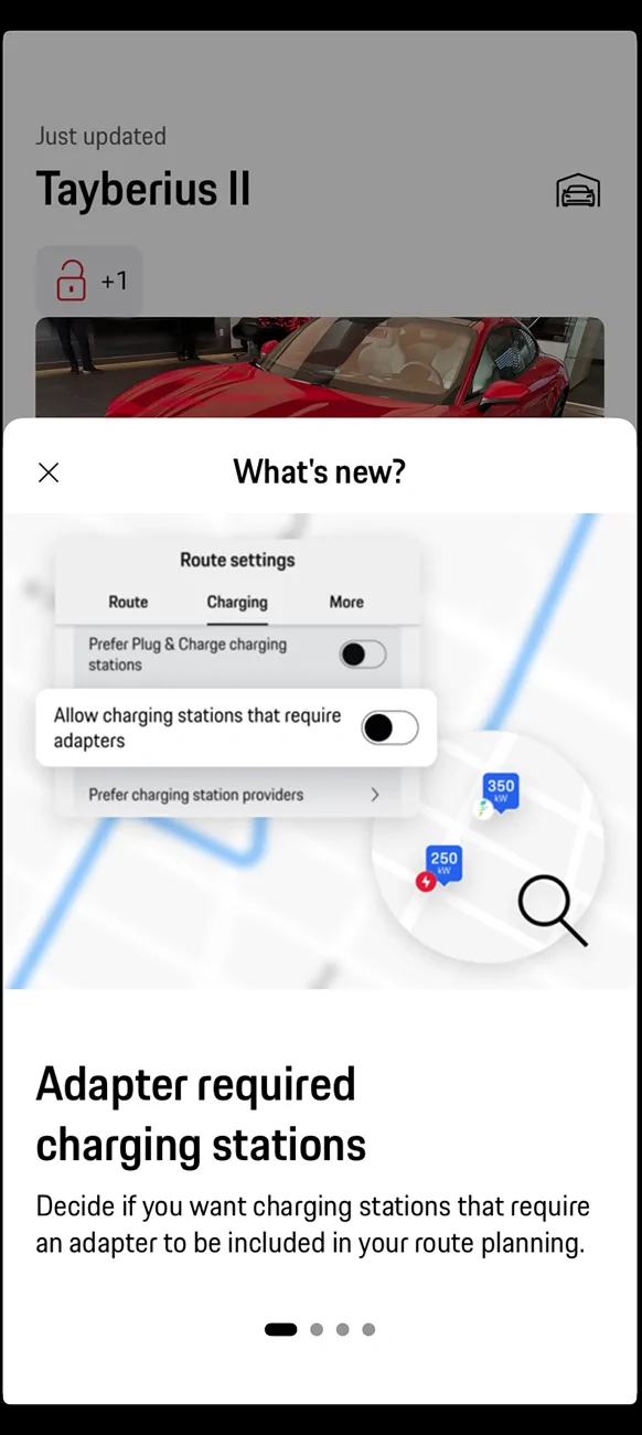

I also picked up an adapter at the dealership when My Porsche App reported none available...

I did ask the dealer about the adapter but no one knew anything about it. Started to think it was a myth myself. Would love one to keep for just incase.
Also take it you still need the Tesla app to charge
