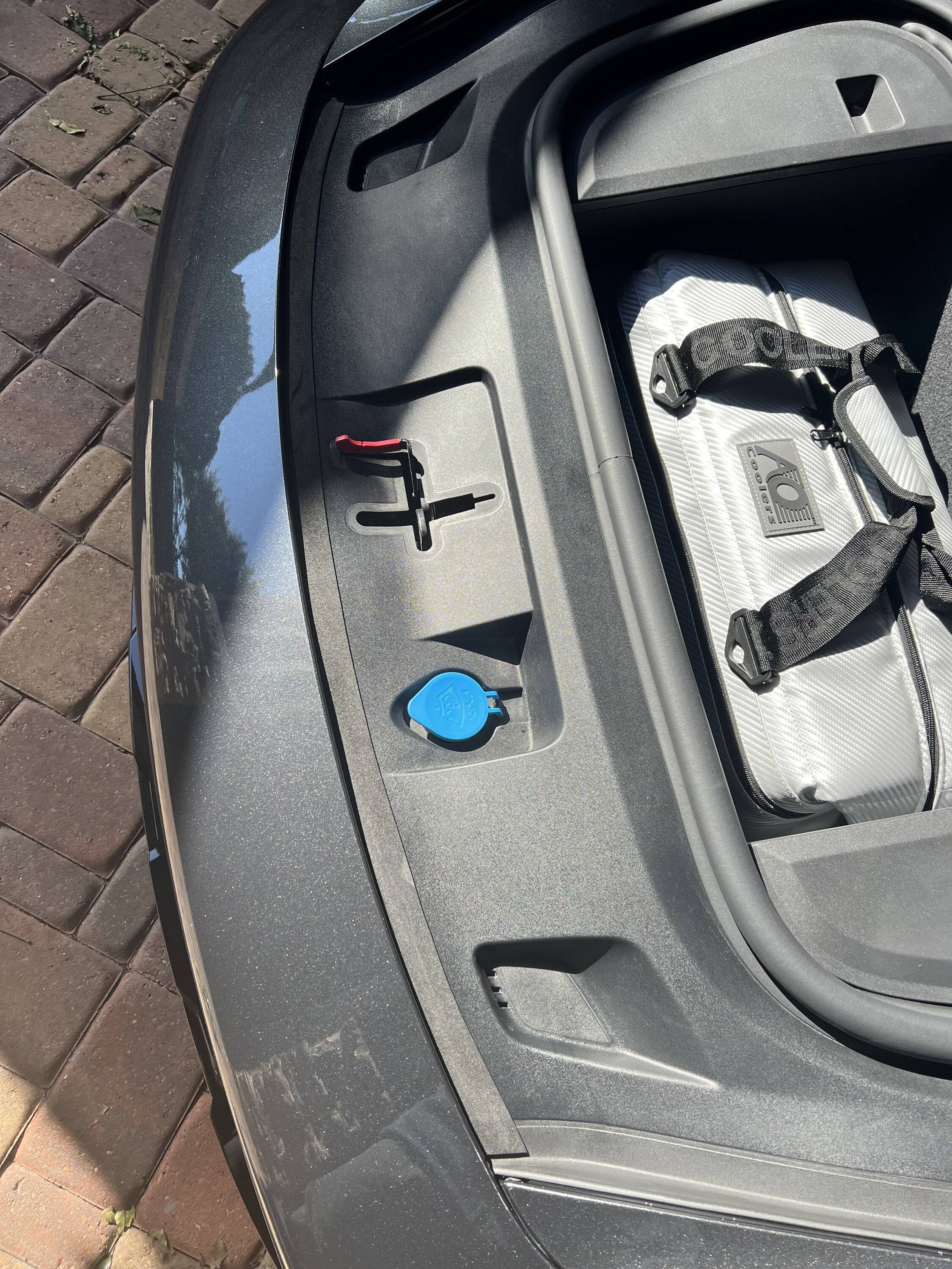

Guys , this worked to fix my whistling issue which has been driving me crazy. I am so happy with my car now. Thank you all very much!

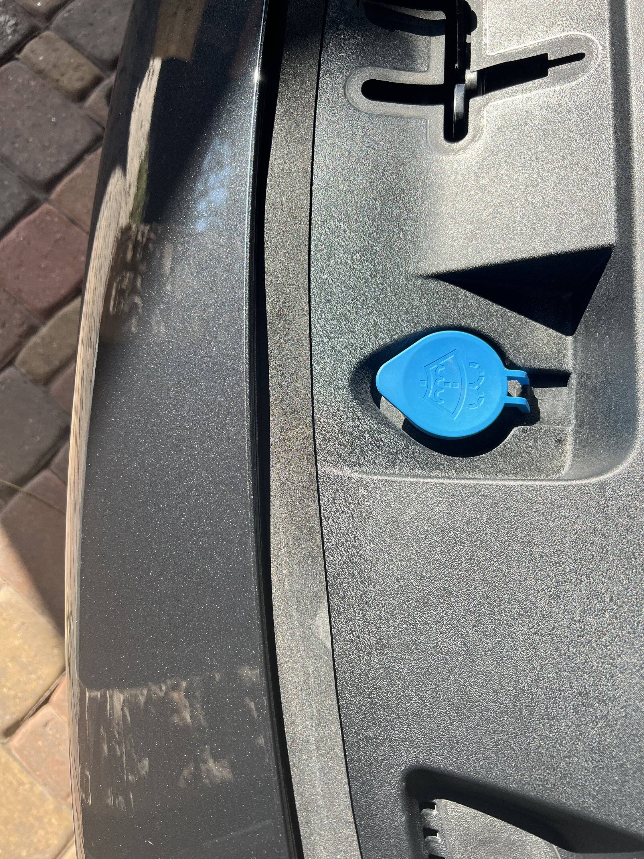

I also have this problem. Does the weatherstrip leave glue residue on the plastic if later removed?
NFBJRD
Jul 23, 2022
SF Bay Area
'23 Taycan GTS
I just installed it so I can't say for sure it doesn't leave residue, but I can say that the adhesive seems pretty weak so it seems unlikely. Need to take the car out for a drive in a bit to see if it helped with the whistling noise...

Update: took the car in for service. Tech confirmed the noise, and fixed it by adjusting the hood alignment. My SA said they had a few Taycans for the same issue, and thought a TSB may come of it.
If you have this, it is fixable!

Forums are such a great resource! I too have the whistle noise with my ‘24 CT4S and it’s very annoying. Glad I searched and found a solution.
Not sure if I should just wait and get the hood realigned when I eventually bring in for the countless recalls, or just add the tape now.

Recently purchased my CPO Taycan GTS 23 and the whistling noise was so annoying sometimes I could hear it over the music playing. Took it into service and they noted they resolved it and no noise was heard anymore. Picked up the car and heard it immediately.
Found this forum and this fix. ordered the tape, was a little skeptical with the thinness but it worked perfectly! Did some light driving and spirited driving and never heard it again! I am amazed at such a simple and easy fix! After that I am hooked to this site!!!
