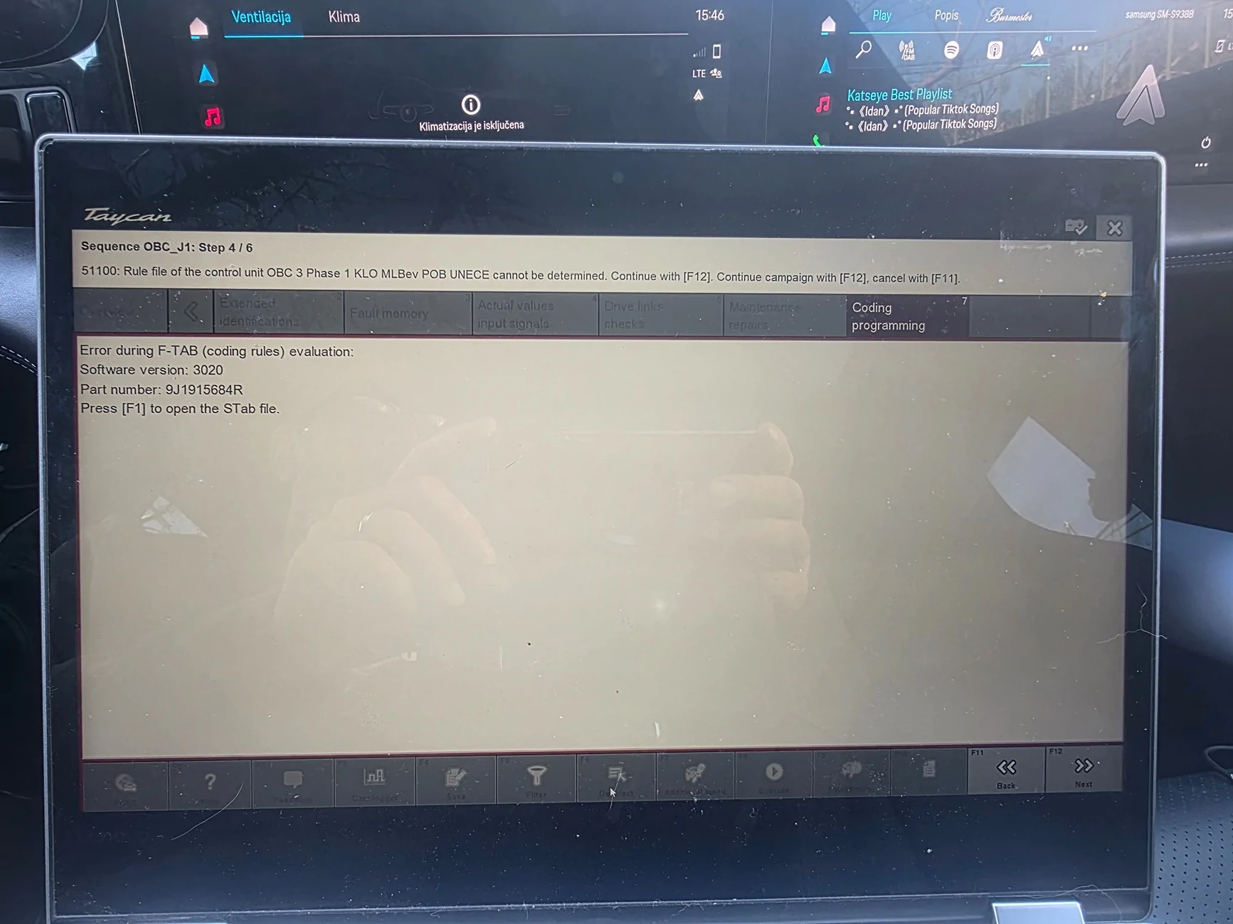

Hello boys and girls!I changed my 22kw obc for one 11kw obc from e tron gt.Unfortunately it want open both electricaly charging ports, I think because e tron gt hasn't had it (like I know it is mechanic) so I don't know how to make them work now.I try automatic coding and programing but it comes one error out.

I find the problem.It's from new e-tron which has new coding system.
