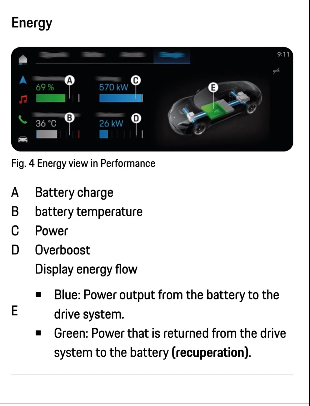

The J1.2 cars make not only more torque but actually a lot more power when the launch control is active vs when it's not.
The BMS has a higher limit in launch mode.
The launch mode is ~5 seconds from activation. So if you go from a standing start, by the time you're at 100mph or so you drop out of launch mode.
With our tune because the launch mode gets activated at the moment you push the pedal, then you can start it from a roll, as a result you have the boost through the whole 60-130 pull.
That's why it's faster.
On the quarter mile I expect absolutely no improvement whatsoever. The car is not limited in any way by the ASG in launch control stock. Just as the J1.1 Turbo S wasn't.
You would need to get in to the BMS to change that 5 second limit? If there was a way to get it to 10sec, that would effect the 1/4mile
