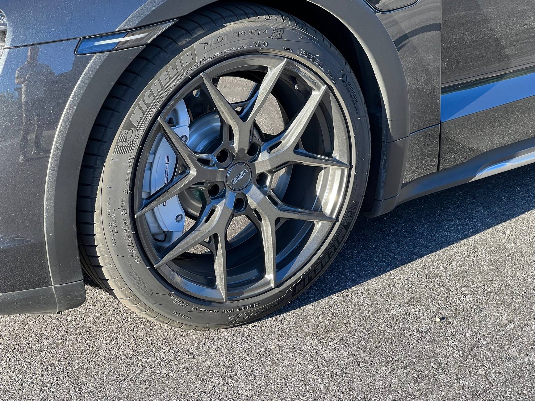

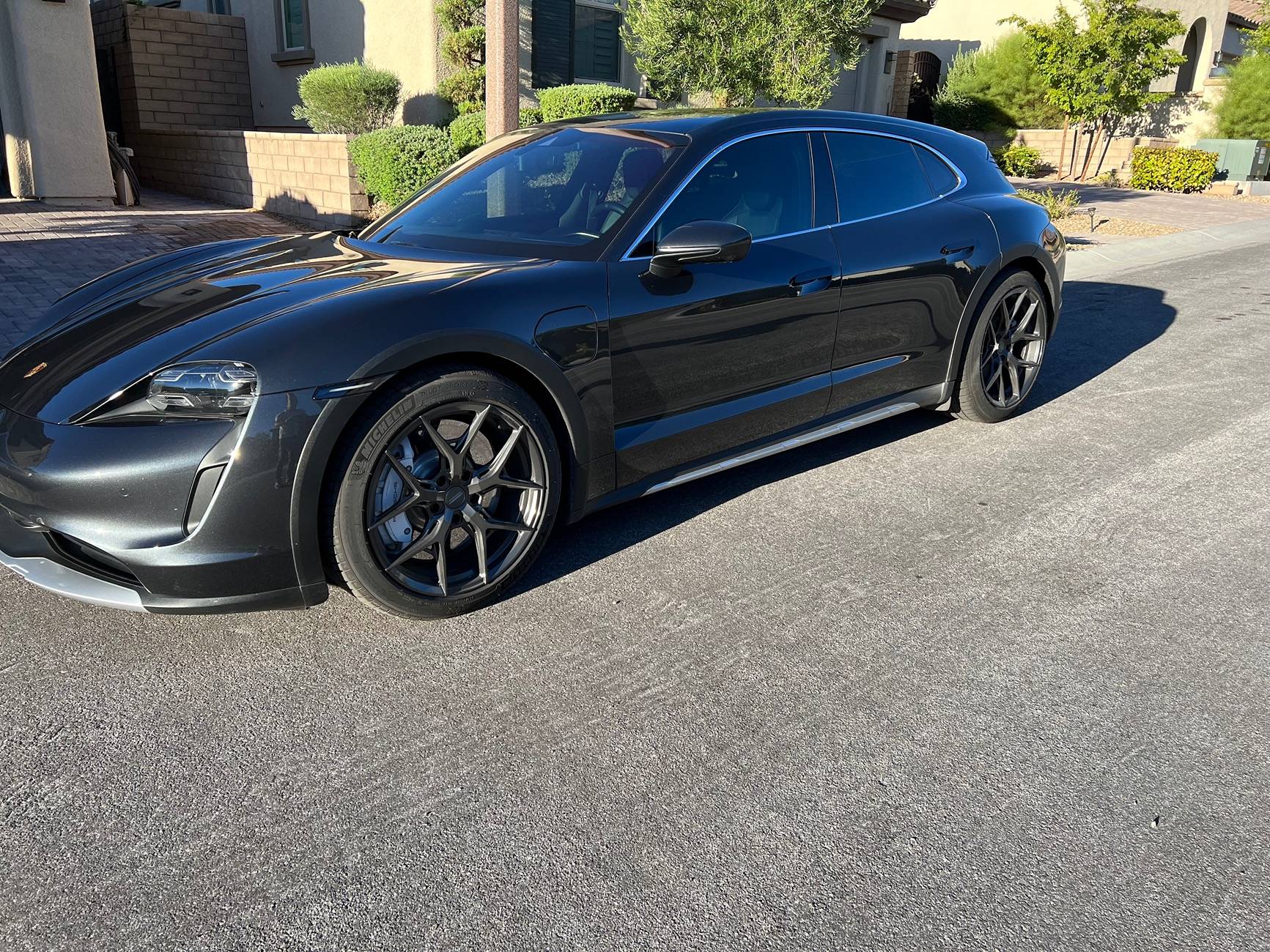

If you like the quietness and comfort of the 20 inches then stay there. If you don’t care about potential rim bent on pot holes and the disadvantages I mentioned above then 21 is for you.
Here are my 20 inches hf5 for reference. Yes they looks better on 21.
I think your tires compromise is good.
Thanks for the feedback.
I’m going to consider 20s as a compromise. I can still replace my current wheels with the Vossens, go with 20s v 21s, and not have to worry as much about potholes.
are you able to share the details on your Vossen setup (Eg. 255/40/20 x 9) for front and rear?
