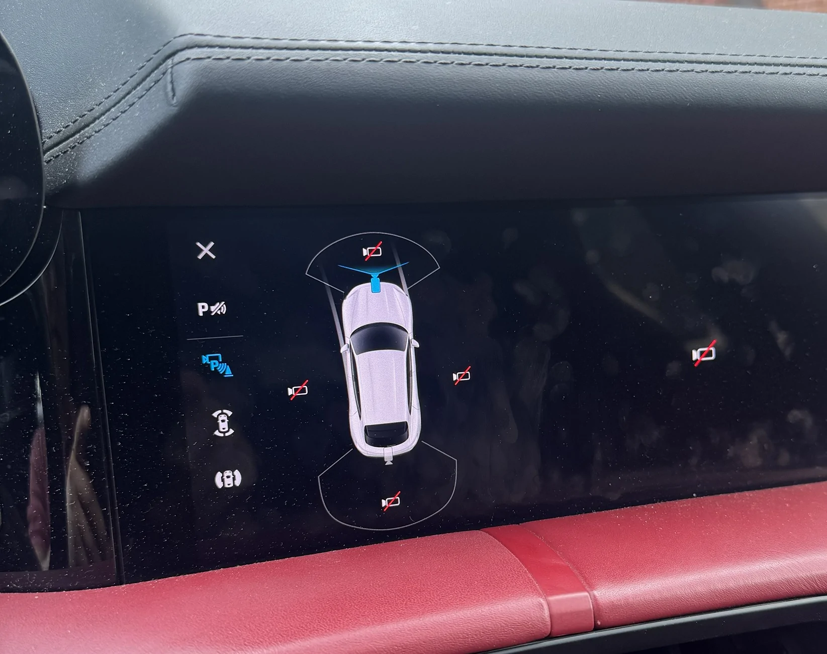

I have the 2020 Taycan. Did a reset/reboot of my.PCM system because it froze. It’s working properly now however, my reverse camera is not activated. Any suggestions on how I can reactivate when I’m in reverse?
kjones2400
May 29, 2026
I contacted the dealership and was advised that all recalls was completed when vehicle was in shop few months ago. The problem did not start till after the PCM reboot. Does any know how to reactive the camera?
https://www.taycanforum.com/forum/t...appear-on-the-display-asb2-dec-19-2025.32501/
https://www.reuters.com/business/au...-over-rearview-camera-image-issue-2025-12-31/
there are recalls and newer software for the cameras ECU
Your dealer is lying
The recall also states that if the issue persists, they are too replacing the camera hardware.

I'd suggest a hard reset by disconnecting the 12v for a while.
See if that helps, it worked on my 2020
