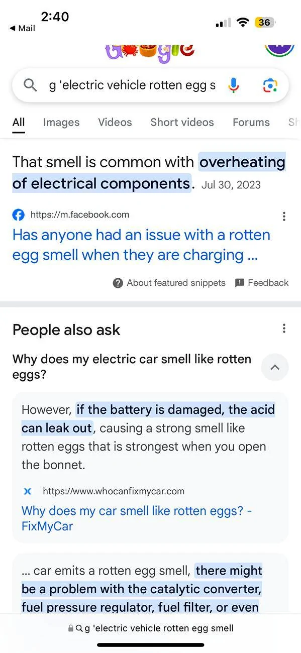

Suggest googling 'electric vehicle rotten egg smell'. A number of possibilities listed in search results.
You’re right… could be a battery leak. Yikes!

Surely can’t be the battery as they’re all lithium ion rather than lead acid ?

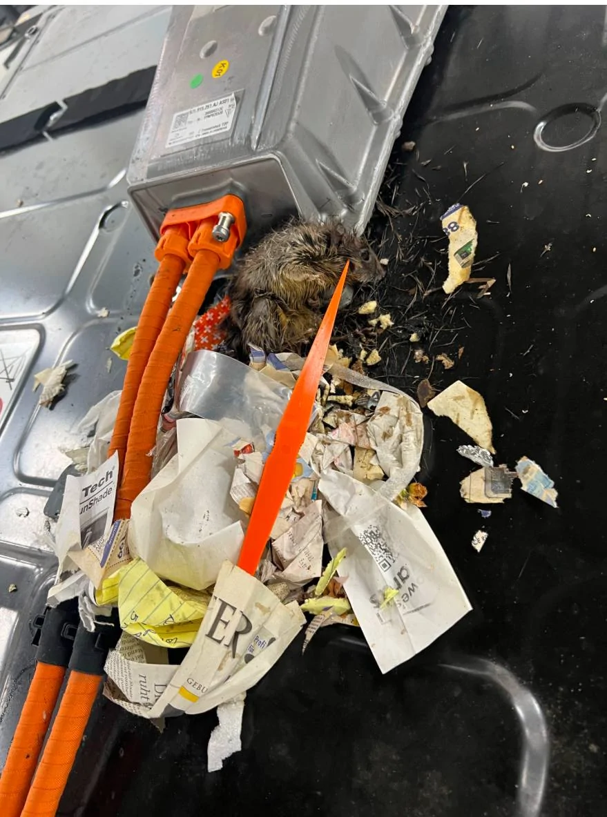

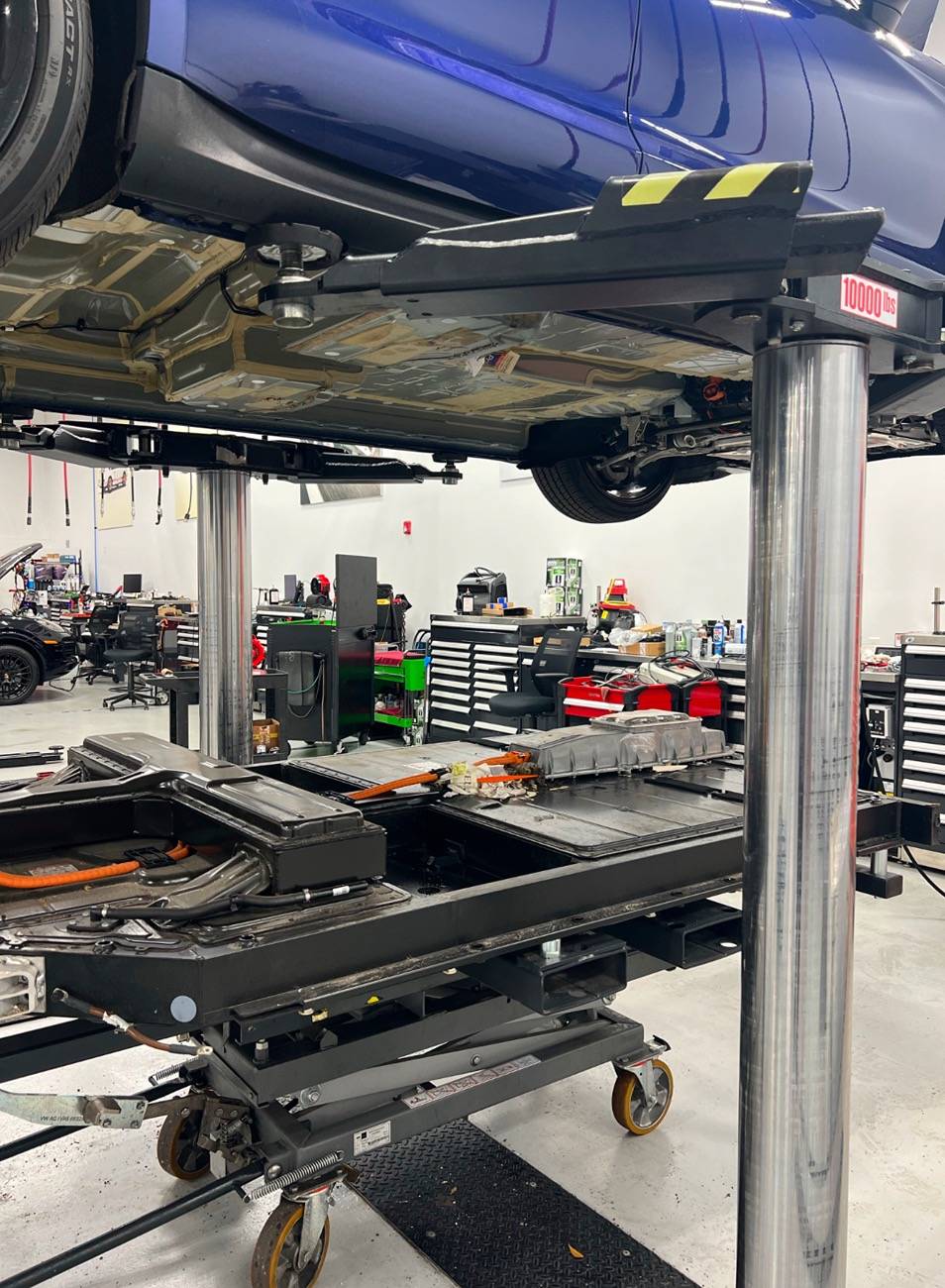

This happened to me, but it was more of a broccoli/cauliflower smell. Took it to the dealer and lo and behold
Wow. Hope I don't have that problem.
What did they charge you to drop the battery and sort it out?
Two questions: what is the animal? Is the car normally parked in garage or outside?
Total cost was $ 5,400. It was covered by my car insurer, luckily.
it was a rat, car is always garage parked, but went out one night and parked in the grass, so suspect he must have crawlde in. Luckily didnt chew on anything. That would have been even more expensive.
