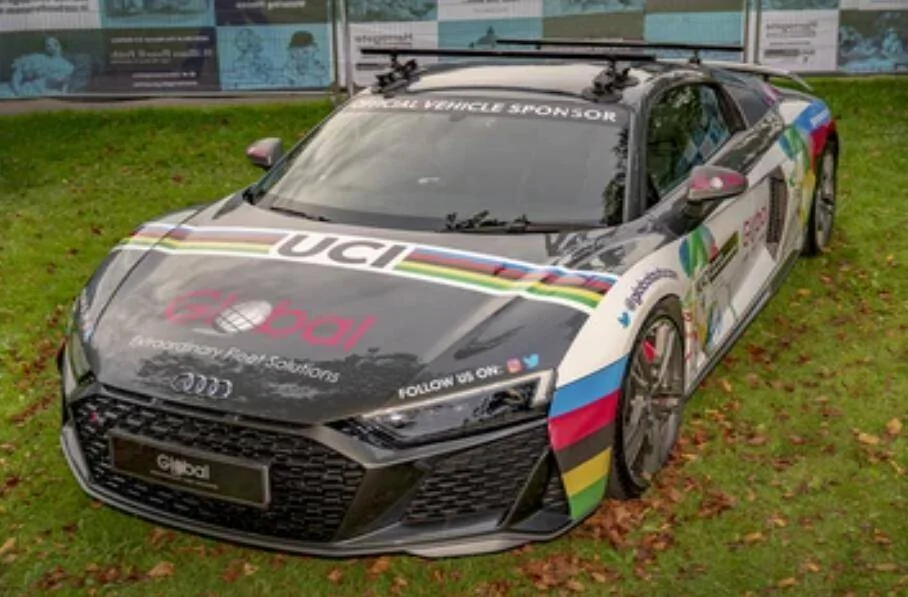

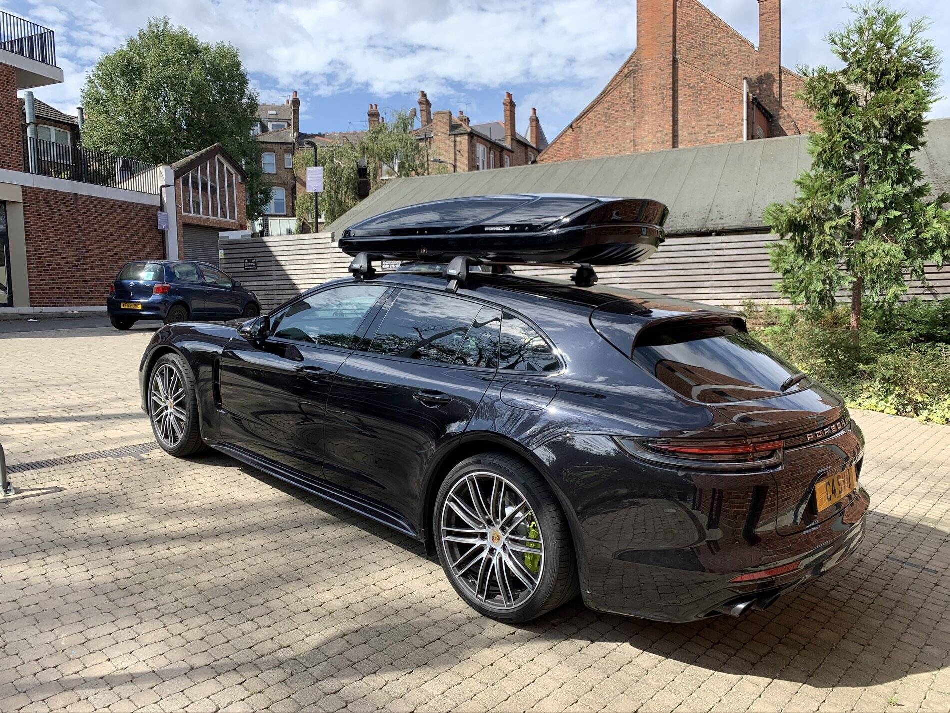

Hi All - just wondering what people’s thoughts are on skipping the roof rails and using a sea sucker on the pano roof??
I prefer the look without rails, but obviously can’t overlook the practicality of having them. It’s a shame there aren’t alternative mounting methods, like with the Macan where you can mount with or without rails...
I use a roof box on my Sport Turismo maybe twice a year, the beauty is the rest of the time the roof is unadorned.

The cross turismo has optional fore-aft roof rails on either side to mount cross bars, while the regular taycans bolt straight to the roof. Folks may be confusing the two here. Rails are required on the cross turismo if you want to use cross bars.
If you don’t care about locking your bikes to the roof/car, I’d say seasucker is a great option.

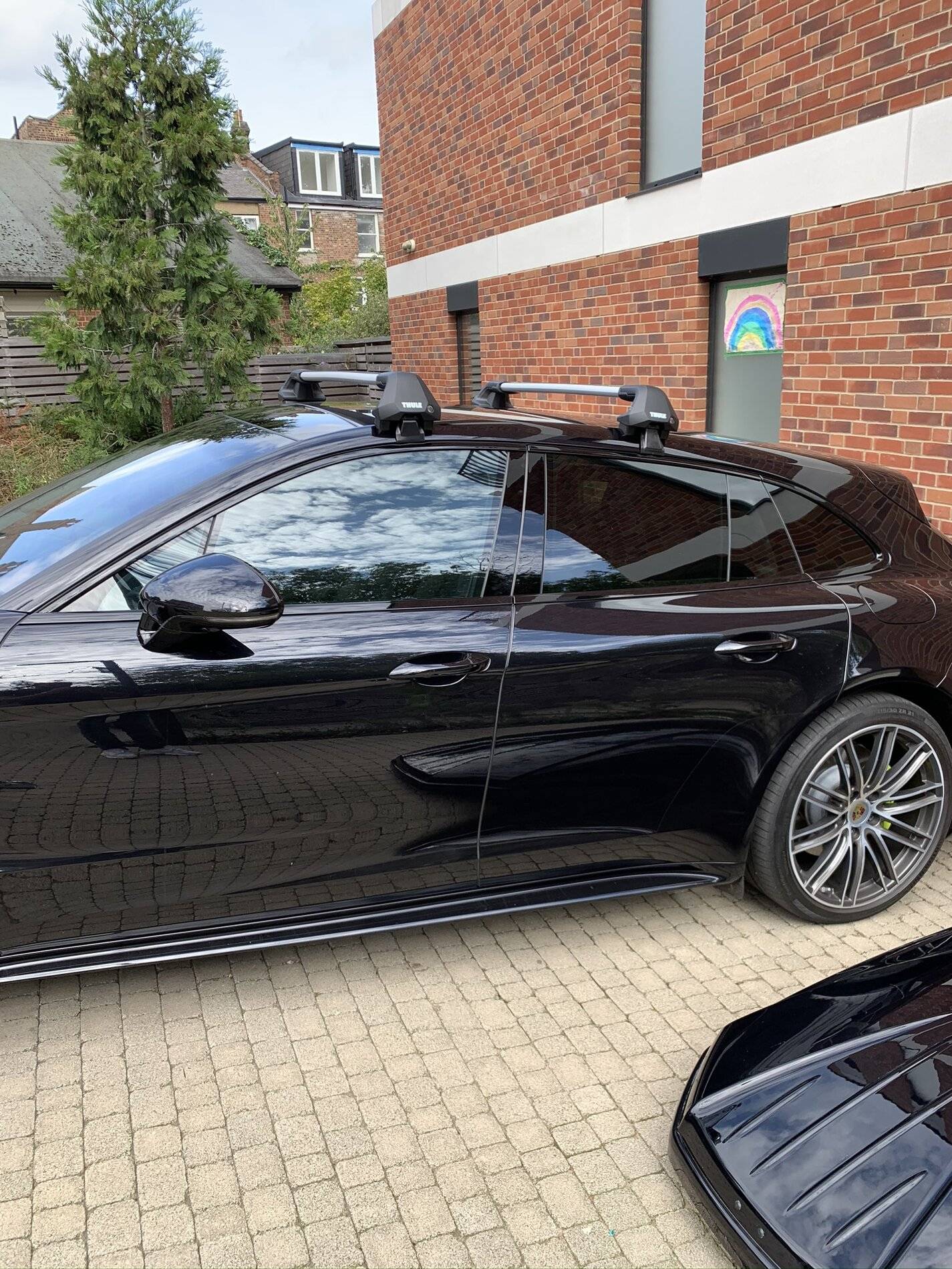

Can you clarify? The wife just got a Macan with no roof rails. Do you have a really good mounting system that good be used in a pinch?
I need to go down to Home Depot to pick up some lumber and she is not happy about that. I'm not going to put it on my Taycan.
With the macan without rails you can fit roof bars like in my Panamera pictures. There are mounting points in the door openings....I got the Thule bars..who supply Porsche anyway

reviving this old thread to give my two cents. I don’t know if it’s an issue with my sea sucker or pano roof. They don’t work on pano roof. Put it on last night and took it for a test drive. Wouldn’t stay on more than few minutes at the time. The front rail kept losing suction, had to park on the side of the highway and take it off. I think it’s because the glass is too slippery, in my previous cars, the front rail was usually suctioned to metal not the glass roof and didn’t have an issue.
