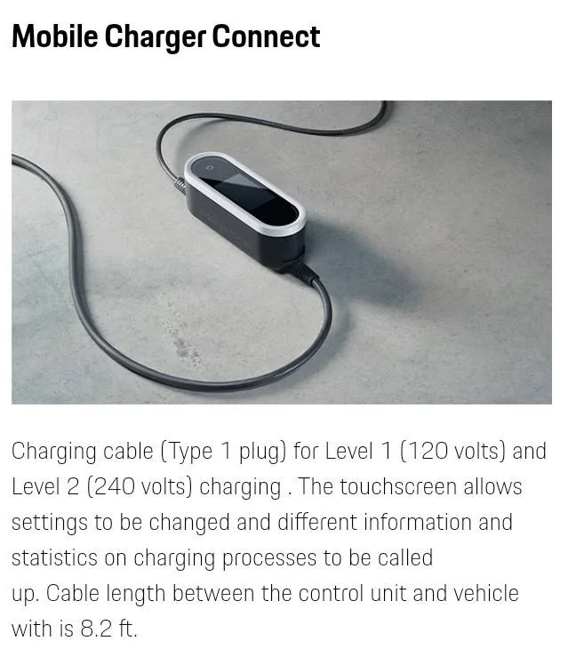

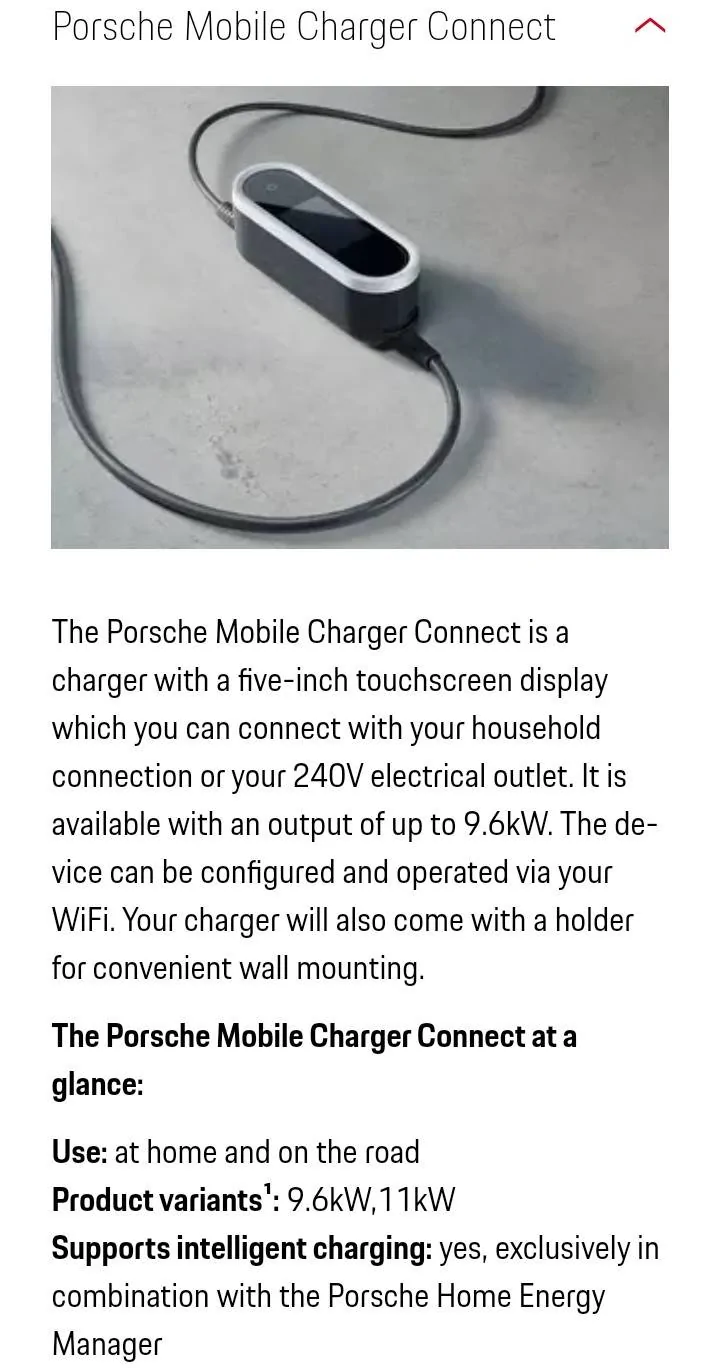

@Dave T Mobile Charger Connect is the portable or wall mountable EVSE that we in USA are required to configure at this time (like pano roof).
At first I was a little annoyed to be forced to get their $1100 charger but it is a 40A (11kW) charger and WiFi connecting so has several nice features. All current owners seem to say nice things about it so I'm now happy.
The default cable length is 8.2ft, see more under E-Mobility in configurator.

So all you need is the “mobile charger connect” (and a 50 amp outlet to plug it in to)? Why do you need 50 amps if the charger only uses 40? And what are the “supply cables” for? I don’t have one of those specified in my build. I do have the 25 foot charger cable though. What would I use that for?
ron_b
Ron
Dec 30, 2019
327
1,587
1,678
SF Bay Area, USA
Yes, all you need to install is a 50 amp circuit and plug where you wish to place the charger. The charger has a very short cord like two feet to plug into that. The 25 ft cord will go from the charger mounted on the wall over to the car.
Circuit must be rated at only 80% of continuous load. See https://en.m.wikipedia.org/wiki/National_Electrical_Code
