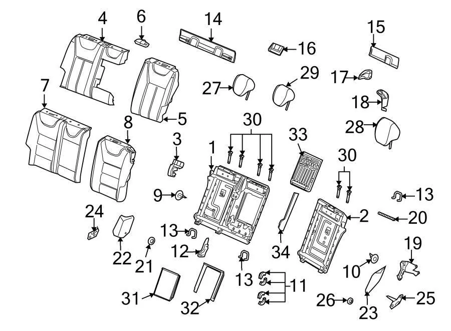

I'm working out a spec for a 4S to hopefully nail down and order this week, and just want to check something I was told by the sales person on a test drive yesterday. If you spec the ski bag does it come with a hatch behind the rear seat armrest to post your skis through?
My preference would be to get the 2 rear seat version rather than the 2+1, but as I live in Switzerland it's pretty critical that I can get skis in. A ski hatch would be perfect if I don't have the 40 : 20 : 40 split.

Thanks - yeah I understand that, 2+1 gives the 40:20:40, 2 seats gets just 60:40.
The sales person told me that if you spec the ski bag the "60" split comes with a little hatch in it to post your skis through.
Is that correct? I can't find any reference to it - if you or anyone has the ski bag can you advise? Obviously a different Porsche but in the parts diagram below the ski bag is no.33, and the skis can be posted through seat back (no.1) via the hatch / armrest (31/32).

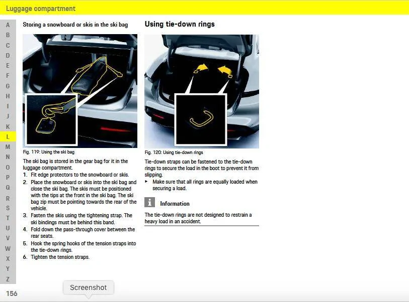

I got the ski bag and there is no pass through unless you get the third back seat.... so that hopefully answers your question

I don't have a Taycan yet (still researching), but I found this in the user manual I found somewhere on the web. I think this confirms 2+1 required to get the solution you desire.
Hope that adds a bit more comfort to the decision.
