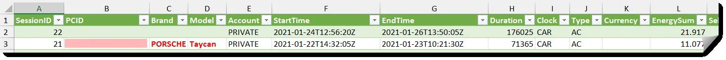

anyway, I already exported the file, basically even yesterday I connected the car the first time and was recognised as Taycan and I can find it on the csv/pdf... used the car and when I started charging again the display recognised as Taycan but on the csv/pdf is not..
Yep, PMCC.
The last export I took had both PCID (similar in format to your VIN but not a VIN per se) and columns ''Brand' and 'Model'. Mine says 'Porsche' and 'Taycan' but not always populated per entry. Perhaps dump the entire data set and you might get some example where these values are populated. I have security enabled (PIN) but auto authorisation for my specific car - perhaps this will help also.

Even in your case, at the end of the list, you should have 2 totals, 1 for the rows with your car and 1 without it.
if you have only the Porsche it’s not a problem with the total, but if you recharge another EV, that will be recognised with an empty row and when the Porsche is not recognised, it’ll be an empty row as well!
I only have 1 EV but remember there will be another PCID & Model listed for another vehicle which may not appear each and every time but you only need it once and then match that to the periods you are charging that particular vehicle.

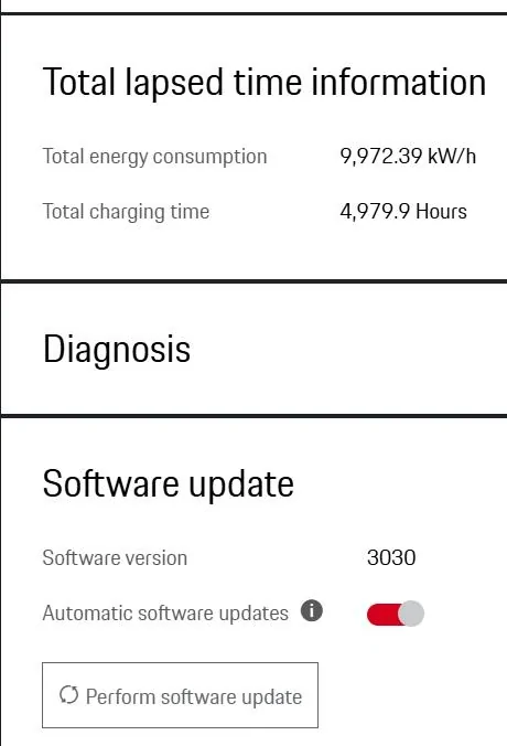

....I looked just now and every single session has the correct PCID, Brand and Model so clearly something has changed (for me).
I've had 2 Taycan's and my current (new from Nov'23) shows a different PCID and 100% rate of recording all details. Either the software patches have helped and / or MY23 Taycan's did a better job of data exchange.
Software version 3030
