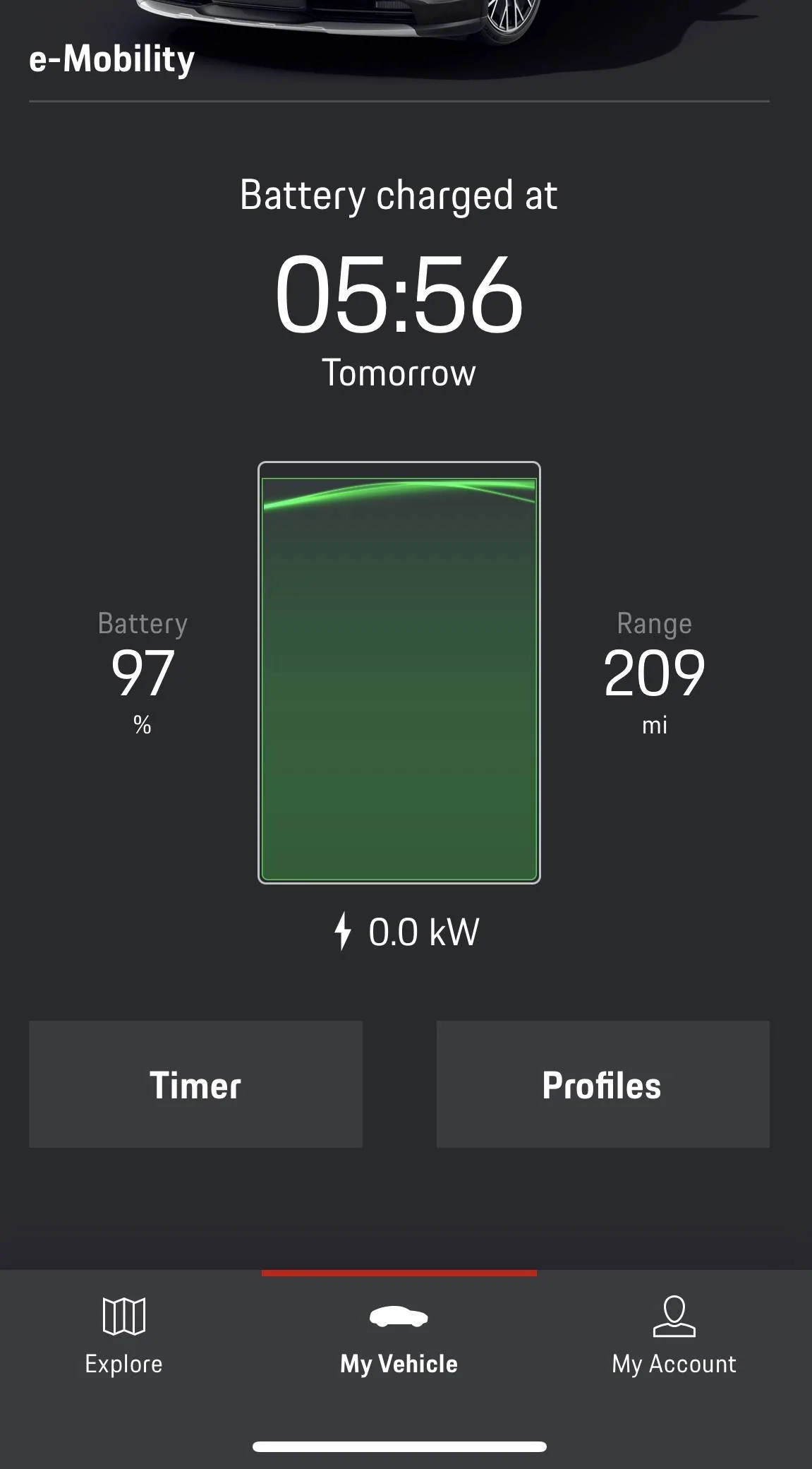

My CT 4 seems to only charge to 97% on a 7kW charger.
Charging slows to 2kW, then seems to stop. Anyone know what could be causing this? Sometimes I need the extra 3%...!

Your car is still charging based on the picture - albeit at a very low level (close to 0.0 kW). In fact it predicts your battery will be fully charged at 05:56 tomorrow. If the car stopped charging, the battery display would be white-ish instead of green.
I remember the Tesla had a lot of cell buffering to do at the top end, and it took quite a while to reach 100%. Could it be that the new Porsche software has much less buffer at the top end - and charging must be slower?
Try to wait and see if it ever hits 100%.
Also, if you have a predictable departure time you should use it - it pre-heats your car and battery for optimal driving at set time. That will make it comfortable - and increase your range.

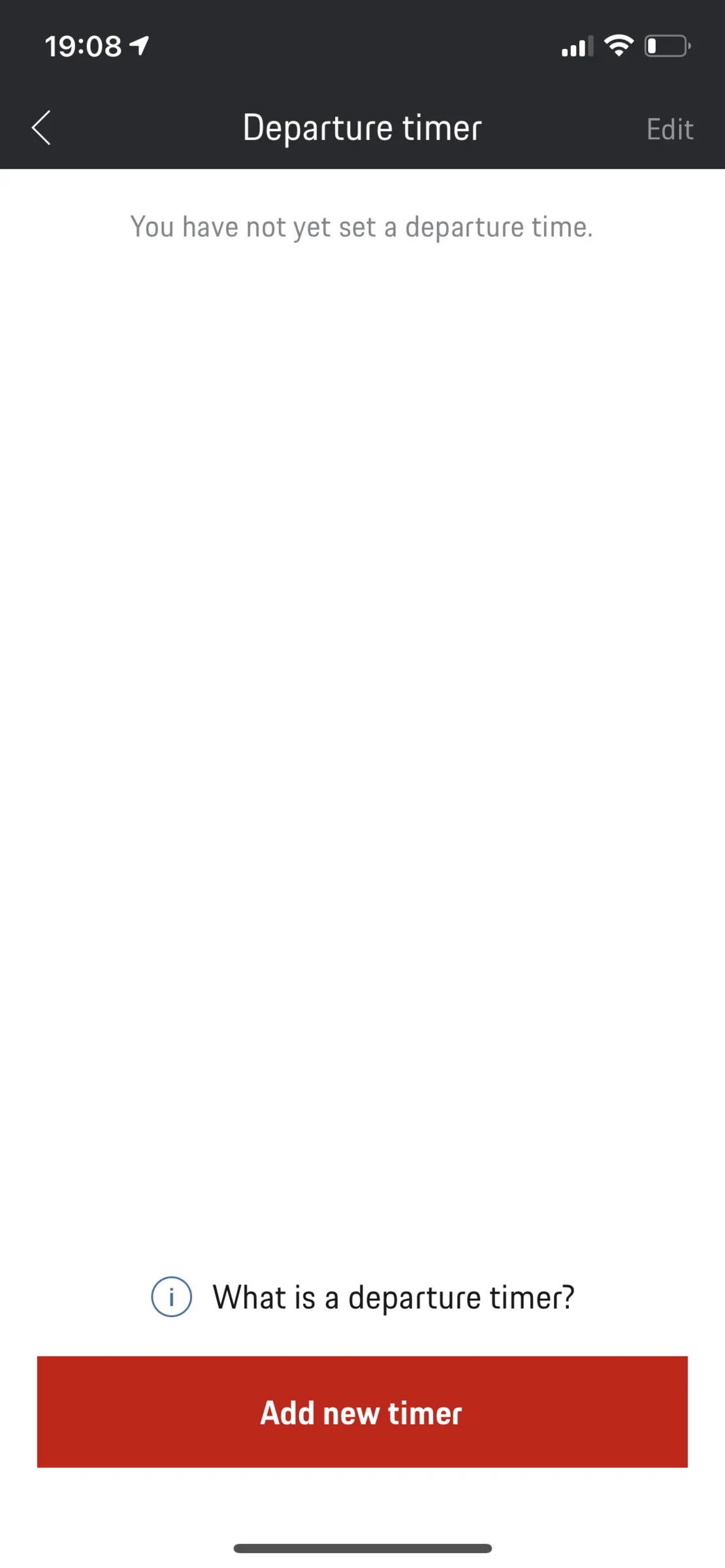

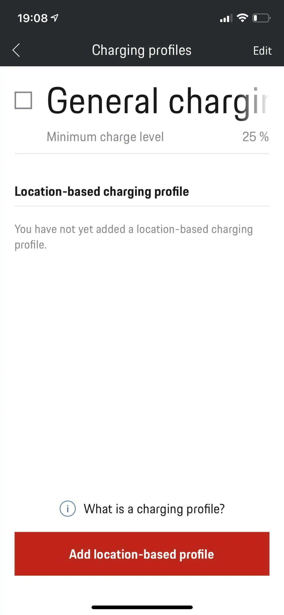

Thanks, I don’t have any set
Ok so set a timer and a profile.
Profile should be set to your home location and set the minimum charge to 25% and a preferred charging window of 00:00 to 07:00.
Set a timer (daily or whatever) with a departure time of 07:00. Set the target charge to 100%. Typically you only want to charge to 85% on a daily basis but for this test set to 100%.
The car should comfortably charge from a State of Charge (SOC) 30% to 100% during the allotted window above. 0% to 100% might be challenge in 7 hrs. 14% to 85% no sweat.

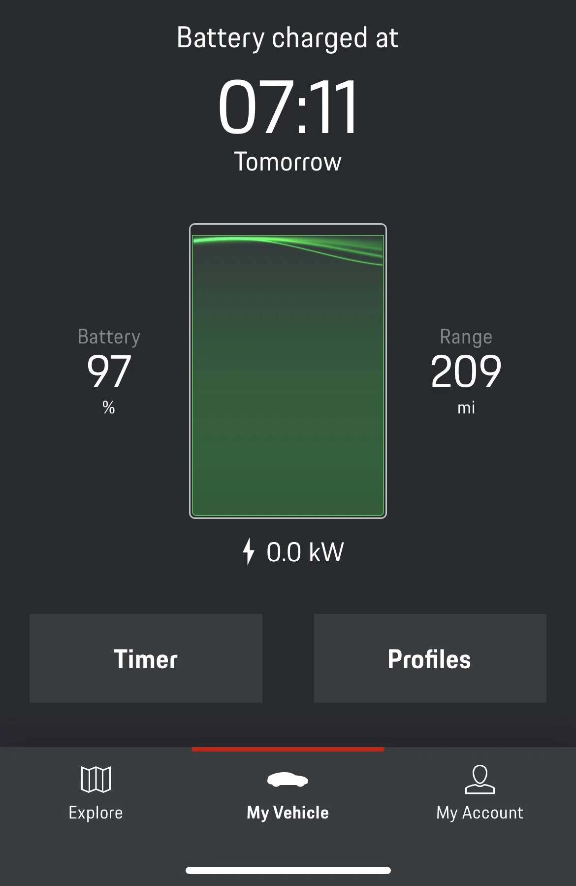

Thanks - but it’s been on 24 hours now, the time just keeps extending out (see attached).
We are backto Working from home in the UK again, so no predictable times at all! But I do manually preheat using the app.

That's because you have no end time set - follow my last post.

surly though with no profile or timers it should charge to 100%? I have set the timers and profiles like your suggested, so now it’s ‘paused’. I did press the ‘Direct Charging’ option, and it went green - and to 0kW again. If it does not charge by morning I will try another charger.

I think the absence of a timer let's the car effectively trickle to 100% as there is no 'must be ready by' condition.
Blue is good - paused and will have calculated when it needs to start charging to complete the 100% request within your preferred charging times.
