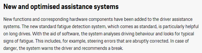

J1.2 supposedly does more, because they all have PR code "EM2", which is Advanced driver attention & drowsiness monitor.
J1.1 do not have this PR code.
Excerpt from Porsche PR for J1.2:
Porsche Taycan "Take over steering" message - anyone else get those without ADAS engaged? fatigue

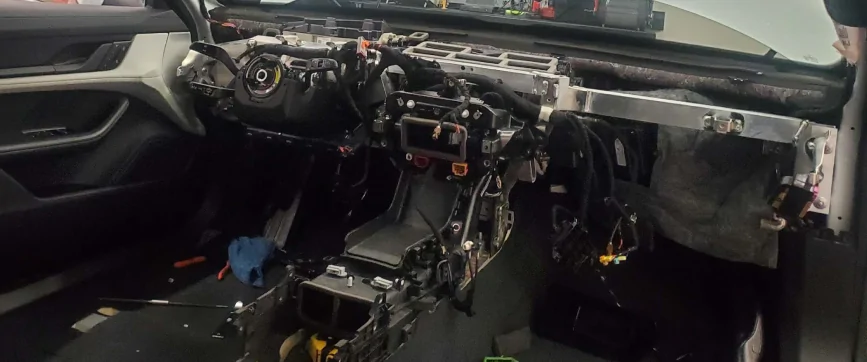

The more advanced system is the "EM3" - Driver alert system with driver monitoring. This should be the one with the camera on the steering column. It was supposed to be fitted from week 48 2025, but got pushed back to week 10 2026.
