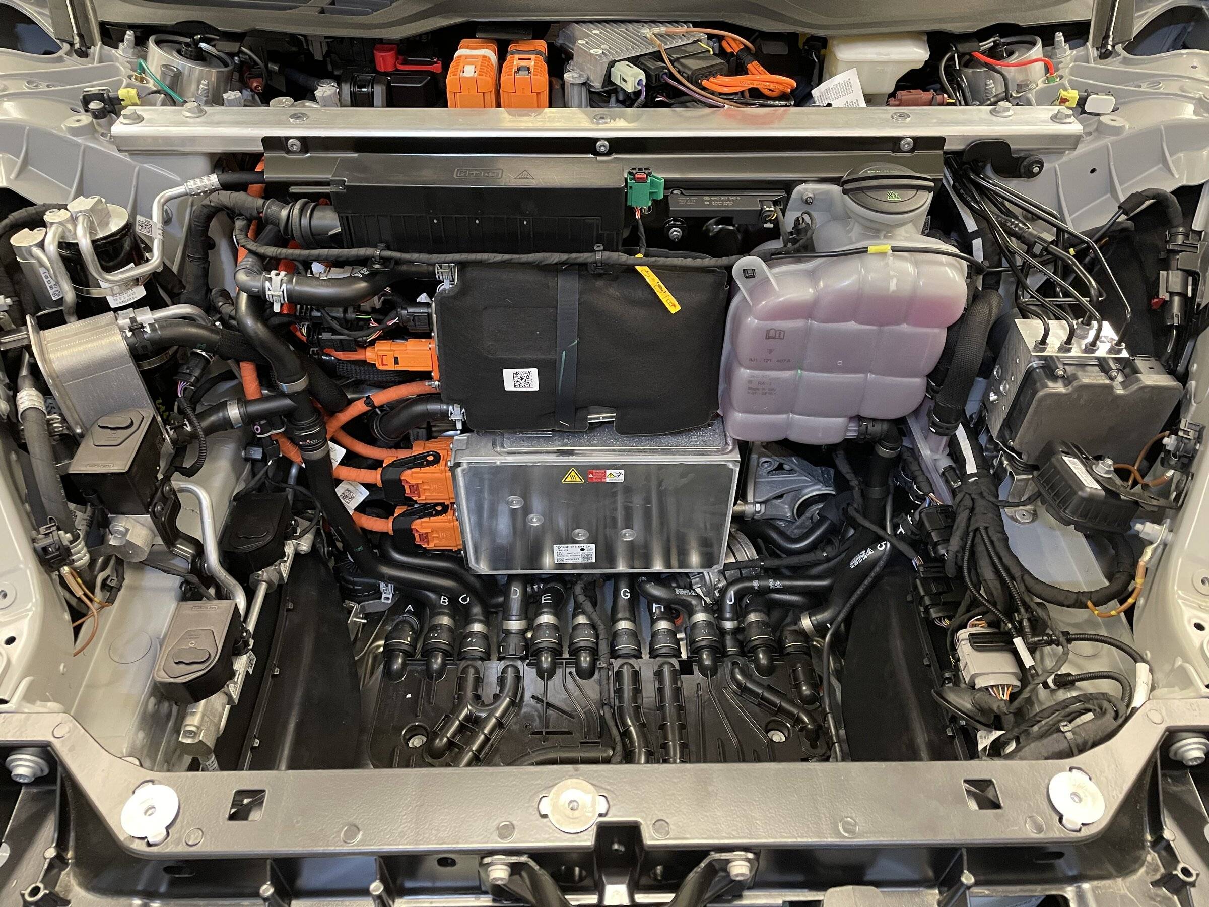

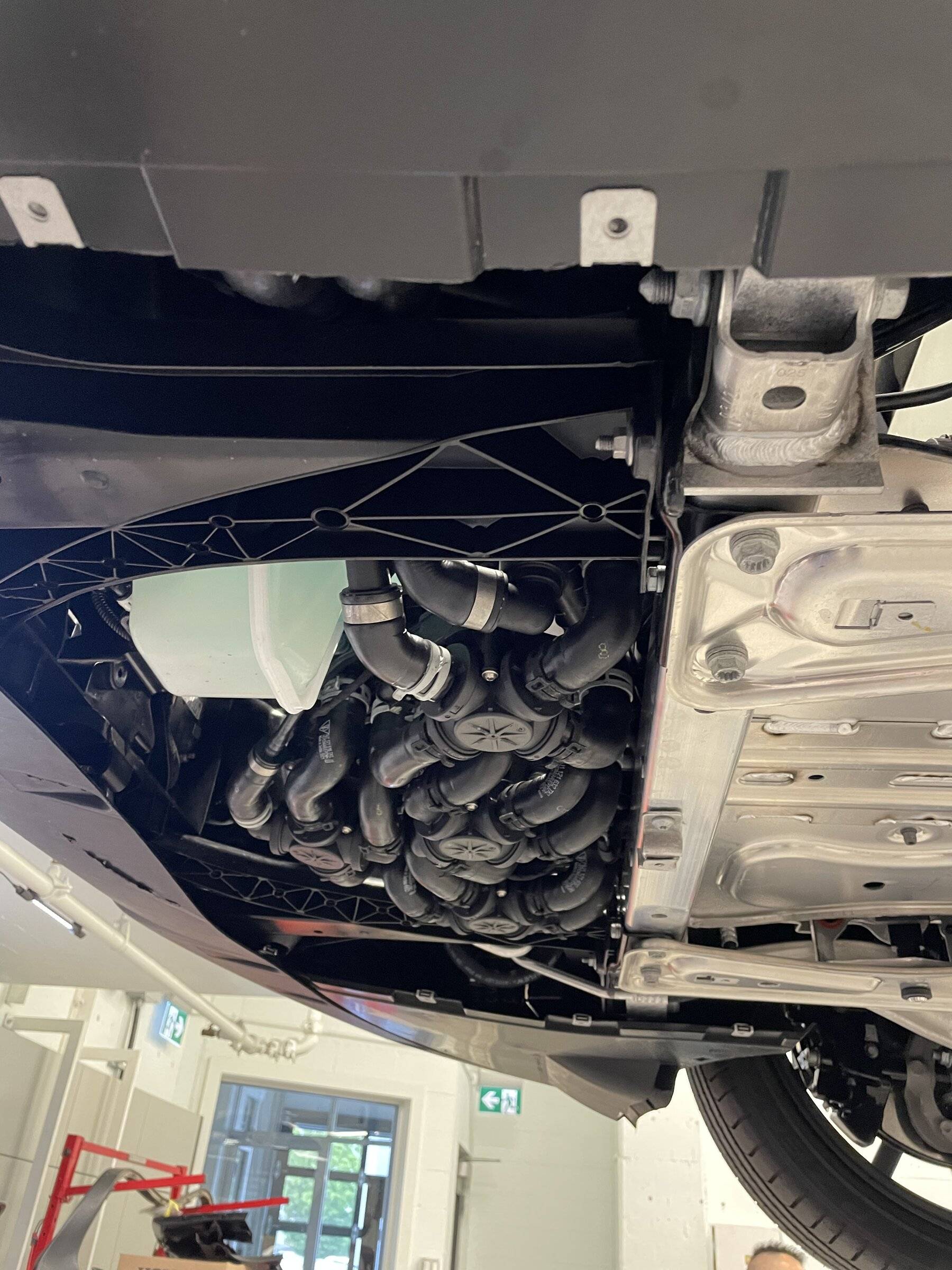

Here’s a couple of pics showing the intricate coolant system arrangement with the “Frunk” and underbody covers off. Certainly want to make sure this area is protected and looked after ?.
