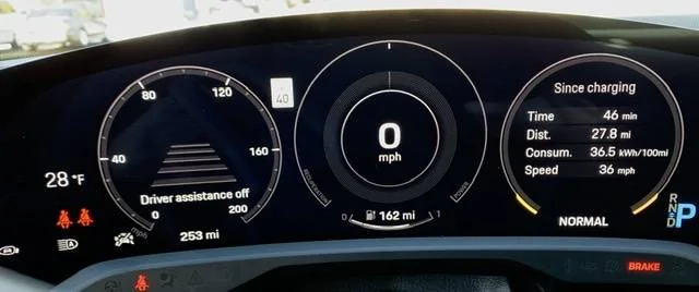

So under PROTEST I actually drove today in range mode and driving a little cautiously to get a sense of what the real range would be for the car. A few caveats are:
1) This a Turbo S with less efficient wheels/tires (larger)
2) The temperature here was around 25F so cold outside, but car was in a conditioned garage and I pre-conditioned for departure time
3) I have a lot of experience how to drive for range, but I wasn’t really driving for maximum range rather driving what I’d call “boring”
4) I drove in Range mode and not aggressively (But not really doing everything I could for range).
I drove the same road I know vey well with various cars. The brief version: the car was relatively efficient, I achieved 2.7 miles/KWHr (I could probably get a little over 3-3.1 with the Bolt, 2.5 with the i8 (FWD), and maybe 2.5 with I Pace Eco In these conditions). Mixed driving (Highway at 65, roads varying from 35-55). I had the heat on at 72 for the entire trip. Numbers are:
28 miles, 36.5 kWH/100mi, 36 mph average. If the numbers held at 100% charge I would get around 220 miles and at 85% around 193. Considering these are not great conditions for EVs (cold out, high air density) this is a LOT better than I would have guessed I could have gotten from the car. It is quite efficient and if this is true they are rating the EPA range based on not driving for range and/or at higher speeds. Right now I am impressed.
Porsche Taycan Owner Discusses Taycan Range, Battery Longevity, Charging and Related Concerns 30C98BAF-B3A1-449D-B967-B6BF3F50784C

Thank you for the torture @epirali in the name of science.
We future owners really appreciate it. ☺
I know that I do.
